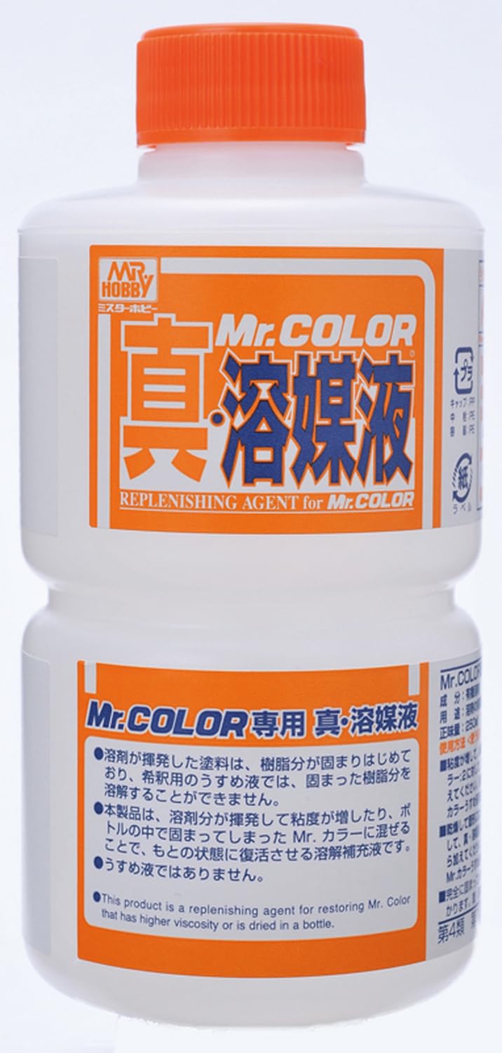

Solvents in lacquer paints eventually evaporate. Rather than the thinner, use their replenishing agent to restore them. I also keep my excess paints in a closed container to help their longevity, but I go through my lacquers fairly quickly.
