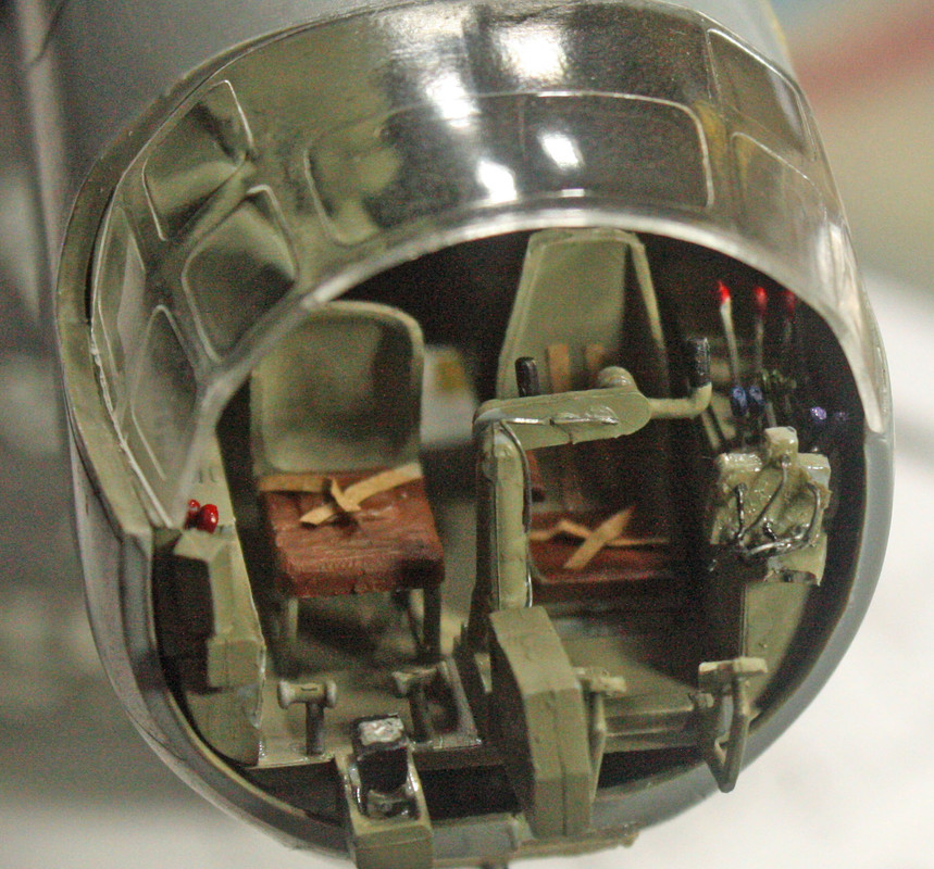

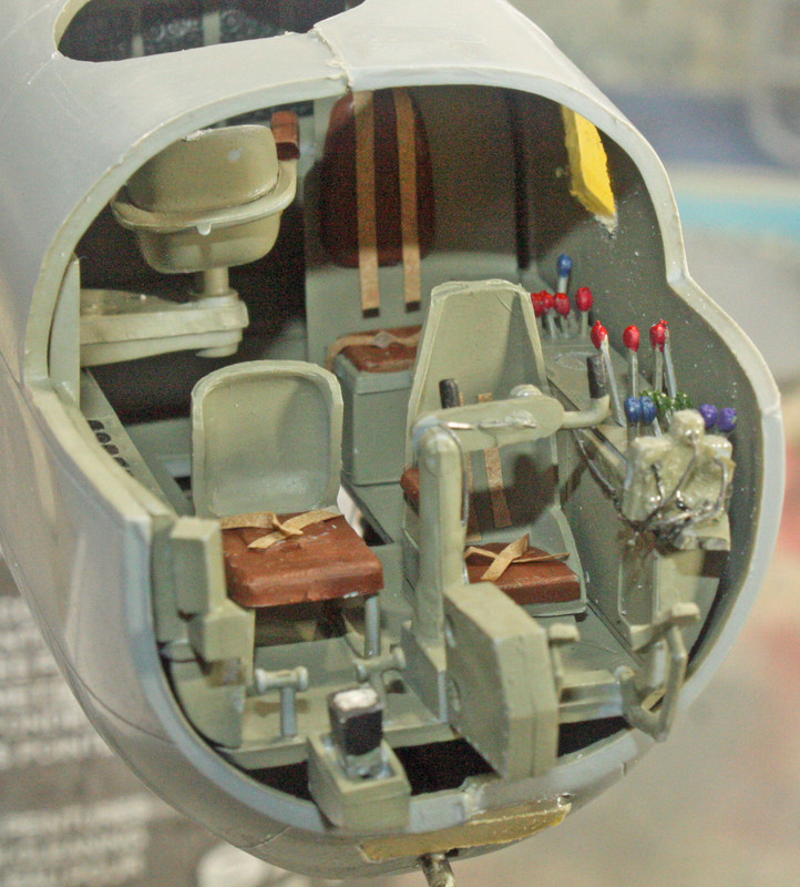

So construction has begun in the cockpit. I started by putting down a coat of RLM 02 Grau on all the interior surfaces and parts. I know that at some point the Luftwaffe switched their standards for their aircraft interiors, opting for the darker RLM 66 dunkelgrau, but I’ve taken a bit of artistic license here by using the RLM 02. My reasoning is that the lighter grey paint will allow for better visibility of the cockpit parts and the various dials and levers than would the RLM 66. As for this particular aircraft, I don’t know when it would have rolled out of Heinkel’s factory, but I am doing a bomber that belonged to 6/KG 100 out of Toulouse-Blagnac, 1944, so it’s likely this one would have featured the darker interior.
The kit does not come with seatbelts, so I used my standard brown grocery paper bag to fashion belts for the 4 seats included in the cockpit. I wired the rear of the tiny IP and ran the wire along the console to the rear of the cockpit, and I added a wire to the backside of the control column.

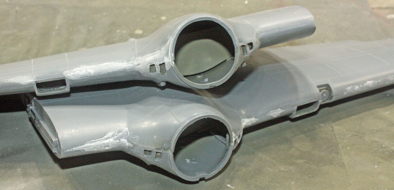

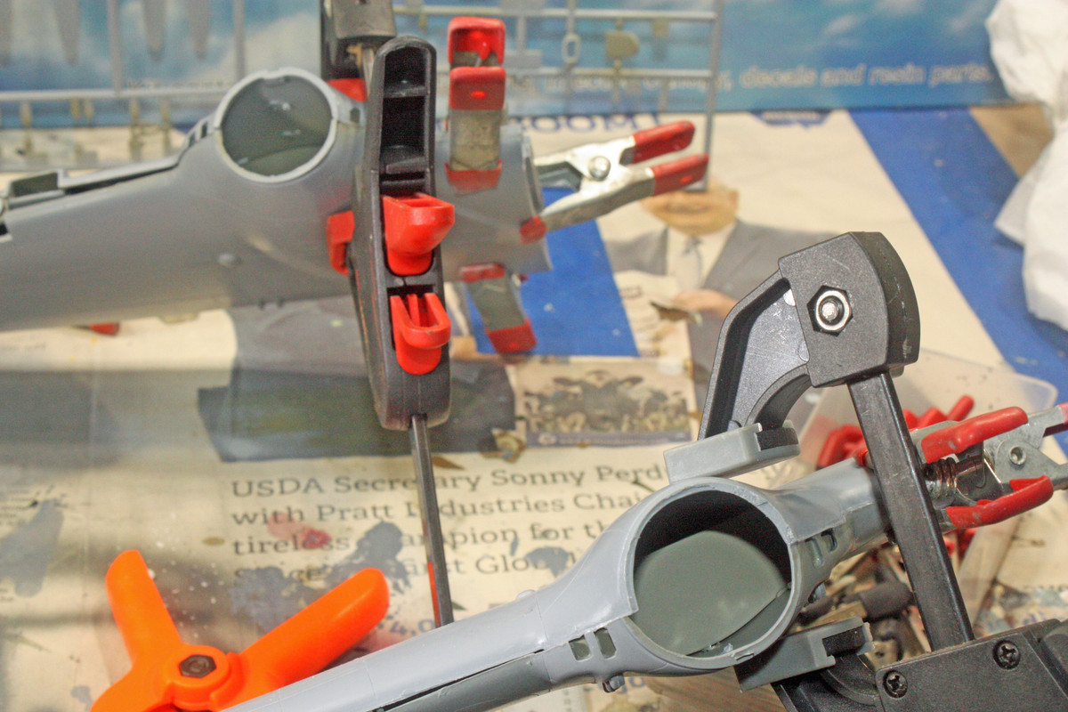

This kit has some lovely fit issues. Even when one gets parts together as snug as they will go, there remains awful gaps and huge seams that will have to be dealt with. The wings are the worst for this; they don’t seem to be well-molded with the intent that they actually belong together. The stub used to attach each wing to the fuselage is (a) garbage and (b) insufficient to the task for which they were designed. Chad, your suggestion is definitely a good one, but given my budgetary constraints, I engineered my own wing spars out of styrene bars that I had on hand.

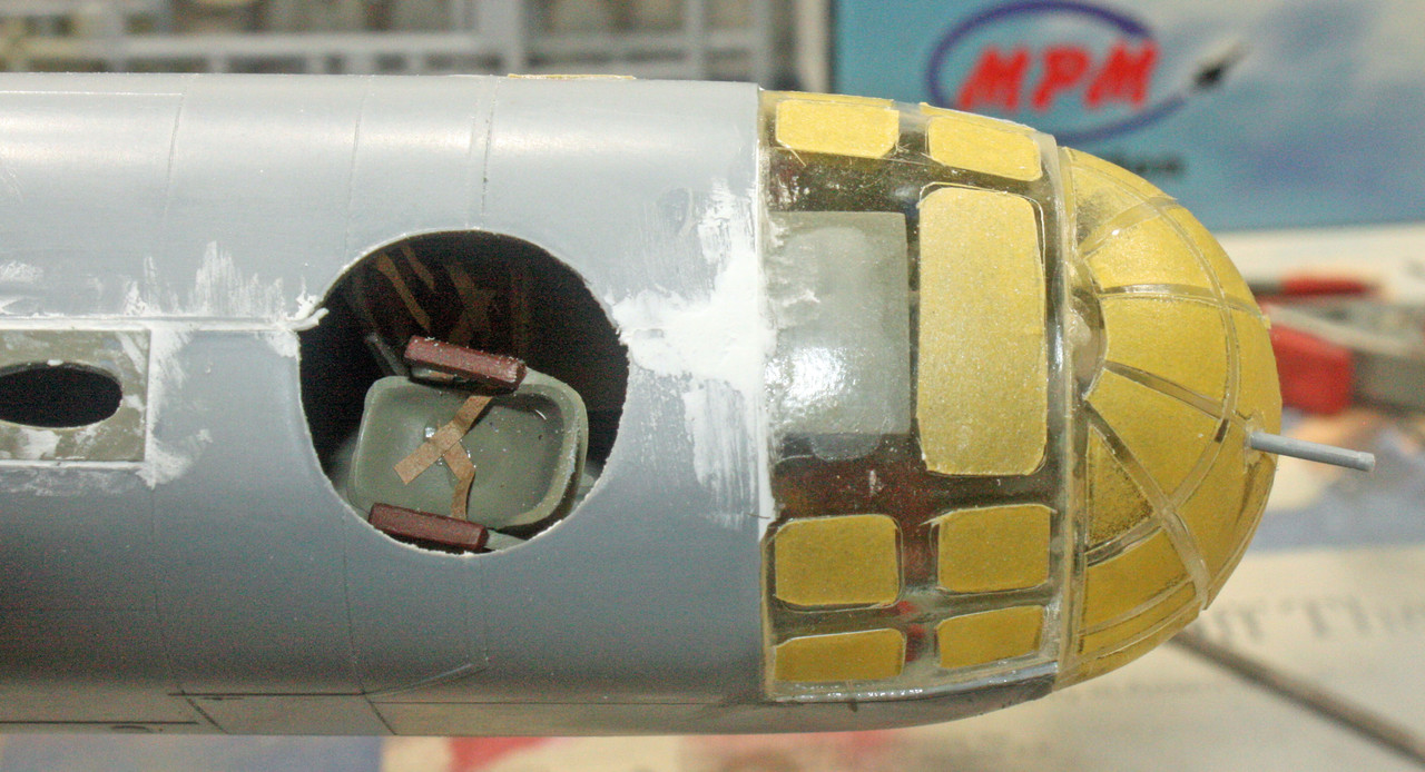

The other awful fit is the canopy. I have thus far simply placed it into position, and it is as if the part was never test-fit during kit development. I’ll try to first “stretch” the part under some hot water to get it into a more passable fit, but right out of the box, this is the worst I have ever seen for any similar parts (worse that Monogram’s B-29 or even Special Hobby’s Me 264).

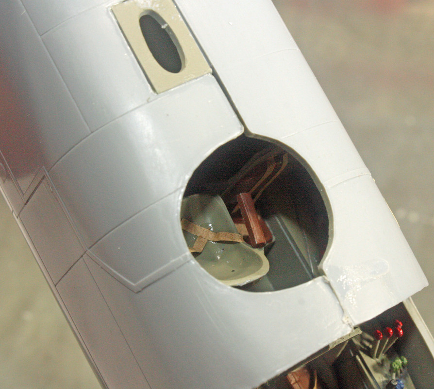

Cockpit and the canopy

Wings and wing spar
From here I will continue to get the wings together. That’s going to be a slow process to get the best fit and alignment as the parts will allow. And I’ll start to work on the canopy.

An update: I managed to wrangle the wings together without any problems, and I was quite surprised that I ended up not having to do anything radical to get the canopy into position. I did have to put on my patience hat, however, for all of this.
For the canopy, I initially glued one side to the fuselage, no glue following along the rear part that follows the curvature of the fuselage. I let that sit for a few hours, then returned and glued the opposite side, again nothing along the rear of the part, and held it until the glue set. After that it was an easy effort to get the rear flush with the fuselage (well, almost flush).

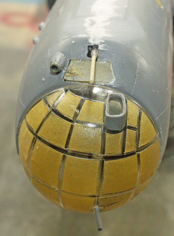

I have attached all the necessary clear parts, including the big curved windscreen, with all the masking in place. And I have started on the laborious seam work for this beast. I scraped and sanded a bunch, then have put down a coat of putty. Since my photos I have done an initial sanding job on the dried putty, but more of that is to come. Still more to come, also, when I get to attaching the wings and stabilizers.

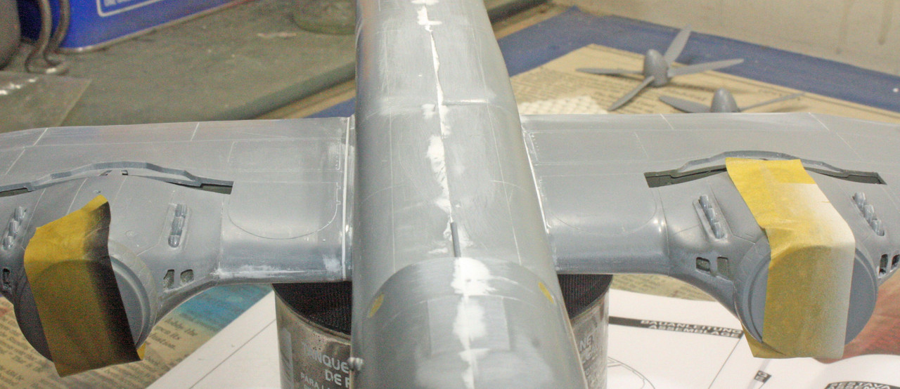

Moving right along … Both wings and stabilizers are in place and I have filled the seams. Fit wasn’t terrible in these areas as the curves of the wings lined up with the fillets pretty well. The gaps were easily filled with Perfect Plastic Putty.

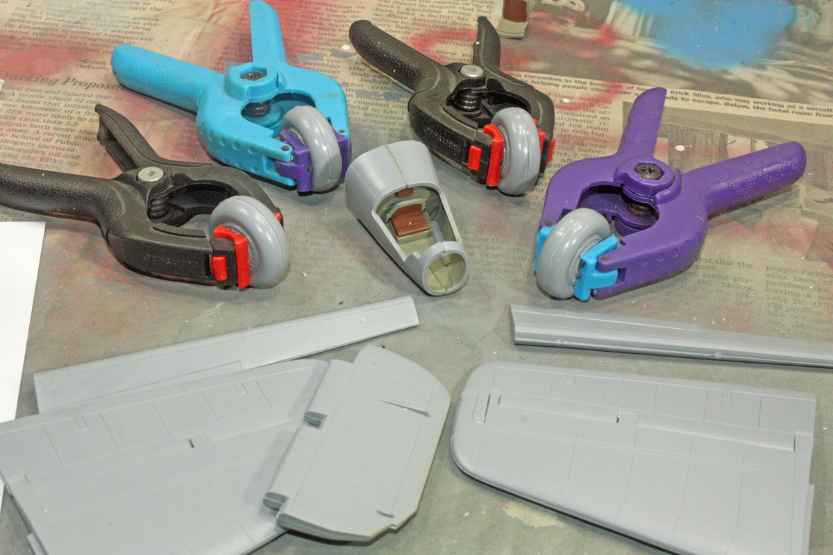

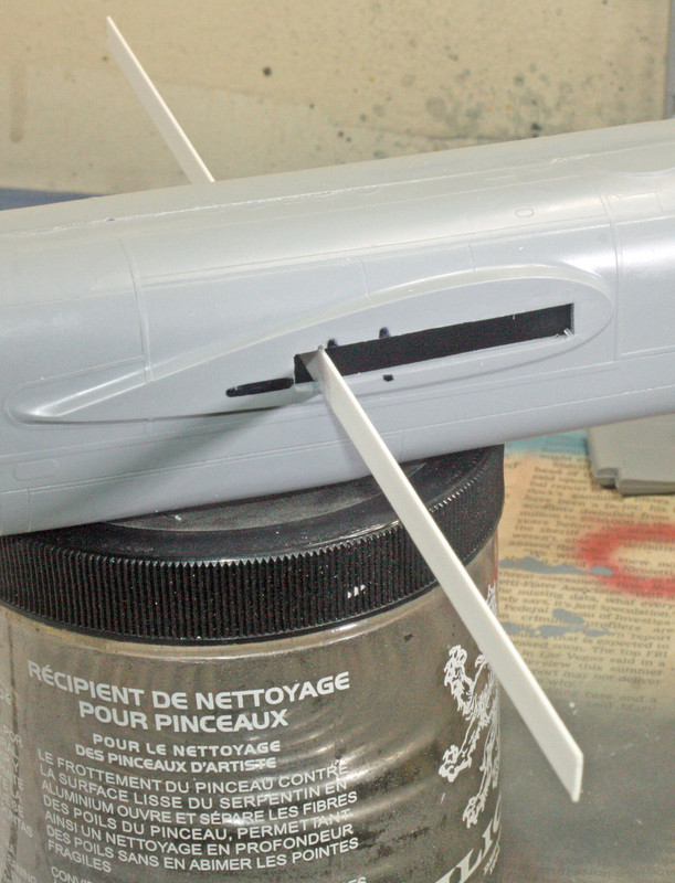

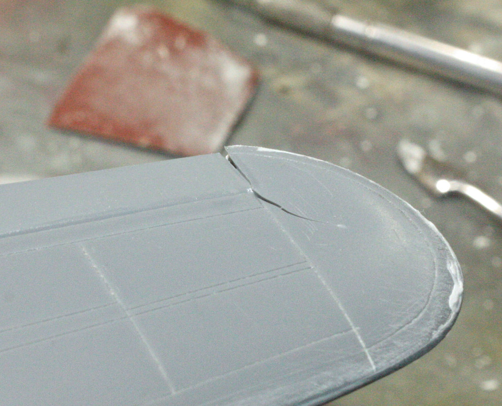

I added the rudder, a very tight fit, and the ailerons, one of which was a too tight fit that actually broke the surrounding plastic of the wing tip. I sanded the aileron down a bit, repaired the crack in the wing plastic, and was able to fit the aileron in without any further problems.

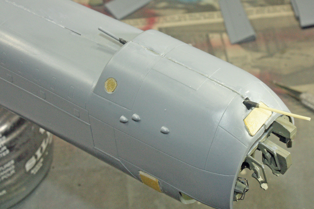

I have a good bit of sanding ahead of me with the progressively finer sanding pads to try to knock down all these scratches along the fuselage seams. Then on to a prime coat. I am going to do something I’ve never done with this build, which is to do a “black base” coat. If I understand the process, I will cover the entire airframe in splotchy black that will result in, hopefully, a paint job that will appear well worn.

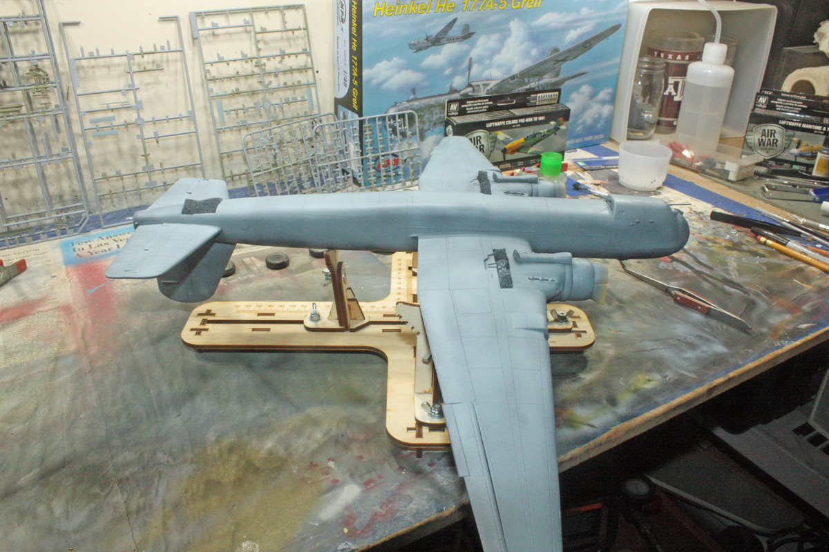

I’ve moved on to the painting stage. Yesterday, I started painting by putting down a coat of Grey Stynylrez primer, and after that dried sufficiently, I did my first attempt at black basing. I didn’t look at any tutorials on this procedure, I just emulated what I’ve seen online from modelers who have done this. Thus, I’m not sure that I really did it correctly, so we’ll have to see how this impacts the camouflage painting to come. I anticipate that the top side splinter scheme will largely cover the black basing, but the underside and fuselage sides should be a bit more revealing …
This morning, my first session at the bench was to do the underside painting. I am not doing the bomber featured on the box top, which is a light grey top side with violet mottling, and black underside surfaces. I am doing a Griffon with light blue underside and fuselage sides, with the standard dark green + black green splinter scheme on the top side. Mottling will be done all along the fuselage sides and rudder with a green and and a grey.
My paint this morning came from the Vallejo set “Luftwaffe Colors Pre-War to 1941” - RLM 65 light blue.

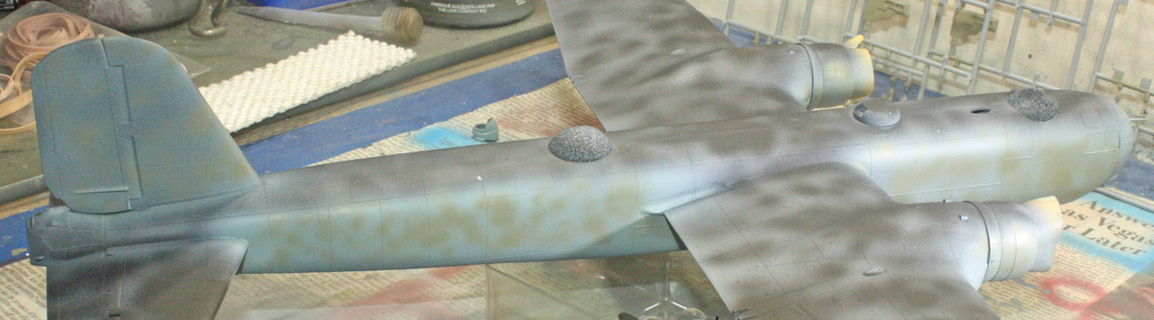

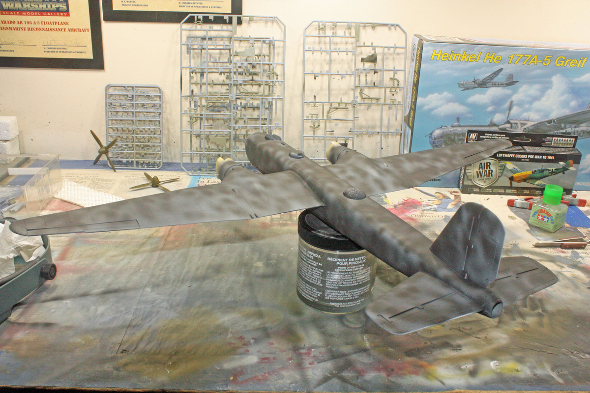

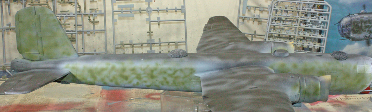

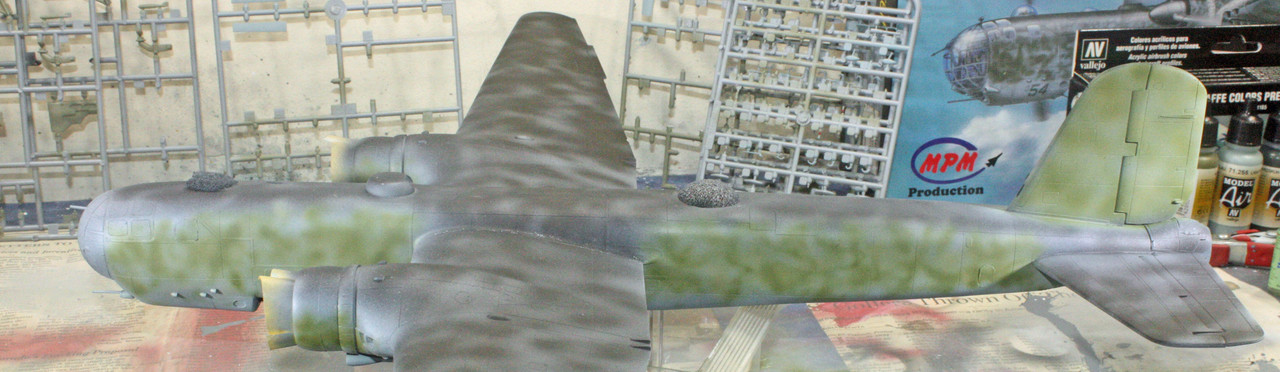

More progress - I have the mottling completed and now curing up under a coat of flat clear. I followed the plan I laid out above, starting with RLM 02. I didn’t think it shows up too well atop the RLM 65.
I went with RLM 62, which is a lighter green than what I will be using for the top side splintering. I splotched the RLM 62 randomly until I felt like I had a decent coverage while still allowing the underlying RLM 65 to show through as well. I dialed the compressor back to roughly 8 PSI for this painting.

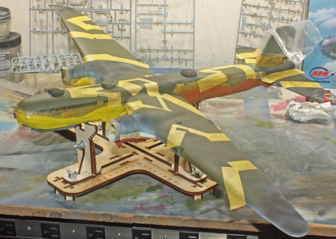

Today’s progress was pretty good, once I actually got to the bench. I spent the first 10 hours in a training class (missing entirely today’s University of Florida - Texas A&M University football game). I have the entire airframe painted, with today starting by masking for the splinter scheme then putting down the RLM 70. No issues with any of this, although looking at the pictures makes me think I may need to go back on some of the RLM 71 on the starboard wing near the aileron. I didn’t notice anything amiss in that area while I was spraying a gloss clear coat. I’ll double check tomorrow.
