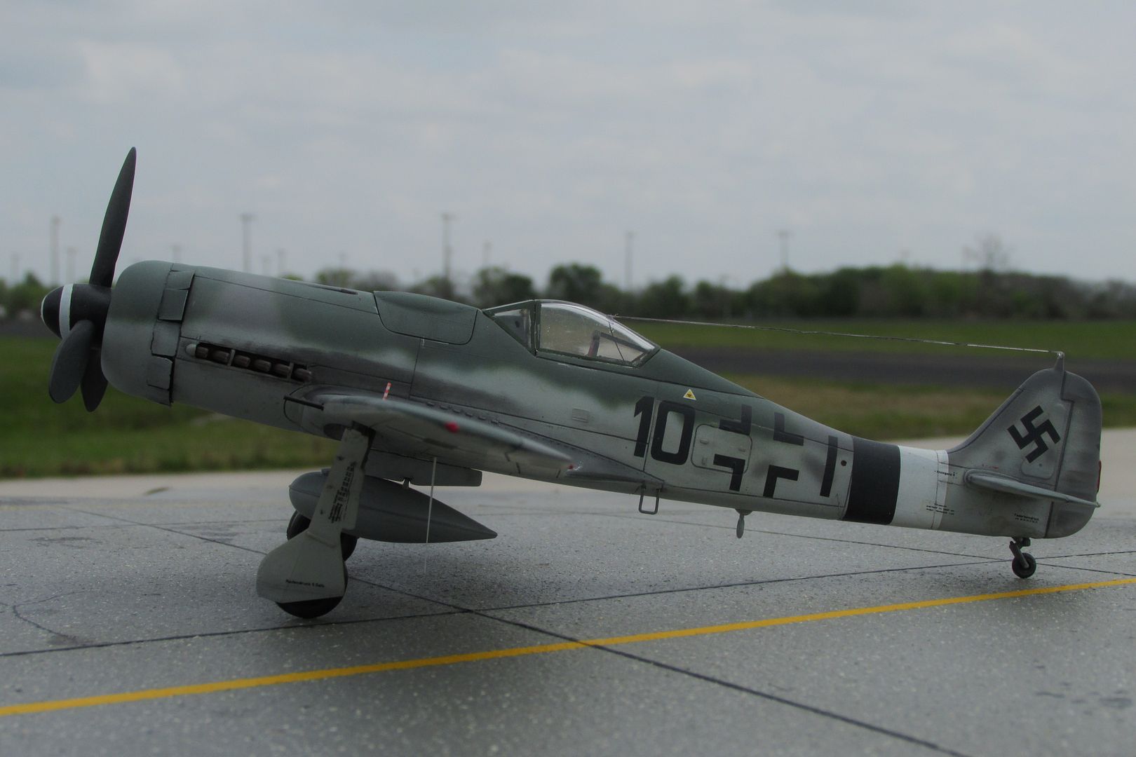

1/48 scale Bf109, freehanded with single-action…
