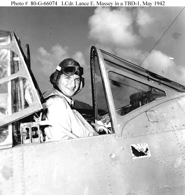

OK, just spent the past session masking up the greenhouse canopy of my TBD. That was quite a project. Now lately I have been airbrushing my canopies in two stages, an inner and then an outer color, since often the interior of the canopy framework is black, gray, or some other low glare color different from the aircraft exterior color. Now here is my situation. The best TBD cockpit reference photos are from pre war when the TBDs were still in overall Aluminum lacquer and so were the cockpits.
Now some TBDs pre war had their cockpits and interior canopy framework painted in Interior Green
and some judging by no contrast in this photo of 6 T 8, had at least their upper decking painted in Blue Gray, which is the way that I am going with my build.
So based on the photo below of LCdr Massey in his TBD, would you say that the interior color of the canopy framing is Blue Gray to match the exterior?
Hey Stik, dont know if this helps you but, I have Squadrons TBD In Action, and it says early TBD-1s had Aluminum dope interiors and later aircraft had green zinc chromate innards. It would make sense, at least to me, that the older planes that were re-painted after hostilities began still had the aluminum interiors, with the new blue outside. Its a guess on my part, can`t see them taking the time to repaint the insides when they were rushing to get ready for a fight. Then again…the Navy works in mysterious ways…[;)]
Len
Yup. And all carrier based aircraft were painted in the Blue Gray over Gray camouflage by Oct 1941, so the wartime rush was not quite there yet. B&W photos are really hard to nail that point due to low contrast between Blue Gray and Interior Green. So I am guessing that based on the photos above I can go with either Interior Green or Blue Gray and not be wrong. But with my cockpit top decking already in Blue Gray, that would be a better choice for the interior of the canopy framing.
