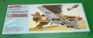

It was great reading your post. The Old Monogram Hawker Hurricane was my re-entrance back into the hobby in the late '90’s.
My - how things have changed !
Nice to see that you’re making use of the tragic remains of your garage accident. That Monogram Wildcat never looked so good !
