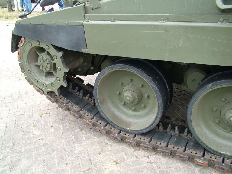

I don’t know if this will help but here is a photo of the tracks on an AS90. It might give you an idea of the colours to choose.
