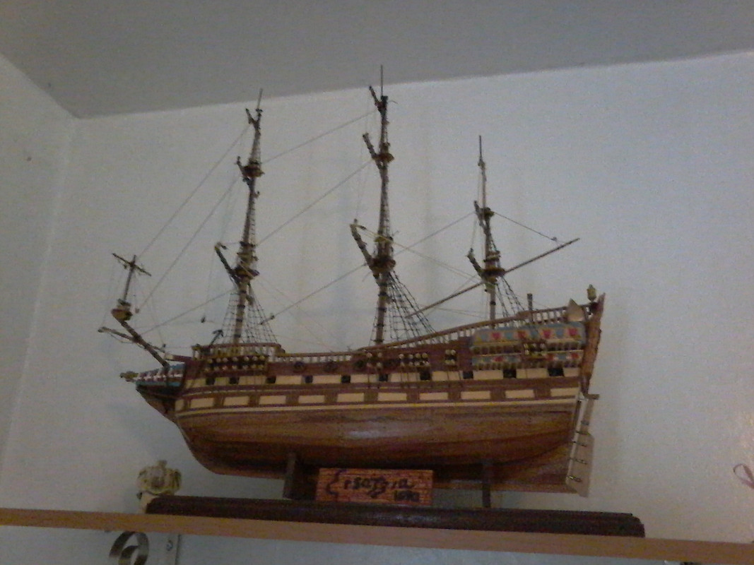

I’m no expert here, I’ve only build one wooden ship, but I’ve read that you should take a wood for a mast that wouldn’t change the dimensions with age and humidity changes, otherwise the rigging will go slack over time and that wouldn’t be good, right? If I recall correctly the book said you should use sprue or pine for the mast because of that, but I might be wrong here. Anyhow I remember the book saying going with extra fancy wood for the mast might be a mistake. I hope other members here might add more details here - anyhow, good luck with your build and have a nice day
