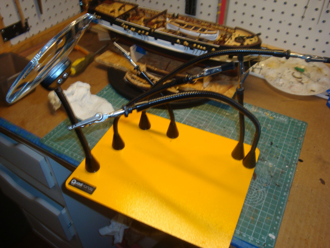

When I have to hold the very small parts to glue or paint then, I have this device ( see the photo) that, so far has worked for me very well, the yellow base is solid steel, and all the “fingers” are magnetic, so they can be located anywhere withing the base that you need them to be. They are fully flexible and you can buy one whith a magnifier glass that has a light ( This one is extra charge ). My dauthers gave it to me for my birthday. They got it in Amazon and the price, including the magnifier glass, was around $70.00
Hope this helps.
fingers
Joe
