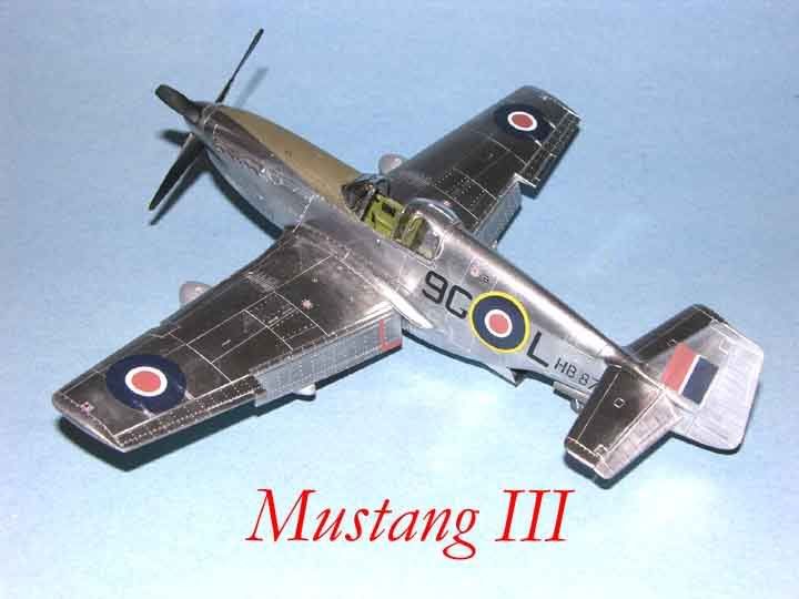

This will give you an idea what BMF looks like on a Mustang.
Enjoy!
