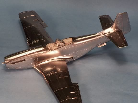

This result was acheived with Alclad.
Great stuff
Now that is BRIGHT. Which Allclad did you use, Chrome?. Man, that says “look at me”. I love it. [:D][yeah]
What was used for the primer?
That is crazy shiny- wow!
Do not take that thing out in the sunlight unless you are wearing at least SPF20 and some dark shades! [;)]
Well…the man said he wanted a mirror shine finish[:O] And, it actually can be correct.

So what Alclad did you use to get that finish? borderlines on amazing
