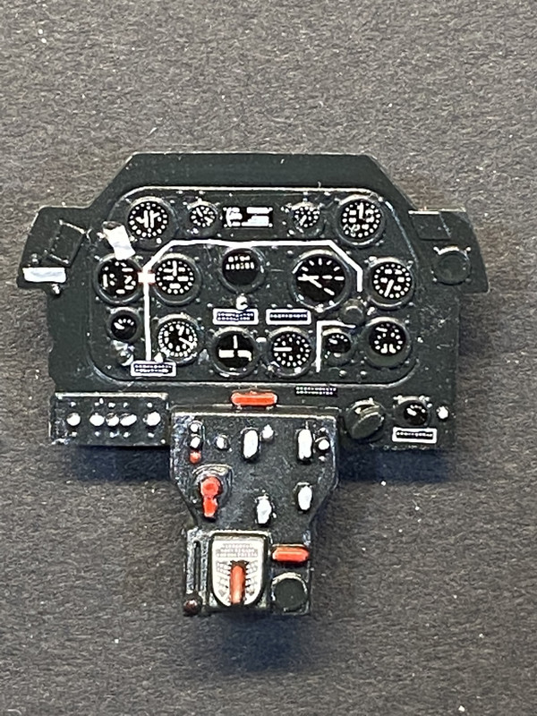

Here I sued a combination of decals, dry brushing and paint on a 1/32 Mustang IP.
