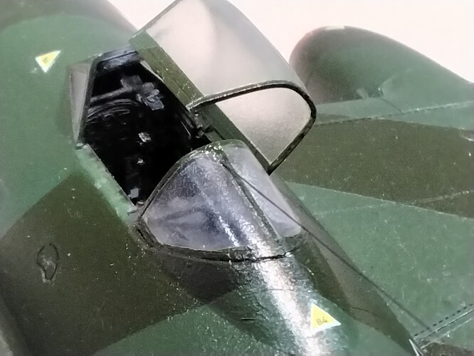

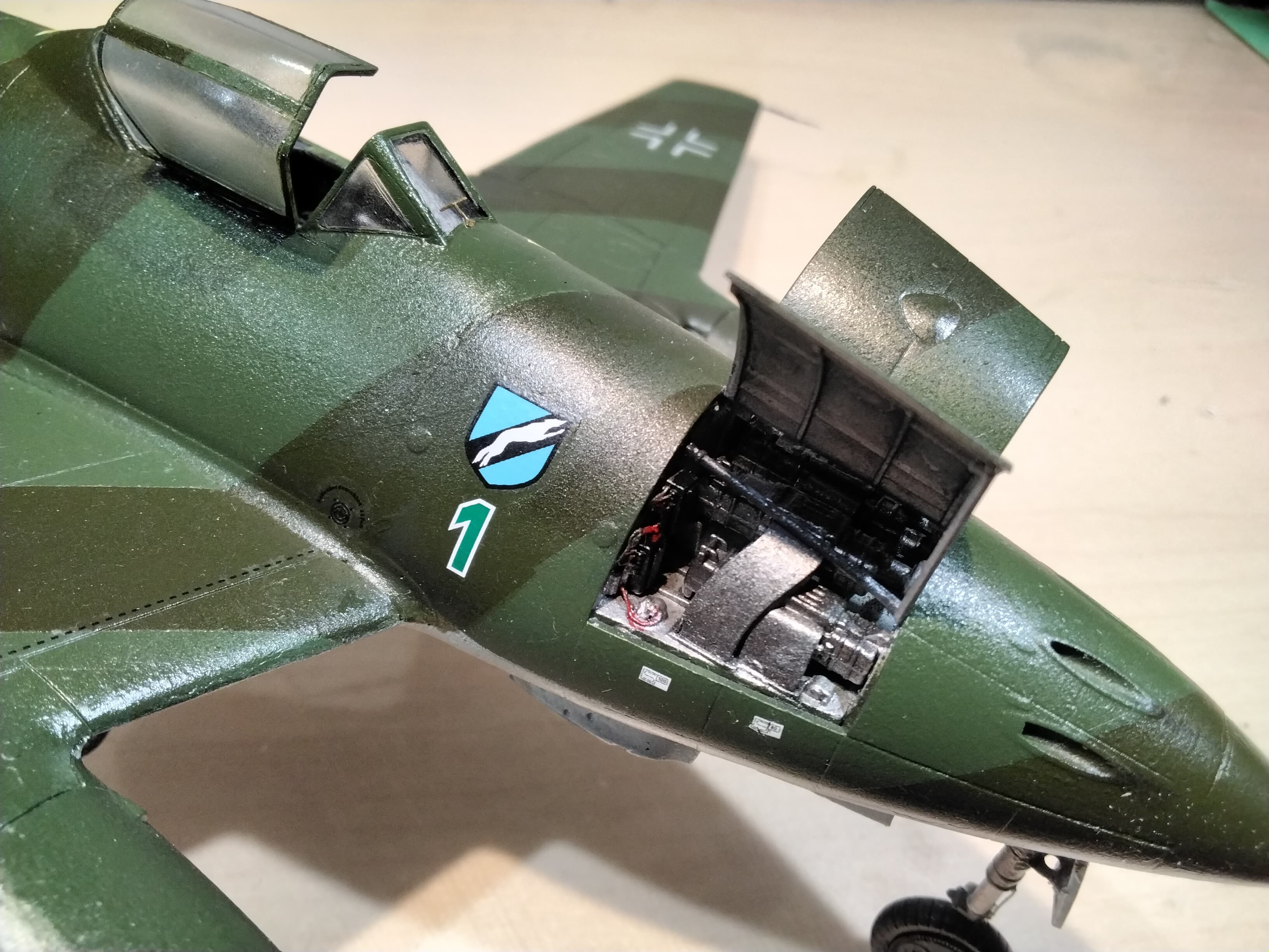

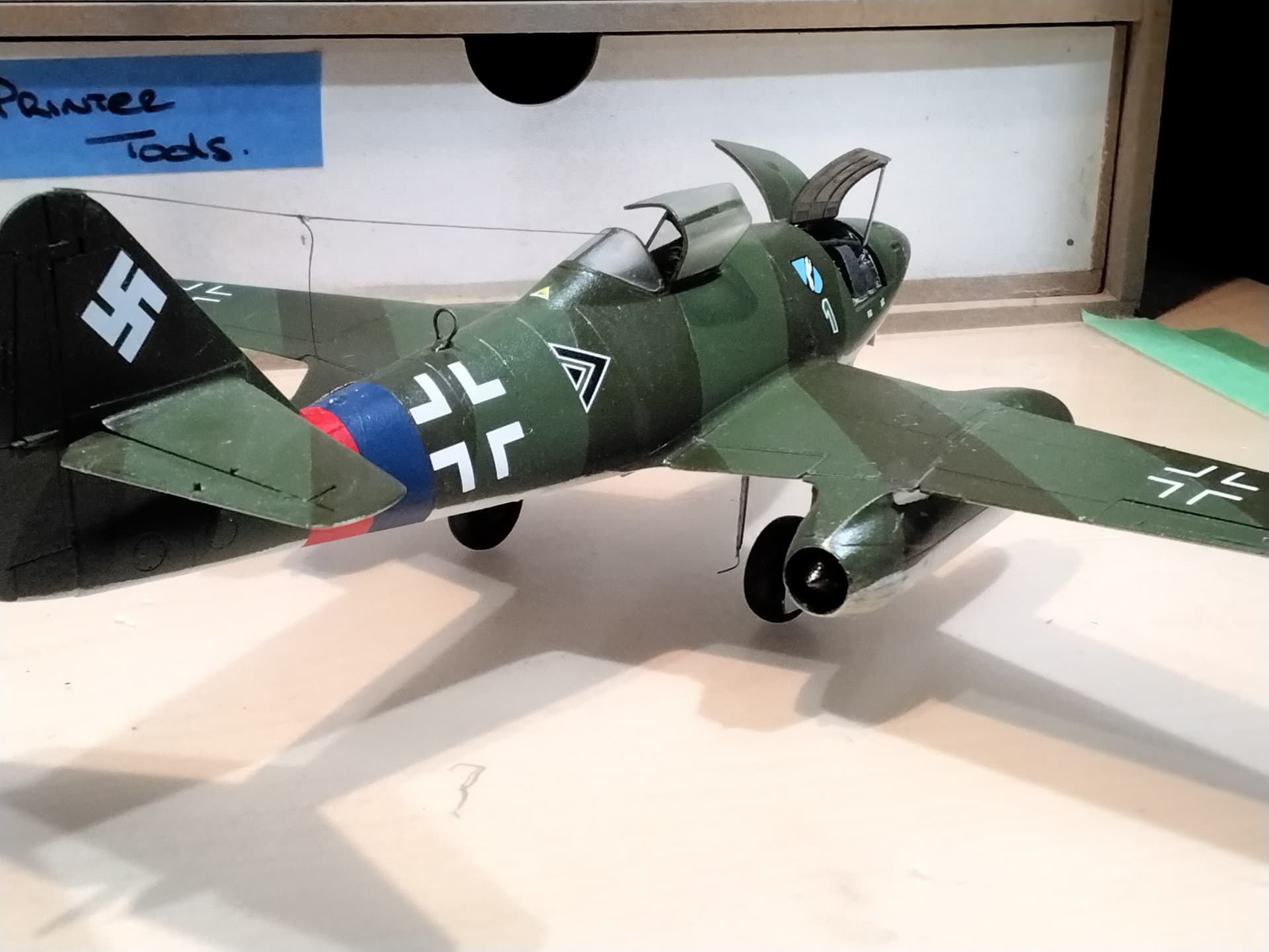

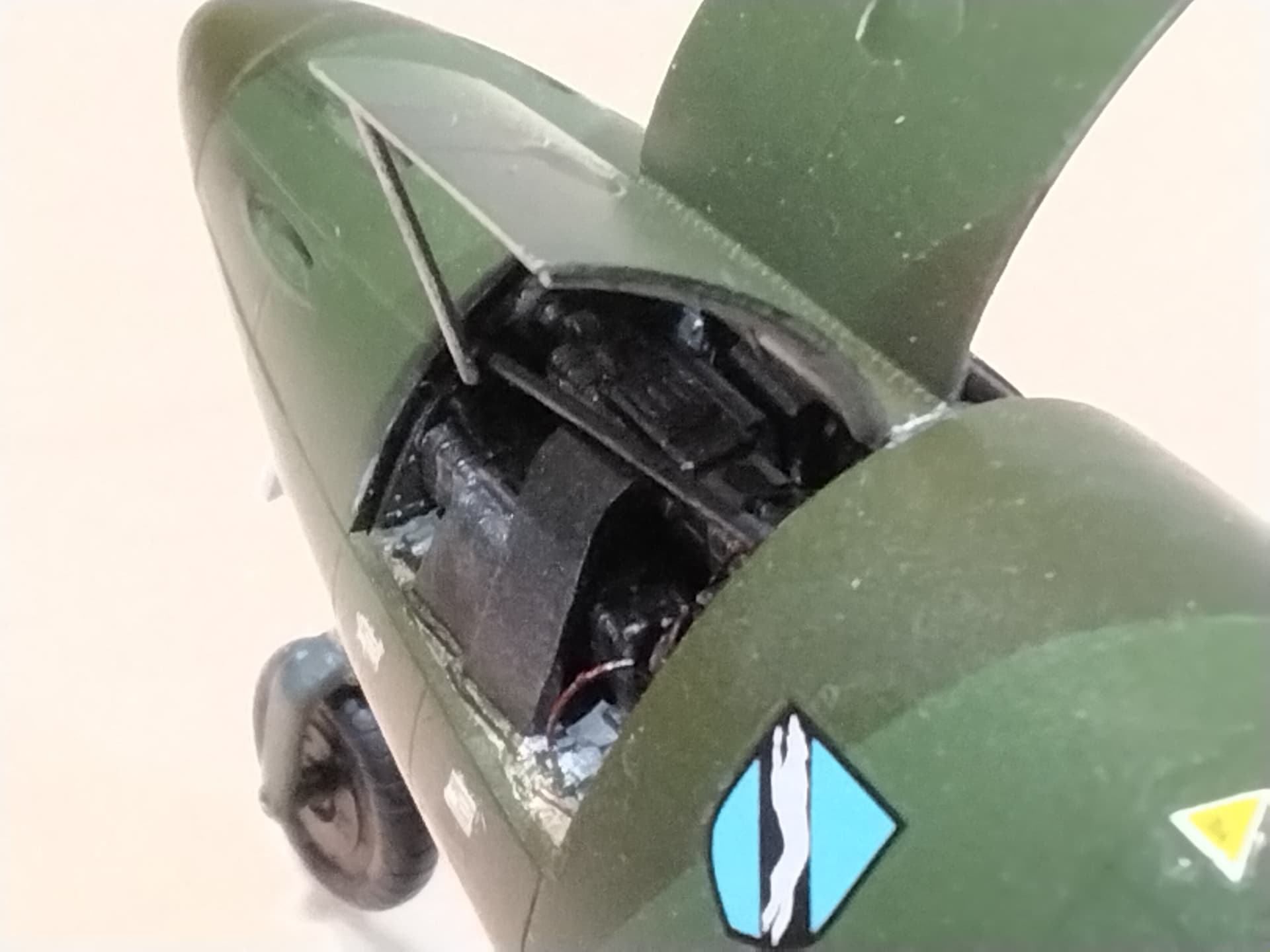

I completed the HobbyBoss kit a couple of years ago. It was a good basic kit. Not sure what level of detail you are looking for.

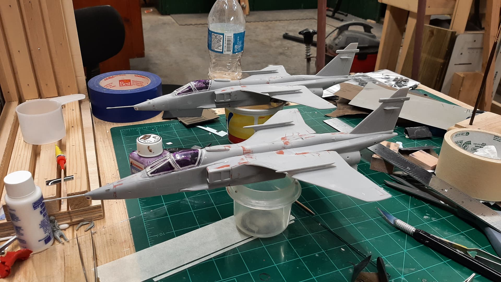

Canopies can be an issue
But over the years I worked out what best works for me:
1). A small Glass window pane and a metal straight edge.
2). Apply a length of masking tape to the glass and smooth it out.
3). With a new #11 x-acto blade and straight edge, cut both sides of the tape off and toss it. Now you have non fuzzy clean edges to work with.
4). Using the straight edge and new blade, cut the tape to whatever width you need. As small as 1/32" works well.
5). Pick edge of tape with the knife and use good tweezers to pull and place the tape on the canopy inner edge of frames, trim with the blade for length. Any scrap pieces place on the canopy in different places.
6). Use any of the liquid latex and fill in the exposed canopy where you do NOT want painted.
The thin strips of tape gives a nice hard edge and is flexable to conform to compound curves and irregular shapes and the latex fills in the rest easily, and for me, helps me get in touch with my inner lazy.
NEVER TOUCH THE GLUE SIDE OF THE TAPE WITH BARE FINGERS.
I always wear the blue gloves to mask canopies…and ignore any inferences of proctology from friends.
