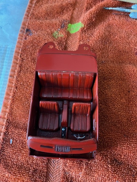

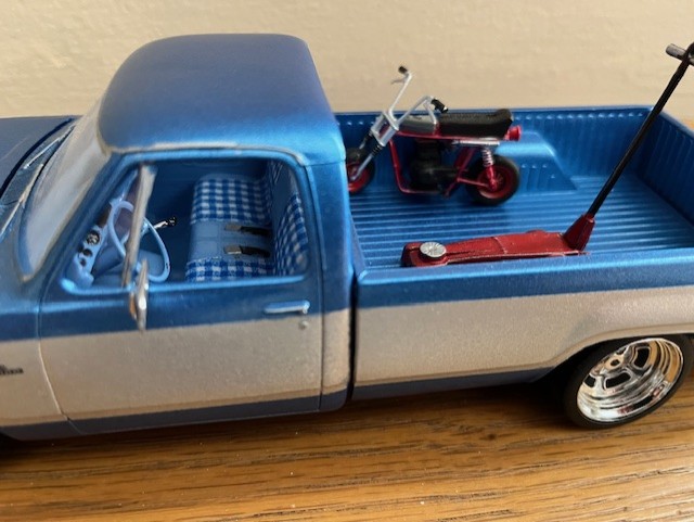

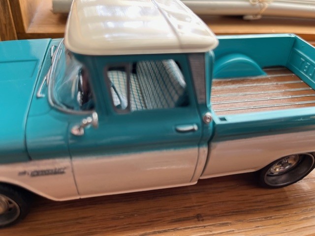

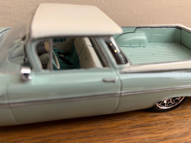

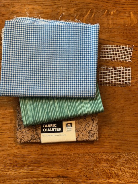

I’ve tried fabric samples cut to fit the seats. Works good on bench seats. I place the fabric on the seat and brush on Mod Podge matte on the surface of the seat and fabric surface, like a decoupage. When I paint interiors (and engines) I use a black primer then the color coat to give definition to details. I have also tried mesh cut to fit the seat then paint over the mesh to give a plaid pattern when the mesh is pealed off.

Thanks LungFu. It can be a little challenging to find fabric with small enough patterns to come close to matching the scale. I have also found leather or leather like samples that could work too, but they are kind of thick and would be tougher to work with…but maybe good for accents. Fabric could also be used to add texture if needed for some designs.

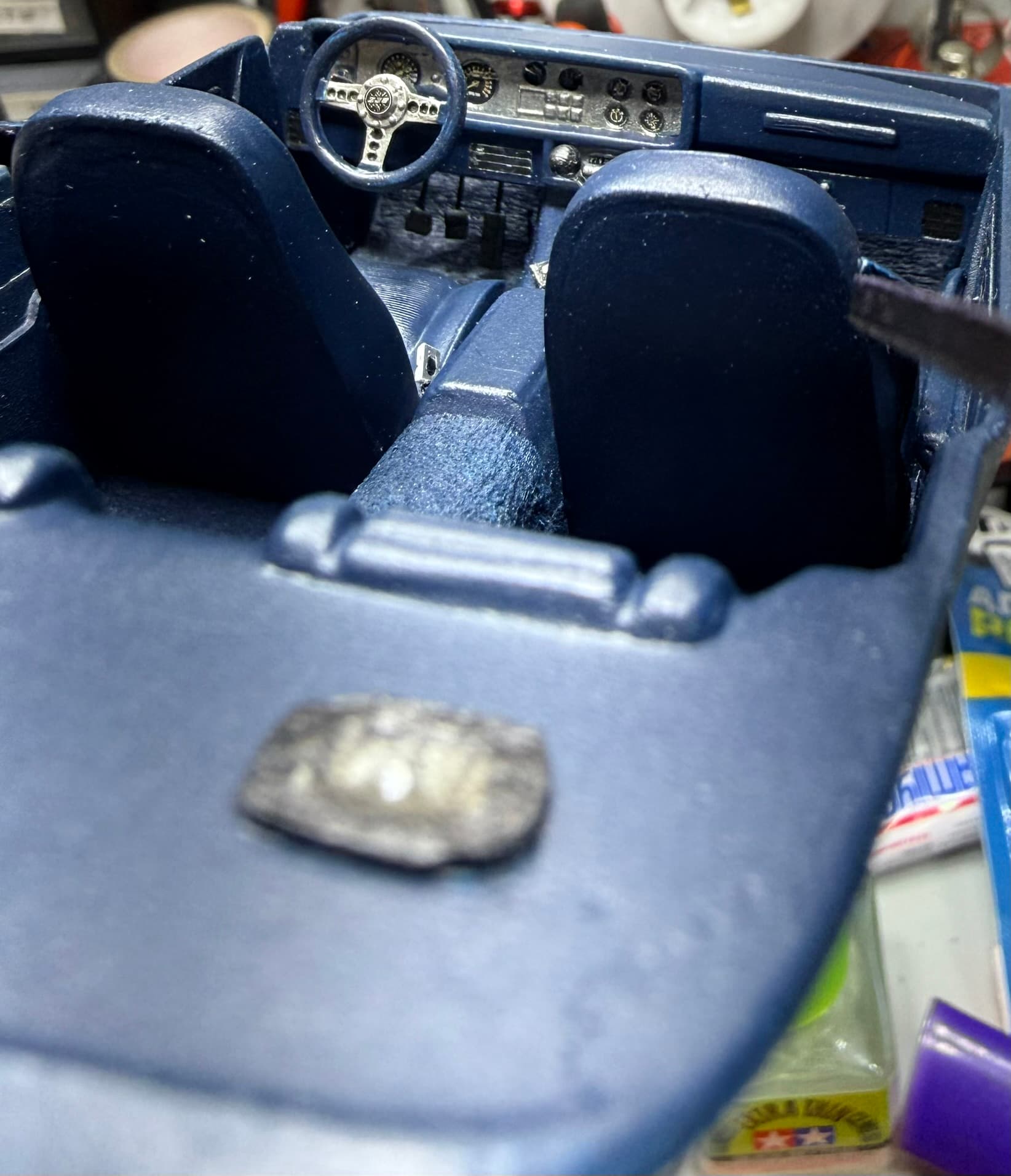

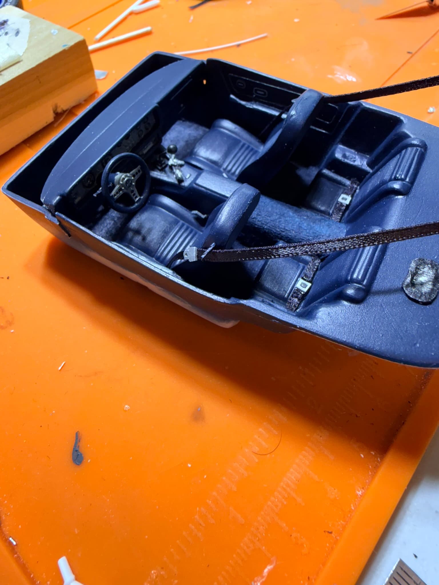

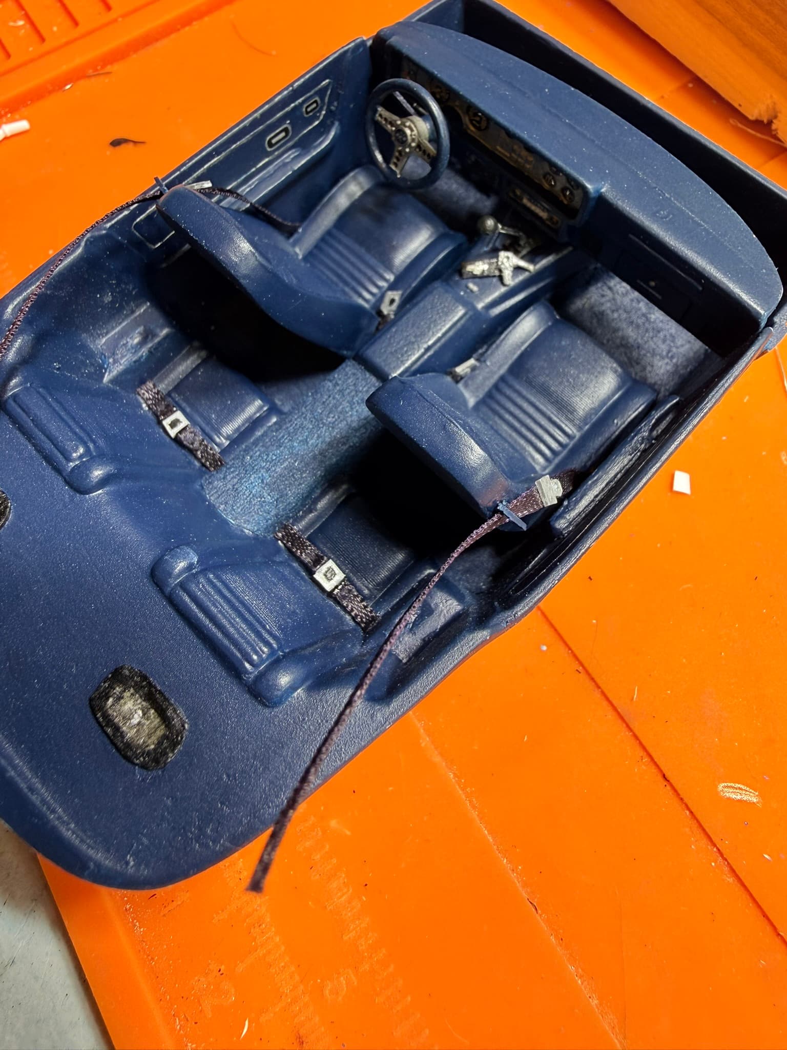

For my carpet on this one, I painted a single ply of a blue shop towel with masking tape as the backing underneath. I used masking tape to draw off the pattern on the floor then tape the single ply of the shop towel, paint the towel side and then glue it down.
Welcome to the forum Chuck, @04Canyon. Great recommendations on flooring detail. Looks like a Trans Am interior. Love those custom seat belts too. That blue looks spot on to me… Nice work.

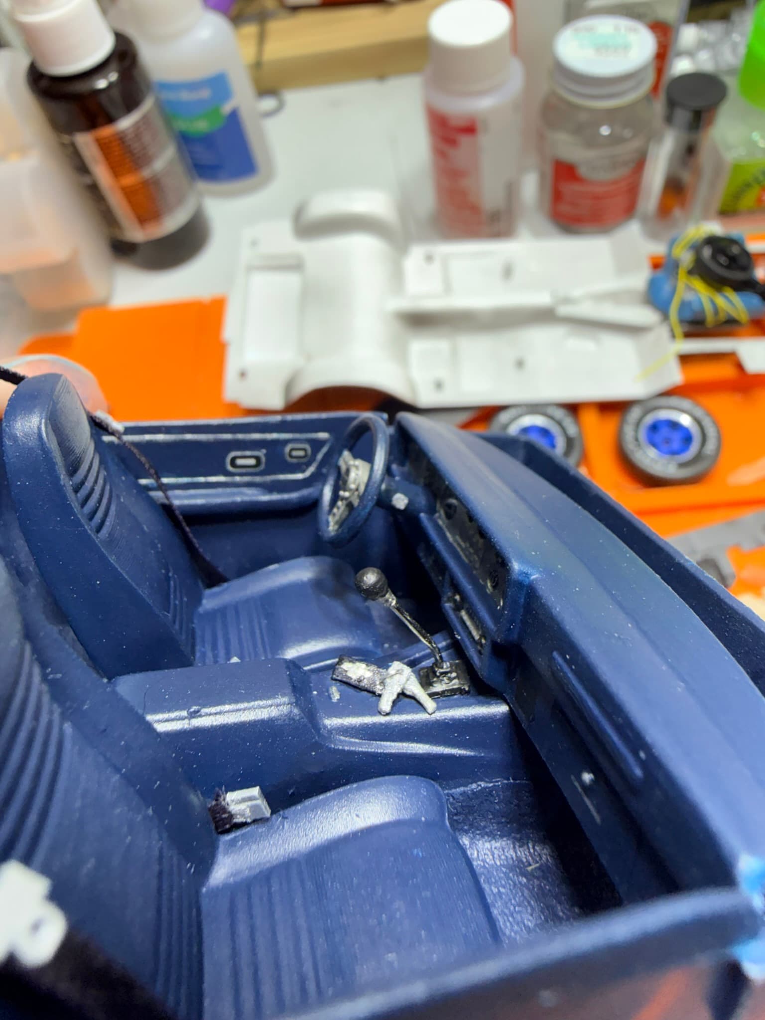

…wait :thinking:…those are car keys on the center consol… excellent touch, awesome detail!
Consider posting an introduction in the Welcome-Introduction section so we can get to know you a bit. I am looking forward to seeing more of your work. Thanks for posting!
PeterW
Thanks, yeah this is an 81 Z28.
