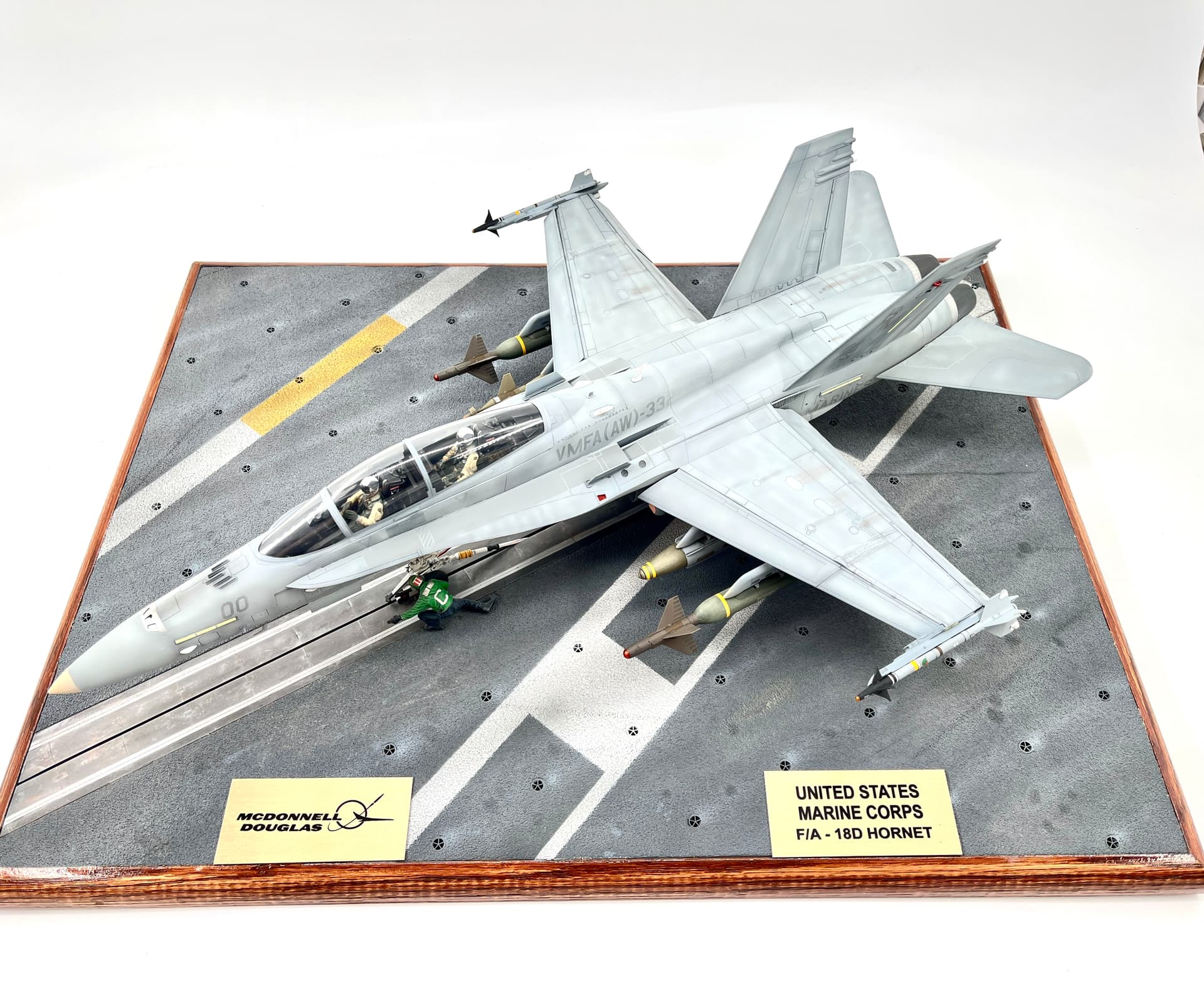

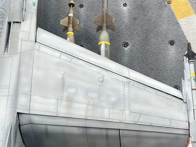

This is Academy’s 1/32nd scale F/A-18D. It was built several years ago. I scratch built a deck section with a catapult track to depict an impending launch. I had three areas that I wanted to improve on. 1. The paint job on the Hornet. The original paint job looked very unrealistic. Barely weathered at all. 2. The carrier deck section. Because I was in a rush to finish, the original version looked comically unrealistic. (The catapult track was too wide). 3. The rear landing gear wheels. They look more like something out of Fast and Furious movie (Not vertically straight). Both are angled out considerably.
Two areas have been fixed. The paint job, and the deck section. I have to figure out how to fix the wheels, without destroying the gear legs.

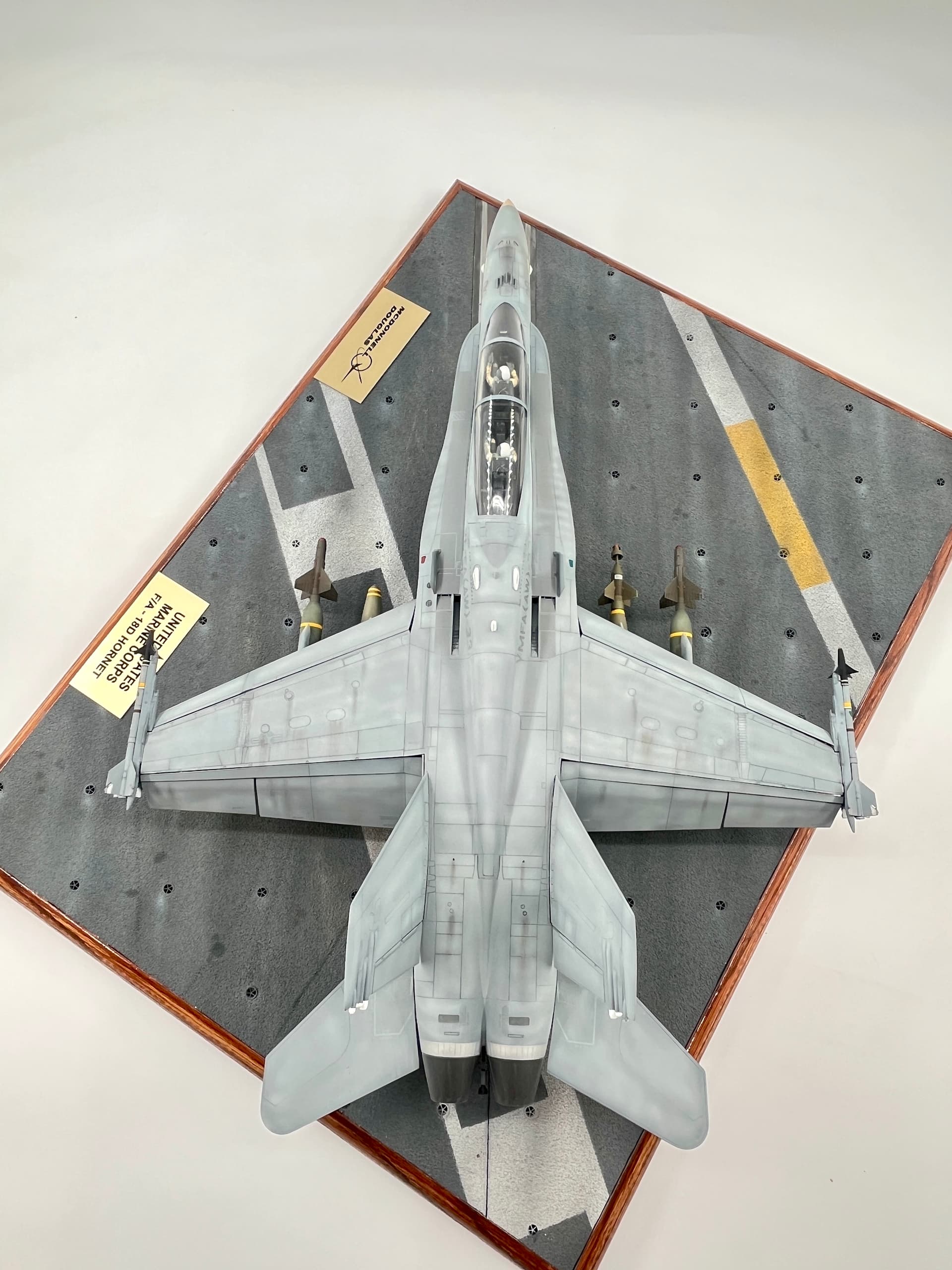

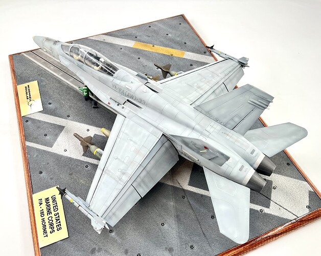

The paint job. First, the model was thoroughly cleaned with cotton cloths and q-tips in a mild soap solution. After drying for about an hour, I took a can of compressed air and blew off any residual fibers that had tried on the surface. For a more weathered appearance, white was added to the original color. Individual panels, and sections were picked out The paint was thinned quite a bit with lacquer thinner to achieve this. The paint job was fixed about 2 months ago.

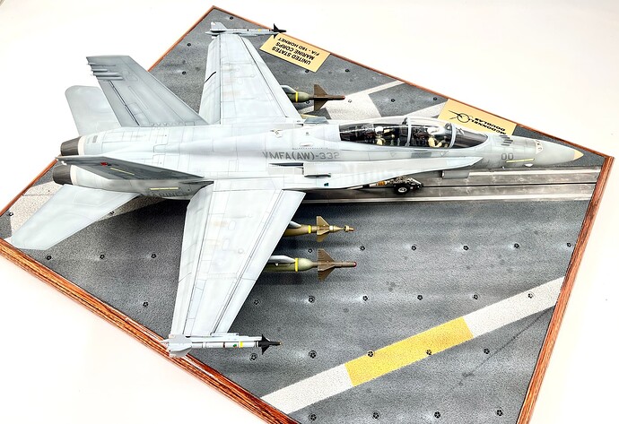

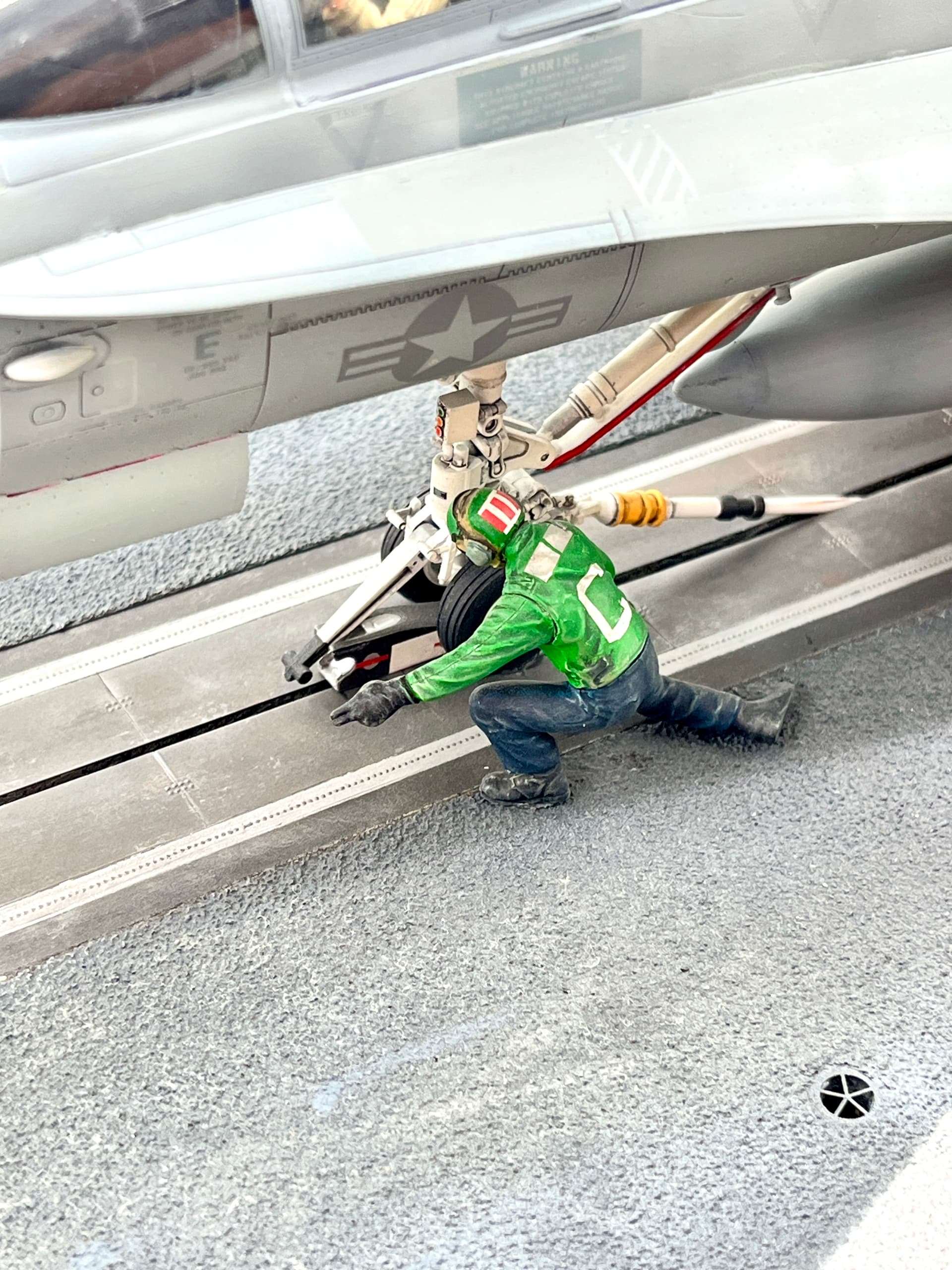

The original base was scrapped. I started from scratch. I looked at several photos of catapult tracks on the internet. It was made with polystyrene sheeting, and micro Scale rivet decals. The deck surface is open face hardwood floor, sanding paper. I forgot what grit it is, but obviously it’s aggressive. The metal tiedowns are from Tom’s Model works.
It was built so long ago, that I can’t find the original photos. I’ll post them here once I find them to see the changes that were made.

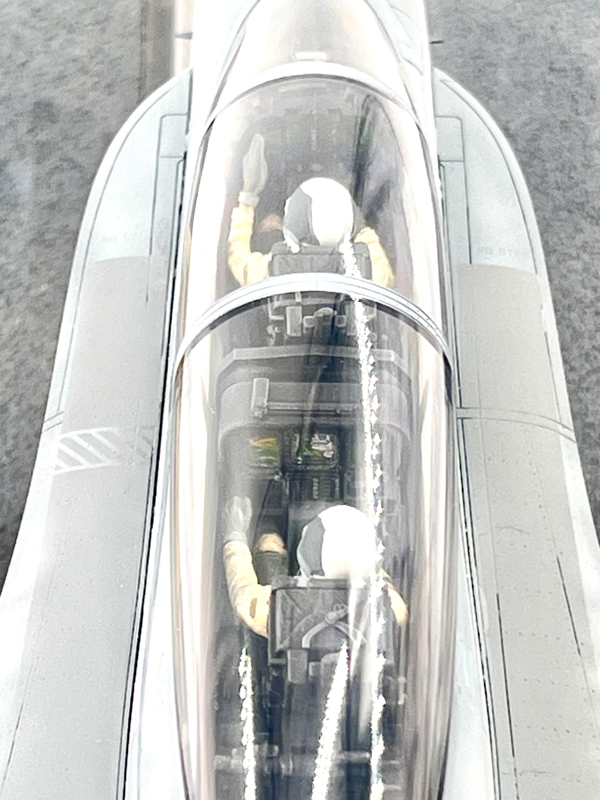

Highly interesting and well done. I wished I had space to build all my aircraft models in that scale, but alas I don’t, and therefore I have to resort to 1/72 scale models instead, but yours is indeed a jewel, particularly with the figures you added and the interior cockpit, but even in general this is a museum piece indeed. Great job!

Thank you. Unfortunately, this is the only photo I have of the model and it’s original state. These overhead shots shows the areas where I lightened the original colors to get the faded weather effect.
