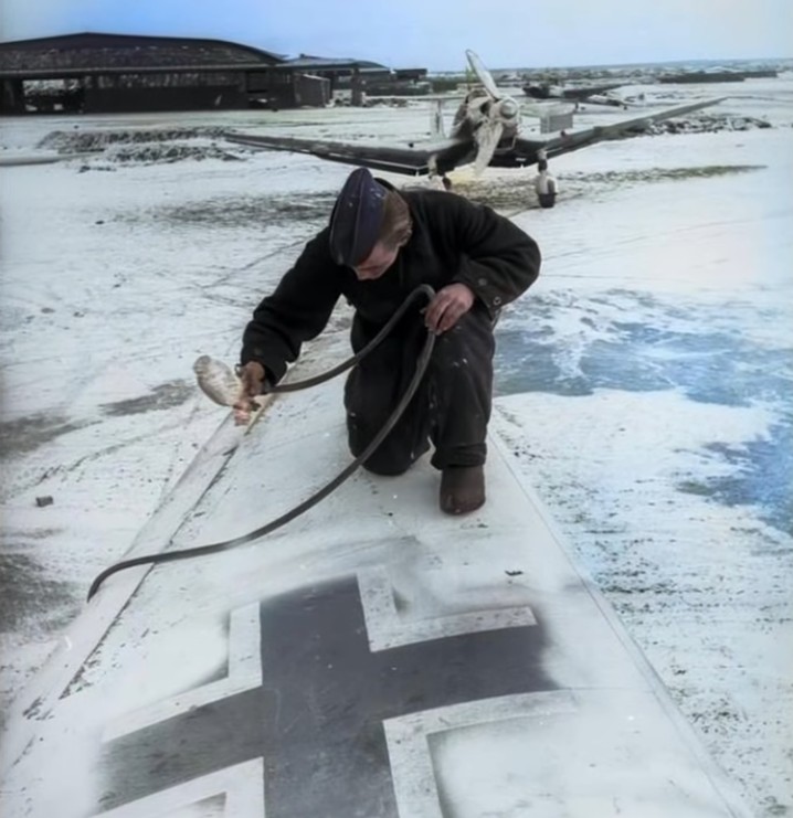

For anyone interested, a superb photo about one way of how it was done …
I was interested, thanks!
