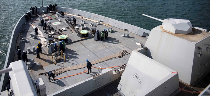

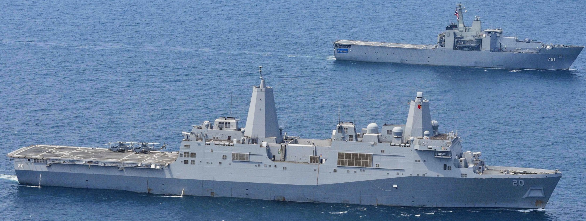

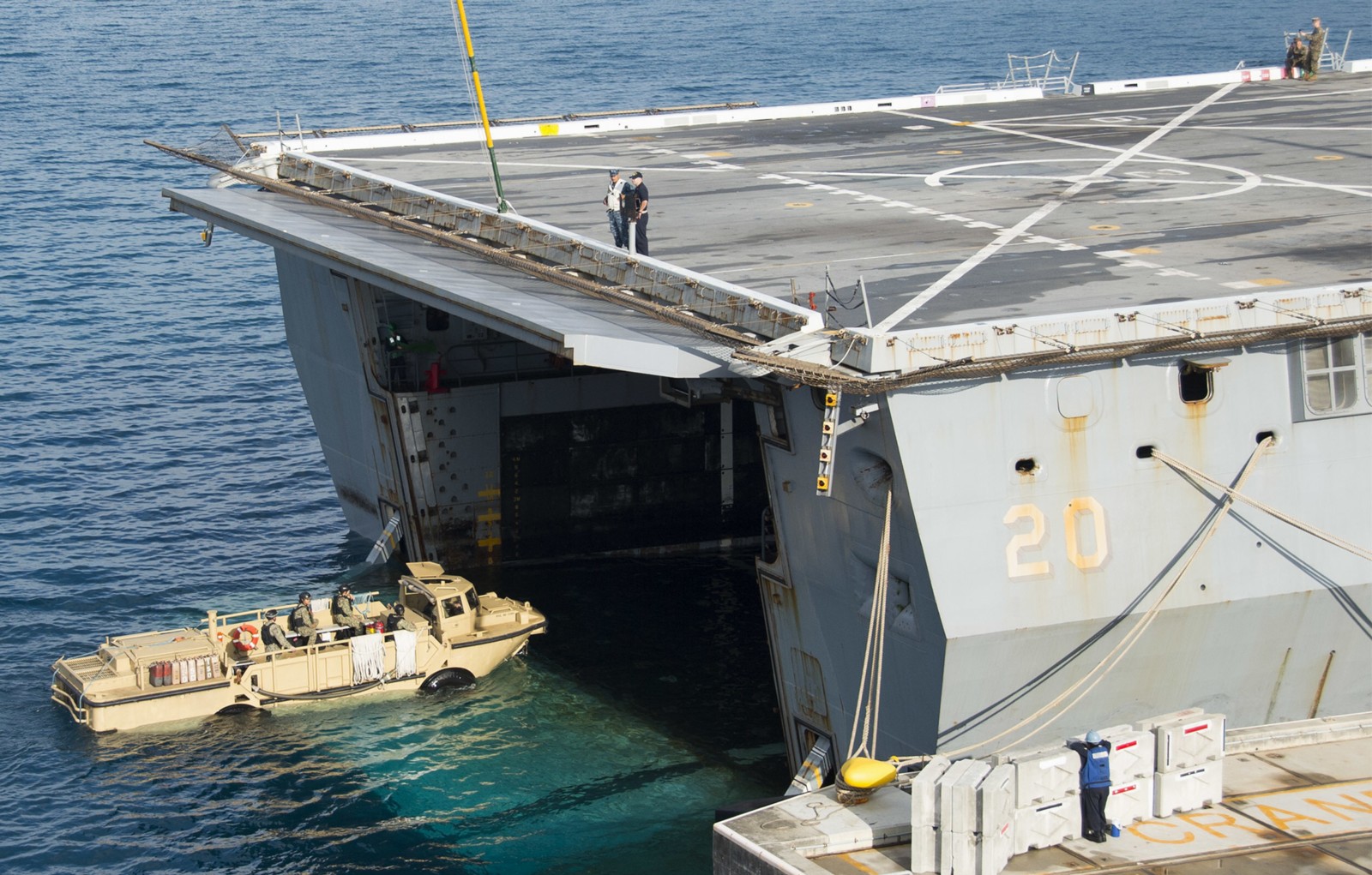

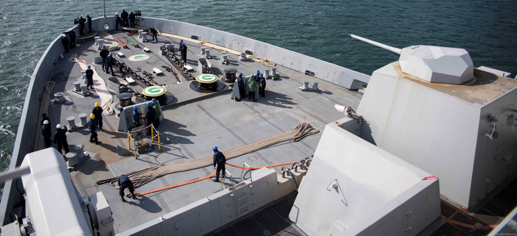

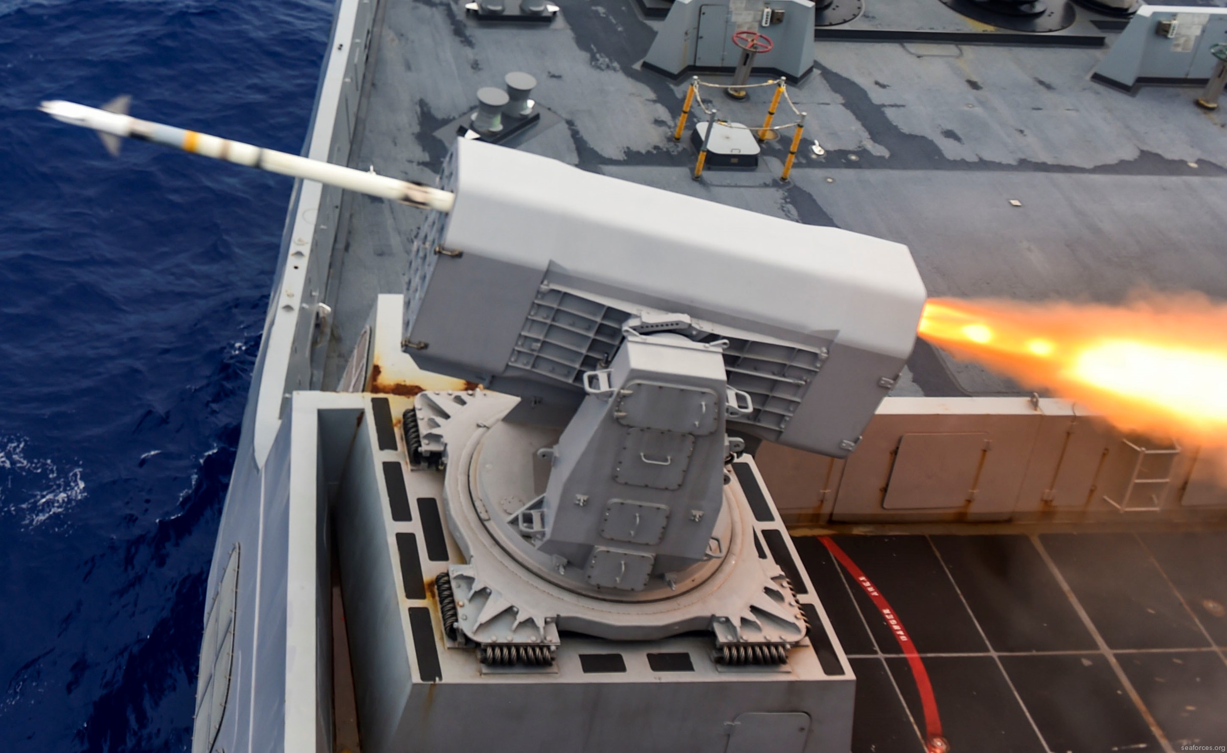

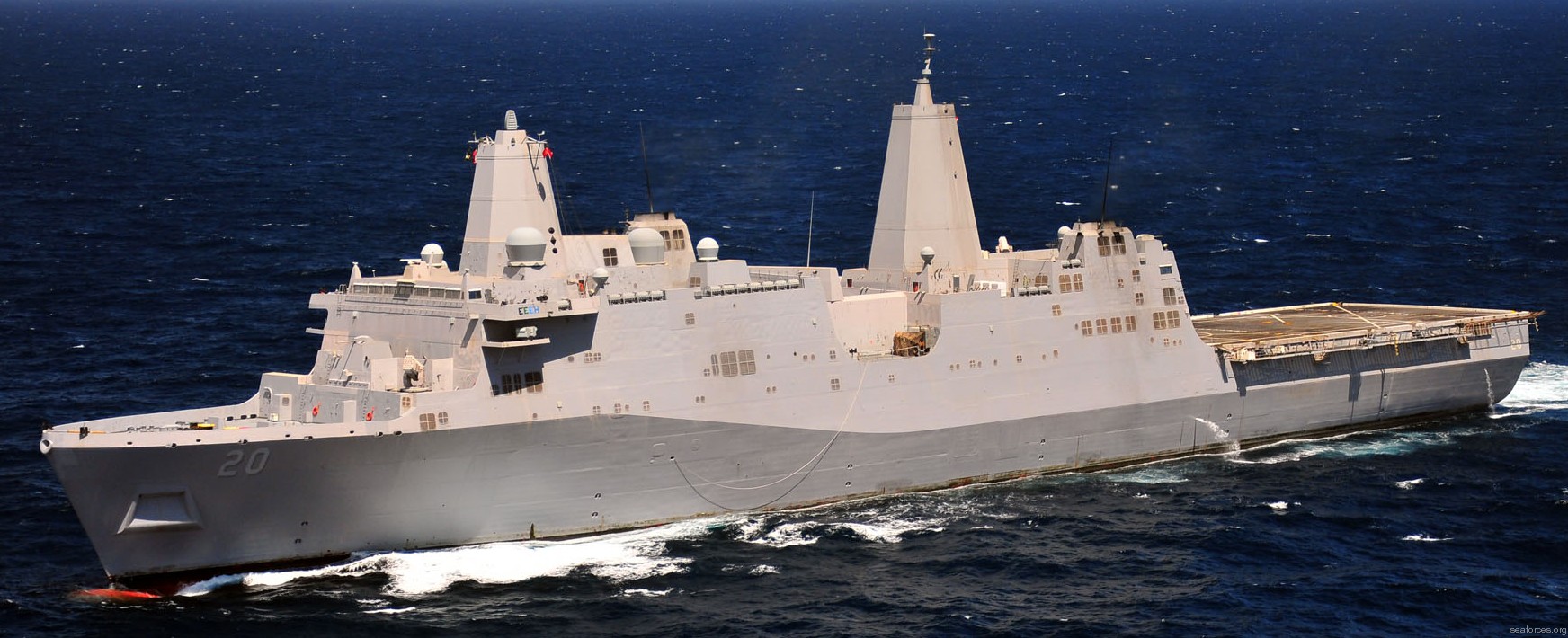

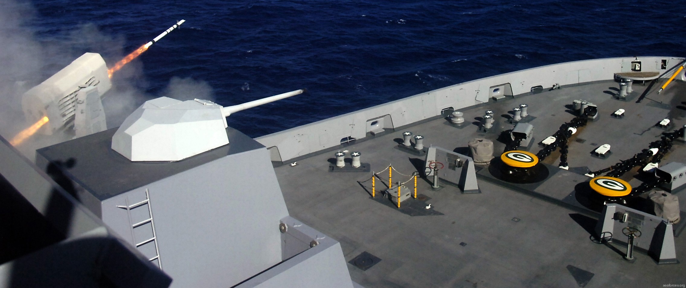

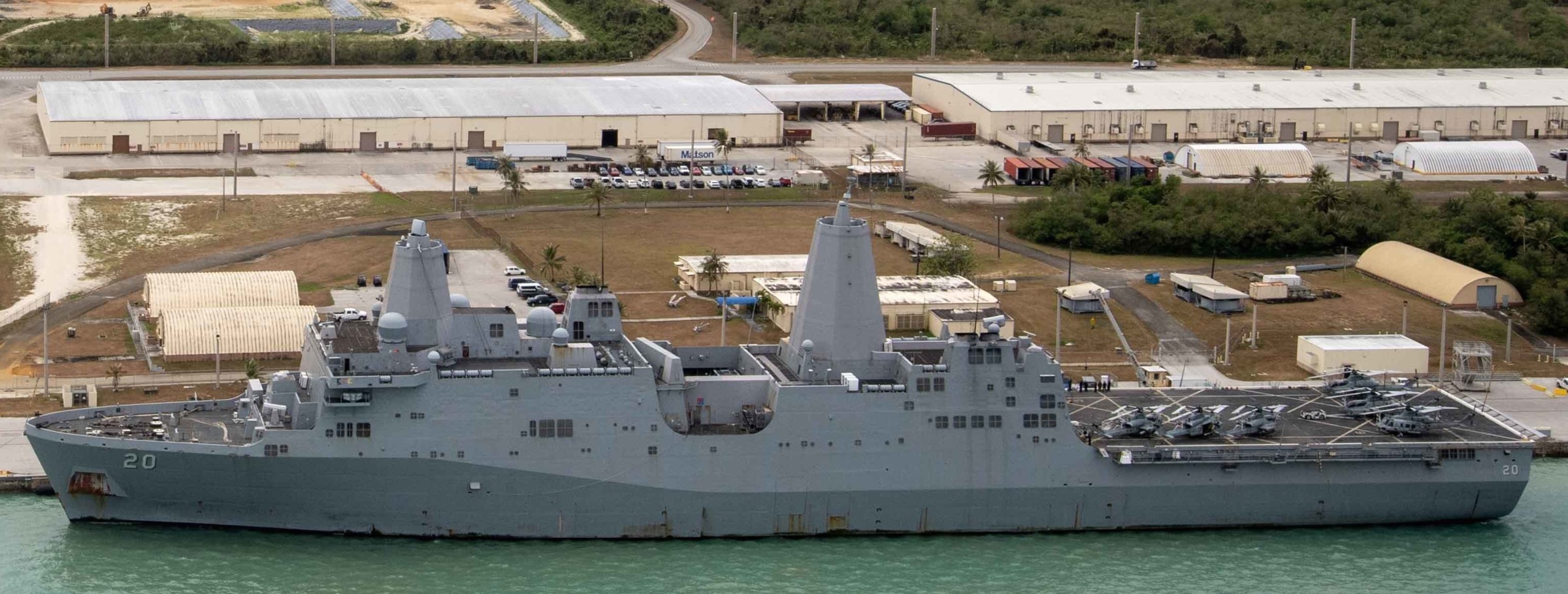

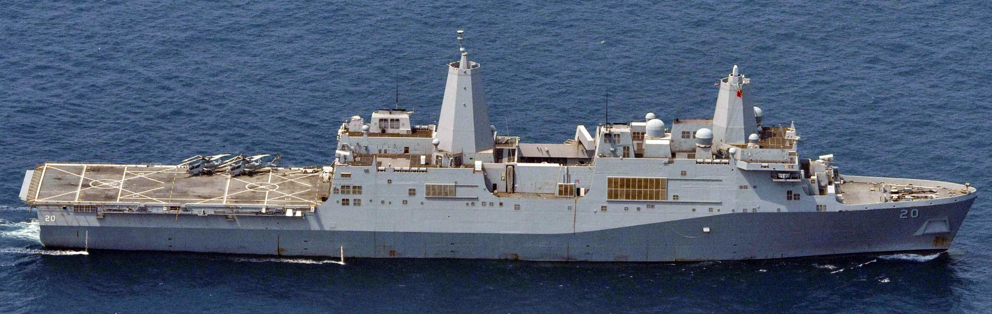

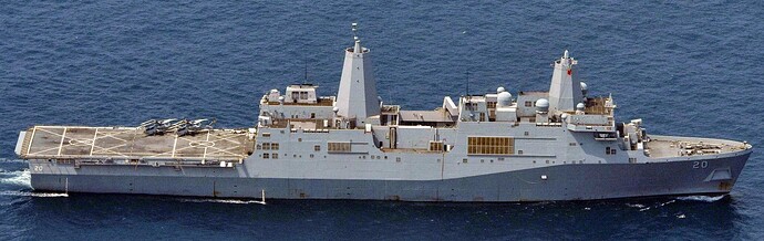

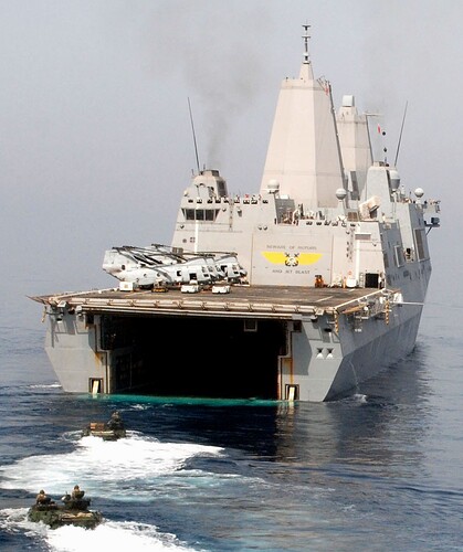

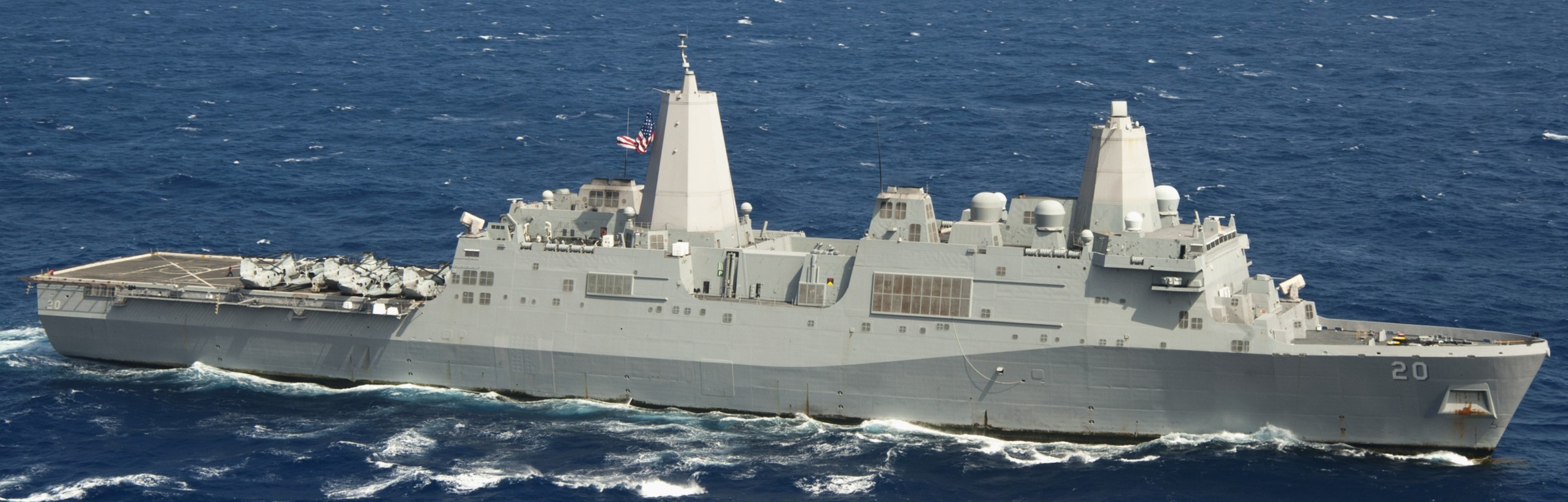

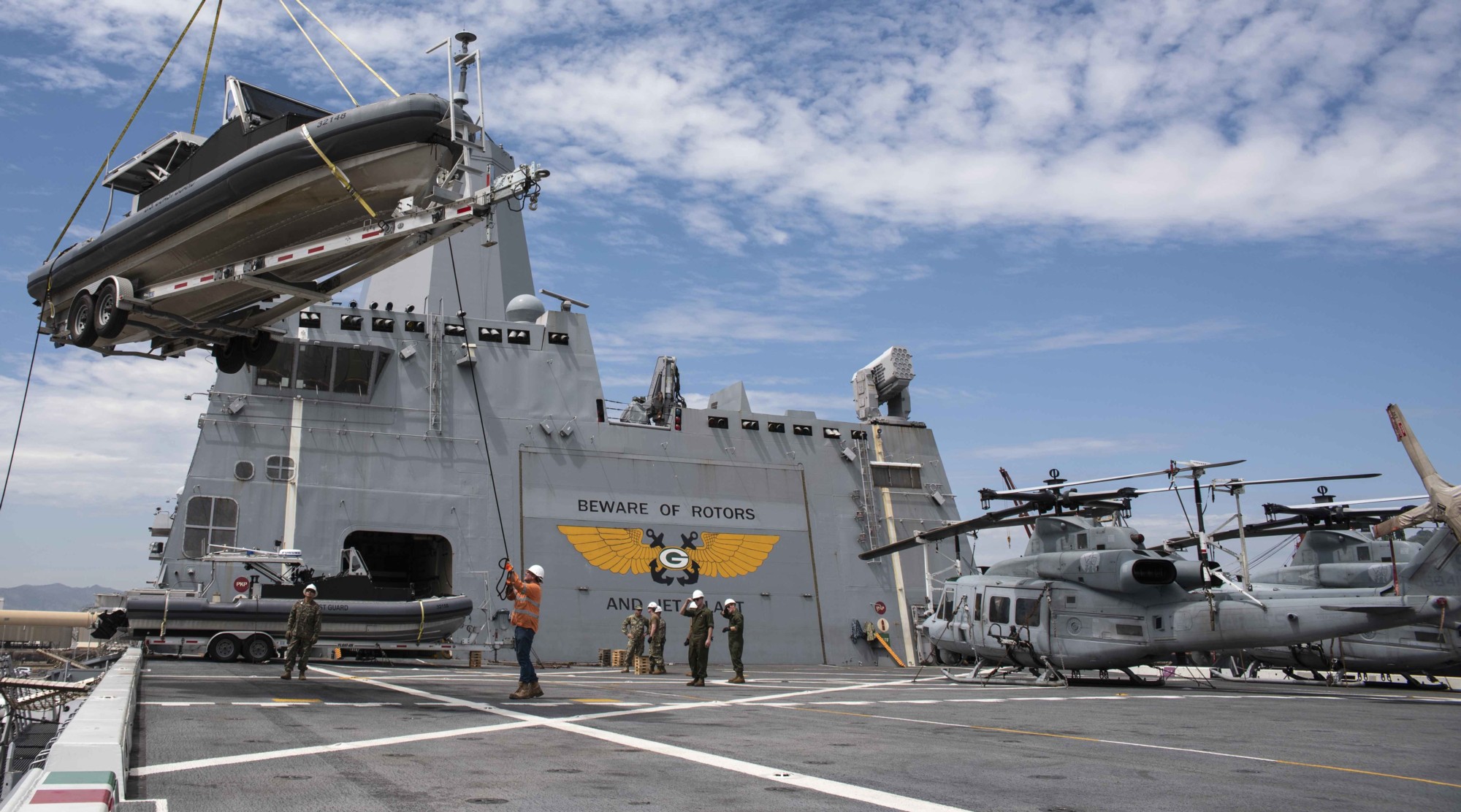

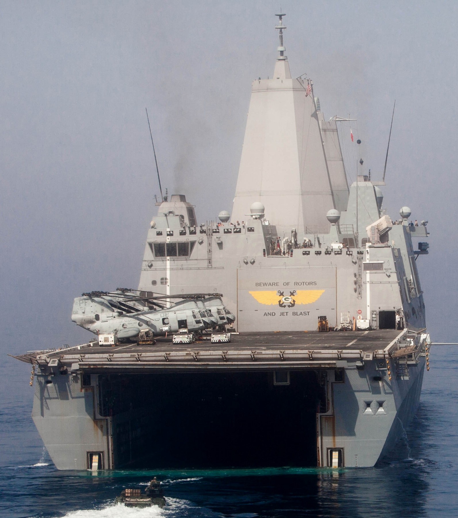

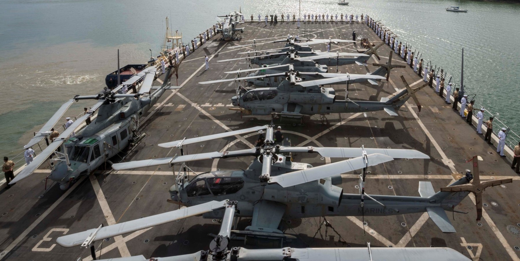

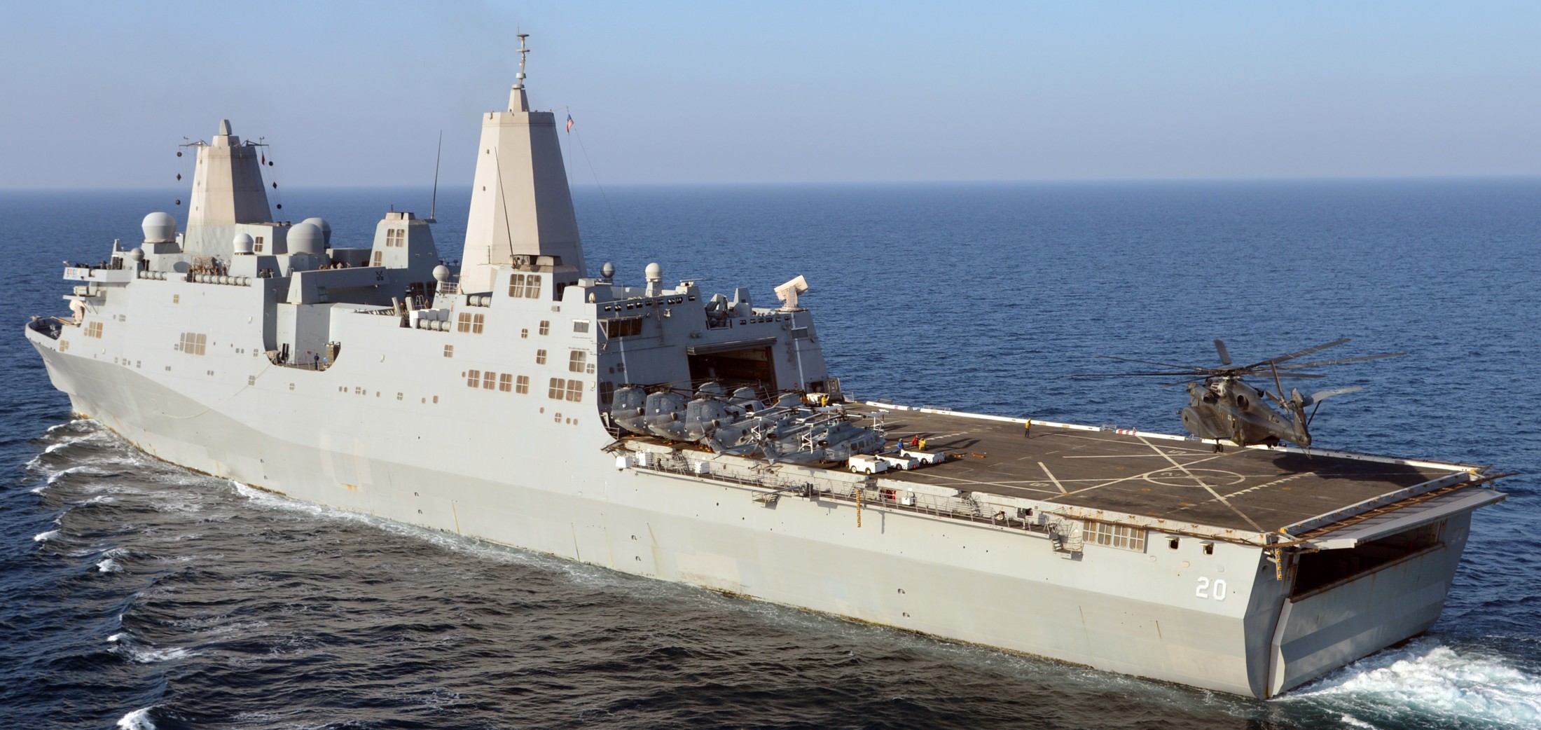

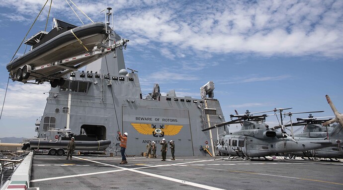

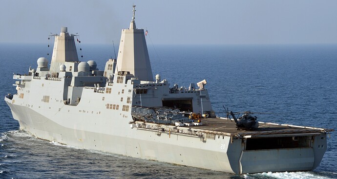

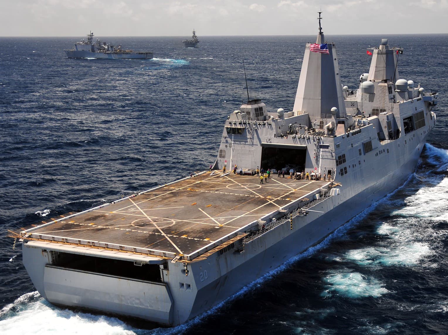

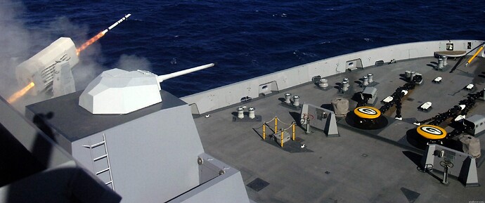

I am posting some pictures I have found online of the ship you are about to model and as you will see, the colors vary according to exposure, but also in wear and tear. Especially the rear deck has considerable variances due to fuel and oil leaks.
For you to judge. I hope this will help you decide which color is best.
And here is the link to the pictures I posted here:
PS: In my opinion I would opt for Medium Gray and then weather the surface with a Dark Brown mixed with either some of that Medium Gray for oil leaks, or even mix that Medium Gray with Midnight Blue (Very Dark Blue) for fuel leaks and turn them into washes by either adding a generous amount of thinner (if you use enamels) or water/acrylic thinner if you plan to paint it in acrylics and just lightly apply them here and there where the helicopters are usually positioned.
