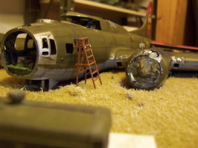

Rubber cement is a great way of masking for sure!
MGH, pick up a cheap-o kit of any sort to practice stuff on. I always grab random model bits from other forums to practice on.
This was my first time trying the technique and it turned out great in the end! Numerous times however I thought I ruined it, but you have to persevere and move on.
