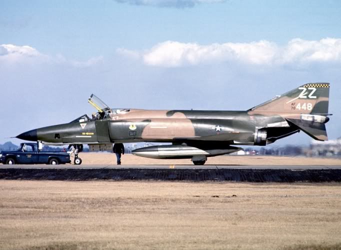

Are you talking about the fiscal year designator for 67-0448? The 67 stands for the fiscal year that Congress approved the funds to buy equipment for the AF. 67-0448 was bought with 1967 fundswith the fiscal year running from Oct. 1, 1966 to Sept. 30, 1967. According to Joe Baugher’s website, 67-0448 went to Davis-Monthan AMARC in 1991 and is still there as of 2008. This plane could not have a FY designator of 70 as this belongs to a C-5A, 70-0448. The AF still uses the FY designator for all types of equipment, such as bulldozers and humvee’s.
Here she is in the 70s with “AF70”:
Here is how someone on ARC explained the differences:
“The airplane’s official serial number is 67-0448. Many depots and unit level paint shops interpreted the T.O. in different ways. Technically, it’s always been the case that the first two of the serial (the Fiscal Year {FY} in which the airplane is procured) goes at the front. In some interpretations though, they took it to mean that you’re supposed to make the last three large characters and the next two (reading from right to left) the smaller characters. Thus, 67-0440 can become 70-440. The correct way to display it would have been AF 67 448, leaving the “0” out entirely. It would work the same way if (this is a made up example) the serial were 75-2905. It should read AF 75 905, but it could be done as AF 52-905 incorrectly. This mistake was much more commonly seen in the early days of the TAC style serial number presentation starting in about 1966. By the late 1970s it was almost never seen any longer. Everybody had finally gotten the correct interpretation on how it was to be presented. Prior to the TAC style serial presentation (when camo was first introduced in 1965), the tail would have had small (4” typically) black characters that said “USAF” above and (in this case) “70448” below. It was, and remains common for other commands besides TAC/ACC to use the last digit of the FY (FY67 in this case) plus the last four digits of the serial, or in the case of an extra long serial, just the last five digits, regardless of what other numbers are in the serial. So, in the days of SAC, RC-135C 64-14845 had simply “14845” on the tail. RC-135D 60-0362 had “00362”, and KC-135A 55-3139 had “53139”."
I’m sure it had “AF67” during the war and then went to 70 in the 70s and then back to 67 later.
Cheers
Actually each command did their serial numbers different. Prior to camo style paint the serial number on the tail would read 70448. When aircraft were being painted in camo, TAC and USAFE would put the full year and last three of the serial number which would then read AF 67-448. PACAF did it their own way and used the last year and full serial number which would read AF 70-448. An example, my F-4D serial number 66-8711 in Thailand was numbered AF 68-711. After it went to Germany it became AF 66-711. My RF-4C at Tan Son Nhut came from Shaw AFB, SC and had tail number AF 65-818. It was not repainted to the PACAF style tail number. The only problem is there is no RF-4C listed with that serial number. Only a 1964 model had the last three numbers. It should have read AF 64-818 or in PACAF as 40-818. No wonder why historians get so confused at times.
When 67-448 arrived in Nam, it had only USAF 67448 in small tan numbers painted on the tail. Our unit painted the AC tail code and serial number as AF 70-448. That was how PACAF did it and continued to do it until 1980. The jet had the serial number and kept that serial number as long as it was assigned to PACAF.

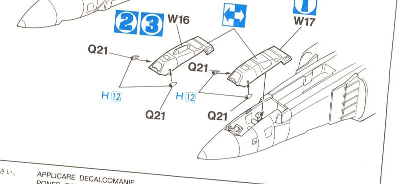

The aircraft had the flat underside camera housing. The rounded type didn’t appear until later block numbers. Is that what you are asking about?

As for the housing, here is a picture of the kit instructions. I believe it would be option W17 on the right hand side.
Thanks
The correct one is W16. That one is the older flat panel used. W17 came out in later block numbers. I don’t have my reference book available so I can’t tell you which serial numbers had the newer rounded panel. Use W16 as that is the correct one.
Happy modeling and post pictures when you start the build.
