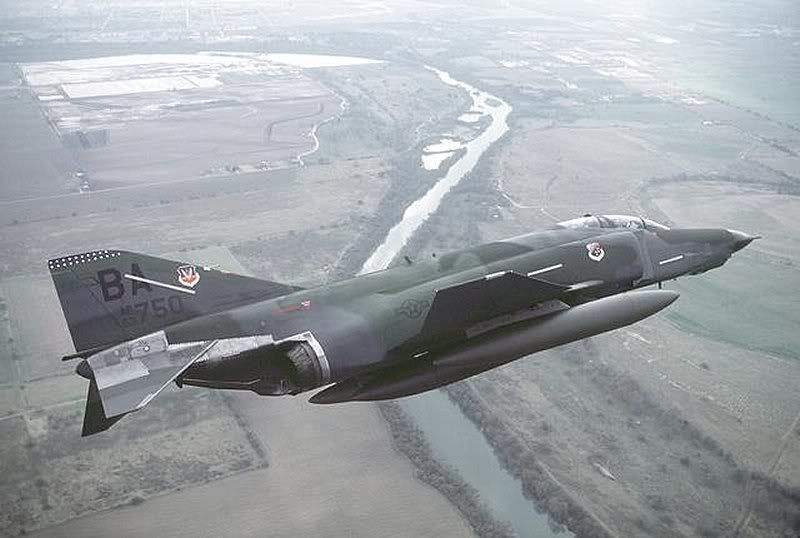

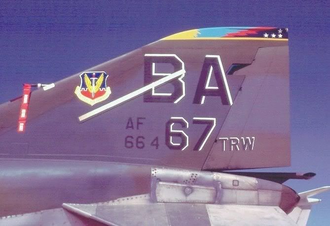

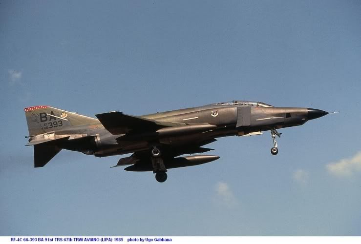

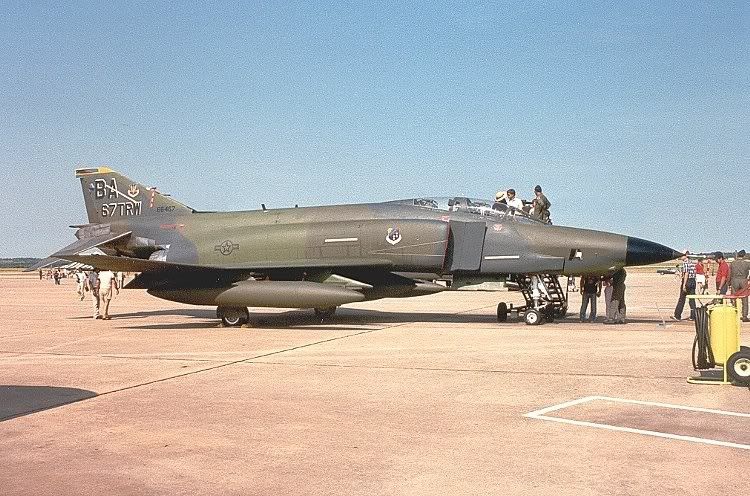

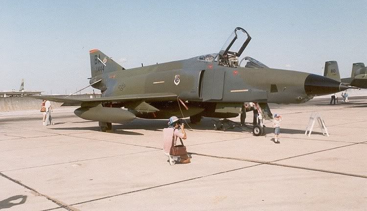

I hate to stir the pot, but I painted Phantoms back in the mid-80s, while serving with the 67th TRW, 67 EMS, Bergstrom AFB TX, and the Euro 1 we were painting, was not a mirror image of the top, and the 34079 Dk Green stayed the same. We only changed the Tan 30219 to 36081.
We constantly were painting our fleet of over 80 Phantoms, year-round, and it got to the point, we had the scheme memorized, with no need to refer back to the T.O.
Here’s a couple of pictures of “my” Phantoms.
The BA tail code were our birds.
Leon
Actually, there were two EURO schemes, EURO 1 and EURO 2. EURO 1 was identical to SEA Wrap Around 2 with the gray being FS 36118 in place of the FS 30219 tan. The EURO 2 was identical to SEA Wrap Around 1 with the gray being FS 36081 in place of the FS 30219 tan. FS 34079 and FS 34102 was constant on all SEA, SEA Wrap Around and EURO paint schemes. I still have my copy of T.O. 1-1-4 which shows both schemes of Wrap Around and EURO.
EURO 2 became the basic scheme due to a shortage of FS 36118. It seems the B-52 and C-141 had a higher priority for use of that color.

I will go with the Euro 2 version with the gray FS 36081 and use the paint scheme supplied in the above post by mkhoot, and also suppied by berny13 in my other post.
