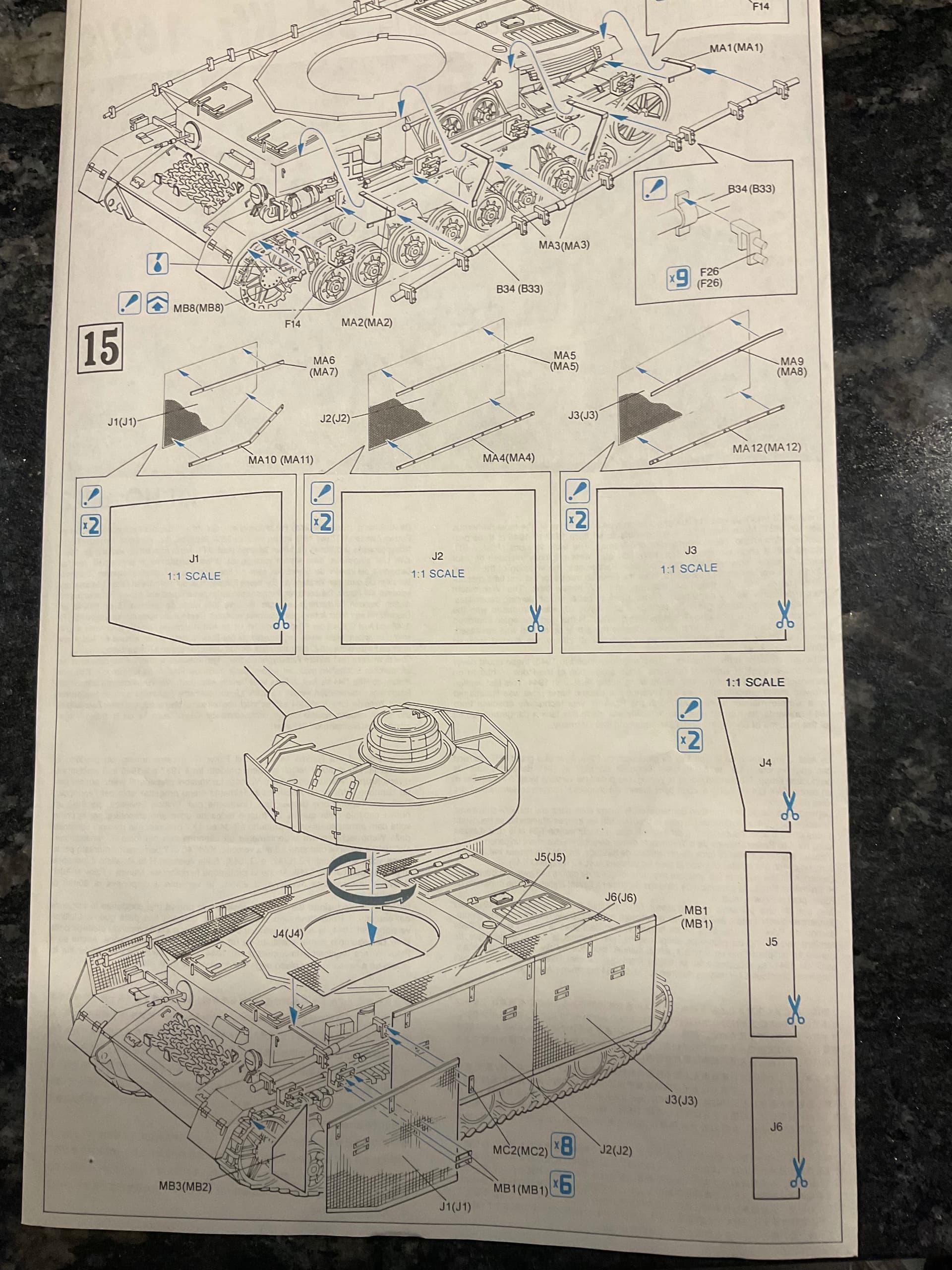

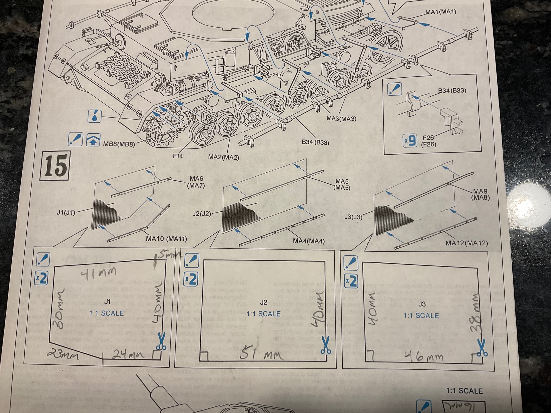

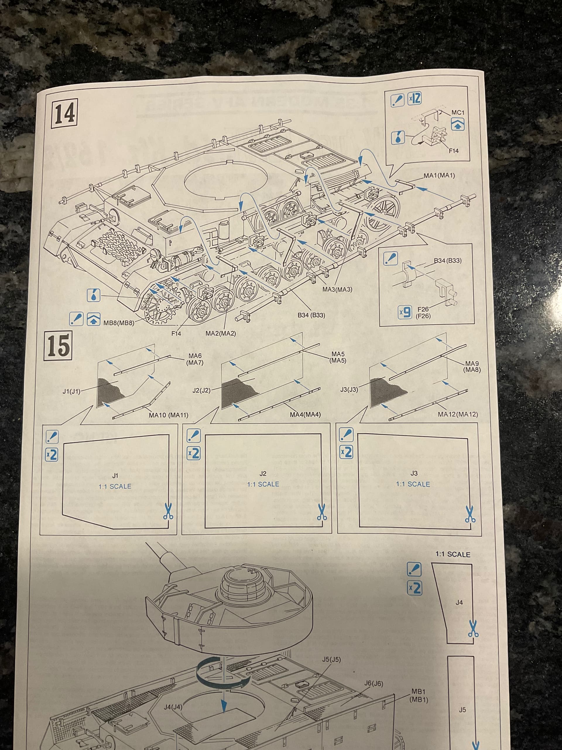

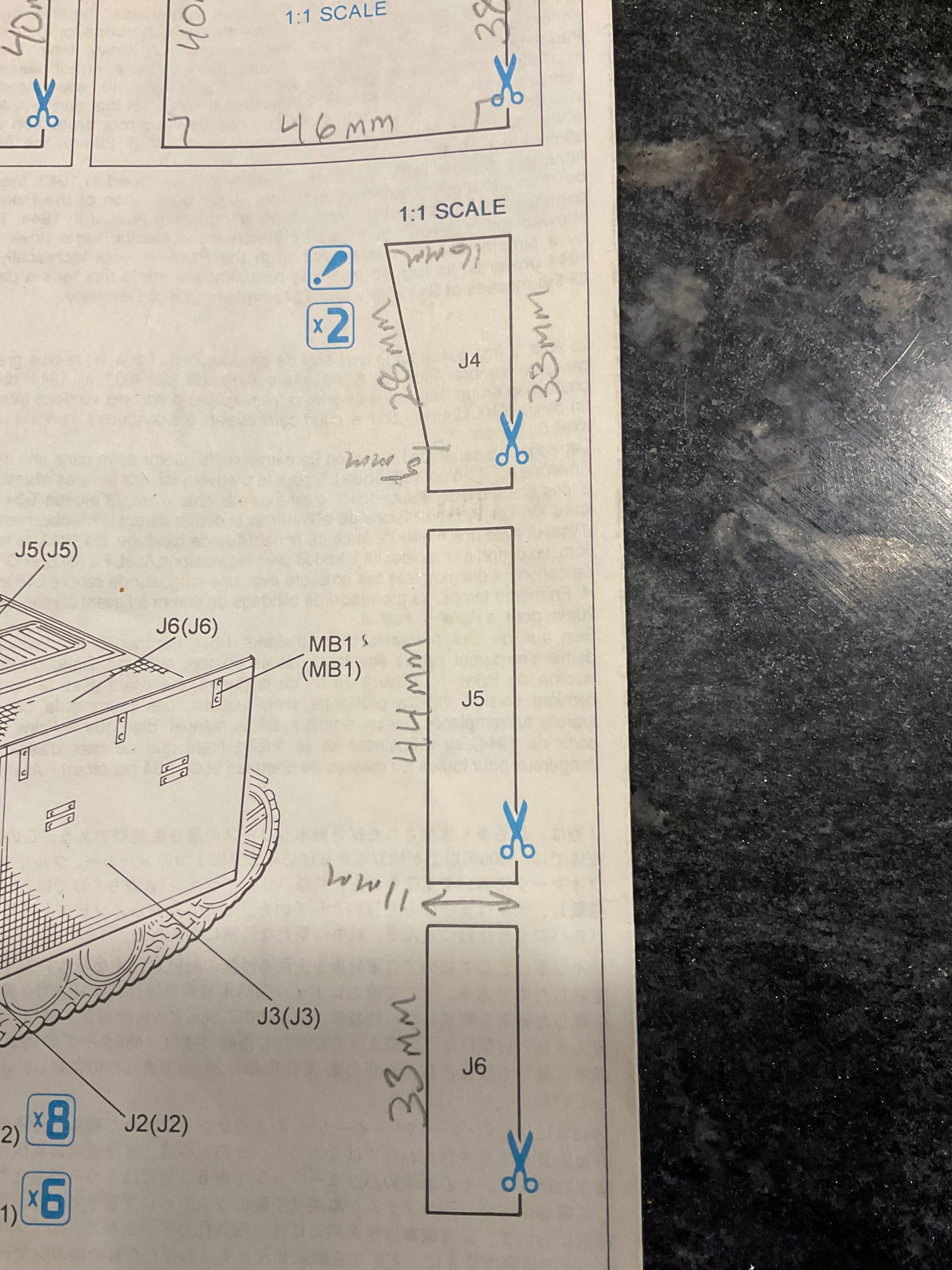

Ok, so try as I might, I wasn’t able to do a proper document scan for this. Here are some pictures of the instructions with some measurements for 1/35 scale.
The middle piece is all 90 degree angles, along with the bottom corners of the last piece. The first piece has only the bottom and top corners square that meet the middle. The top rail of the first piece has only 5mm square before it has a slight downward slope.
As far as the mesh, in 1/35 household window screen is close to scale, so you would need smaller for 1/48. There are multiple vendors that have fine p/e mesh available, or perhaps you can find another source of fine metal screening. I used to have a bunch of water filters from industrial coffee makers that had a very fine metal screen. Very useful, but sadly I’ve used all I had already. ![]()
