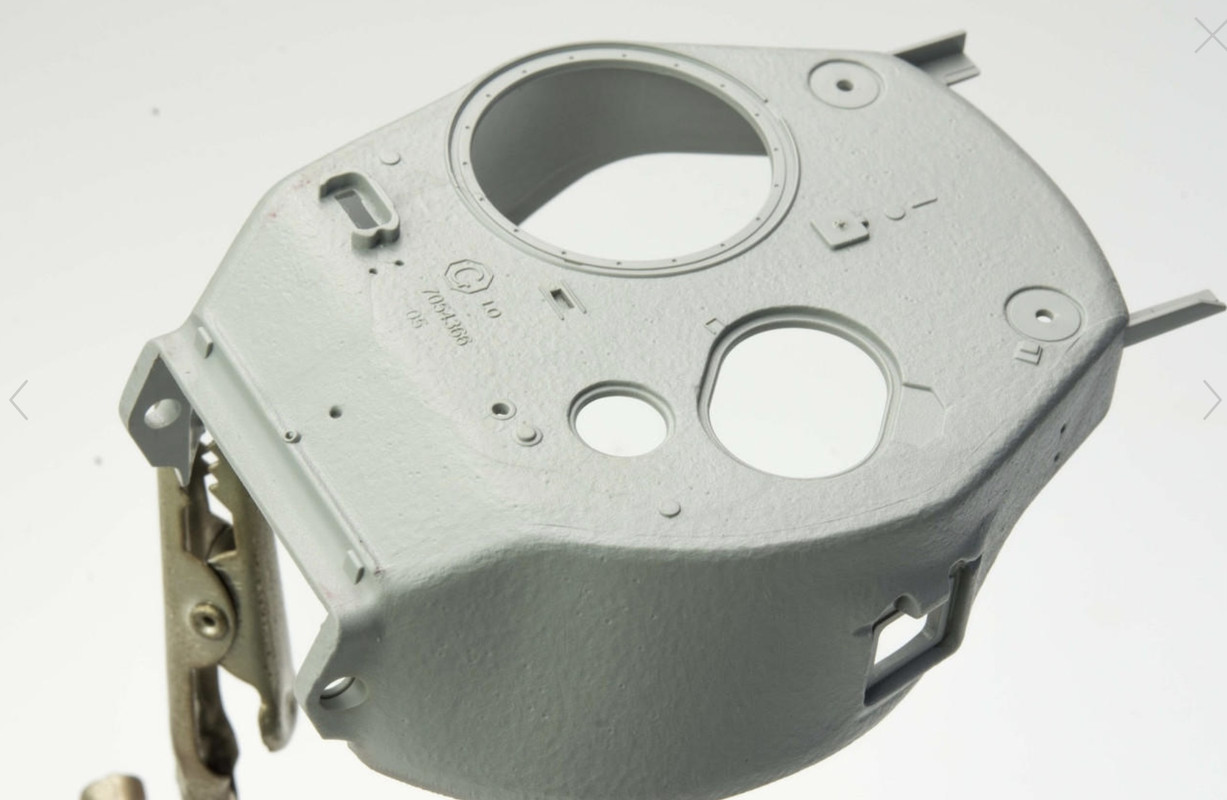

I’ve noticed recently that some manufacturers put their name and copyright logo on the model. Is this common? I was gifted the Sherman Easy Eight and noticed the logo dead center on the turret just front of the commanders hatch In raised letters. It’s a Rye Field model. I managed to sand it off it seams like a really bad place to put a logo.

Now, that raised marking on the top of the turret on the RFM Sherman turret is an accurate representation of the original manufacturer of THE ACTUAL TANK. That is on the real tank, it is not RFM’s logo.
You spent your time sanding off the foundry casting markings found on the actual tanks.

Did it actually say “Rye Field”??? Or was it the casting info like Rob referred to which supposed to be there.
I was the actual company markings from the kit manufacturer with the circle c representation of copyright of the kit if it was a manufacturer of the full sized tank I would have asked the forum about this currosity
That’s crazy,actually offensive that you actually have to sand off a company logo.
Does look like a foundry casting mark Rob mentioned.

Here is the RFM kit turret. If you sanded off that mark in front of the TC hatch near the spot lamp and sifgt post, that was not a model company logo, but an actual detail… like said a above, those are foundry casting marks
a better view of the kit part here

The foundry casting mark on the RFM kit is the letter “G” not “C” for the Granite City Works where the actual turret was cast.

I’m gifting the model and reordering to correct the error I am also concerned about authenticity at first when I saw the indentation of the manufacturers mark as you indicated, I was a little, perturbed, thinking it was another manufacturers mark from the kit, and it ticked me off. in retrospect I could’ve done more research, but I have yet to find a good photo of the top of the tank turret for this particular model. When I do research on the Internet, I see primarily kits rather than the real image from the war it makes it difficult to do research strictly on the Internet I have several books on tanks, but not specifically the easy eight edition. on the side topic I watched a video yesterday of a man that did research on the origins of the nomenclature "easy eight"4 I found that particularly interesting. There seems to be a lot of diverse opinions on where the easy eight name came from and it’s generally not what people think at least according to the research he did, and he did extensive research
The problem will be that this particular model kit was created by copying the markings off of a surviving tank. That specific marking might be unique to that tank and is just representative of the casting markings found on similar tanks.

If you look at photos of turrets and hulls, there are often raised numbers and letters from the casting process. You are right in that they look like manufacturer part numbers or copyright information molded to the surface.
Way back when, kit surfaces were molded smooth. Now, they have texture and include many of these raised foundry casting marks. Back in the day, the original super detailers would carefully shave off the kits’ part numbers off of the sprues and replicate random foundry casting marks on the surface of their models.
The numbers weren’t accurate, but representative of similar marks.
Keep the kit, finish it, and put some stowage, like a knapsack, a helmet, a bedroll, etc, where the casting mark was.
