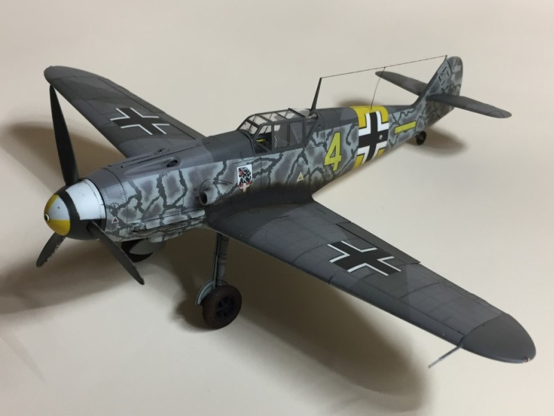

I used the 2mm Molotow pen for the fuselage camo on this 1/48 Eduard kit.
Sprayed the green, masked with the pen, sprayed the light blue, removed the mask and sprayed the grey mottling. Quite happy with the result.
One downside I noticed is the mask was difficult to remove, I think it was because of using laquer thinned paint (Gunze Aqueous + SLT) which has eaten into the mask. Next time I will apply definitely at least two coats with the pen.
Another downside is after use the stuff on the tip gets cured and it is impossible to use the tip again. To give the tip a good clean after use is definitely a good idea - if not having replacements.
