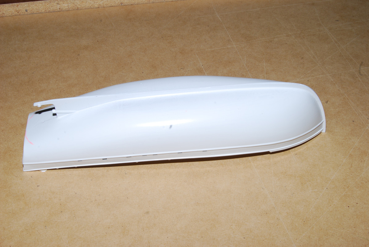

Just about done with the Clarmont, and starting another Lindberg ship kit, their 1:60 Shrimp boat.
Here I have the hull sides glued together and the deck painted.
Then, gluing deck inside hull.
The kit depicts a wooden hull boat, with raised lines representing the plank edges. I wanted to weather this boat into a real rust bucket, which means a steel hull. So I had to remove all those raised lines deliniating the planks. I scraped them off, instead of sanding, holding my X-acto knife nearly perpendicular to the surface and pulling it along. May need a bit more sanding and another coat of paint.

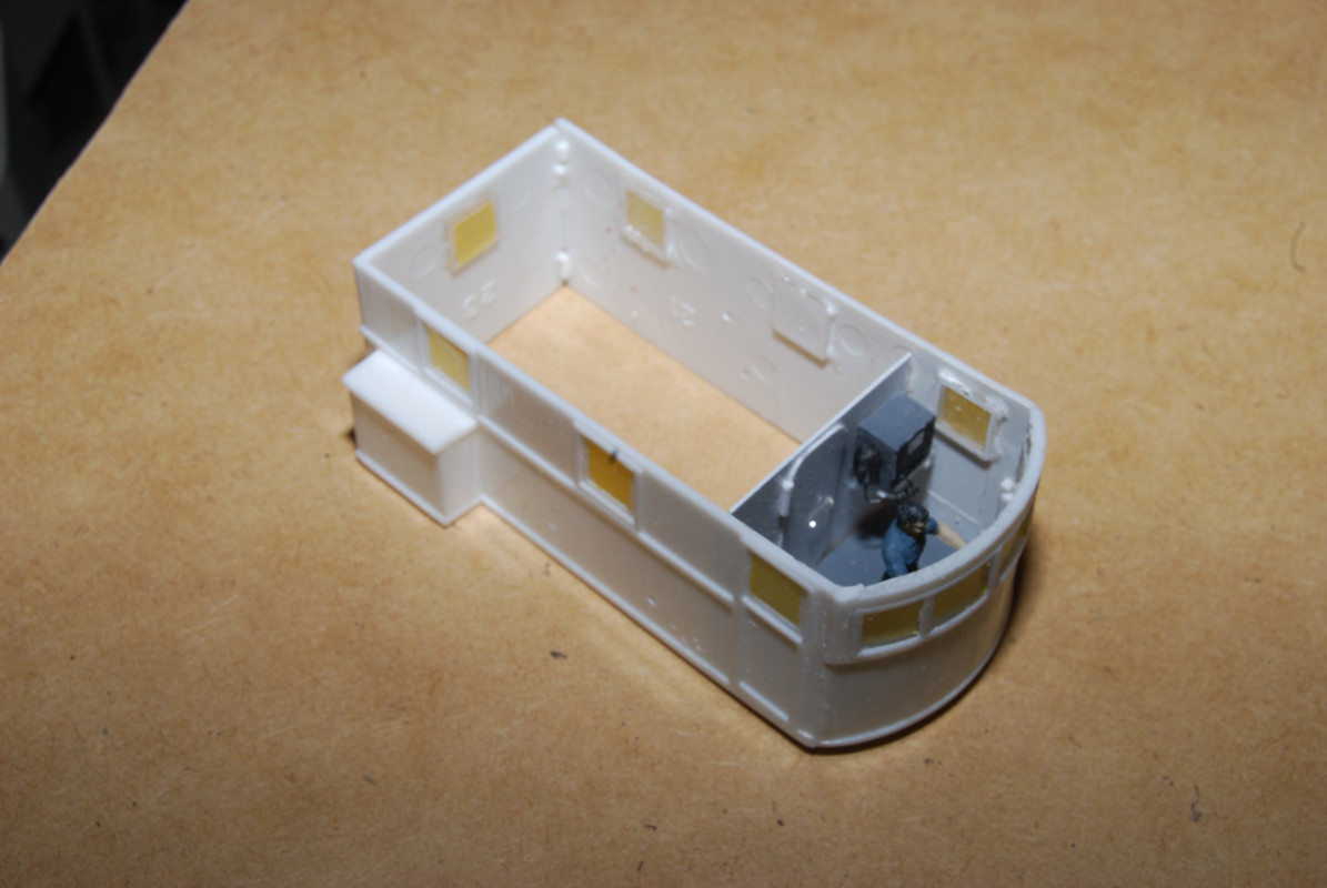

Adding detail to the bridge. Came with wheel and helmsman. I added rear wall (with door) to separate bridge from rest of cabin. Added radio on shelf and engine control

Never seen a shrimper with only one radio. Even Viet-owned ones.
There’s always a dedicated unit on NWS, a Marine VHF, usually an HF, and at dead minumum, a dedicated marine radio phone set. Anything in the last 20 years will have a satphone set, too.
Probably ought have a GPS unit, too. And, typically, two depth sounders. And at least one nav radar.
Depending upon the era, those boxes run from the small to the size of a microwave.
Oh, and a coffee pot [:)]
All of which would be hard to jam into that very nice pilothouse you have built.
Bill :

Yeah, I had intended to add a few more details, but that is a really small bridge. I had intended a chart table with a chart of some Louisiana area, but not enough room. I have never been aboard a real shrimp boat, so I was guessing on what might be on the bridge.
