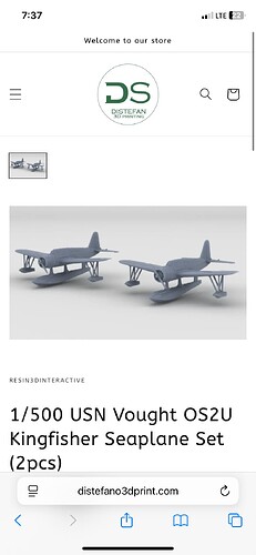

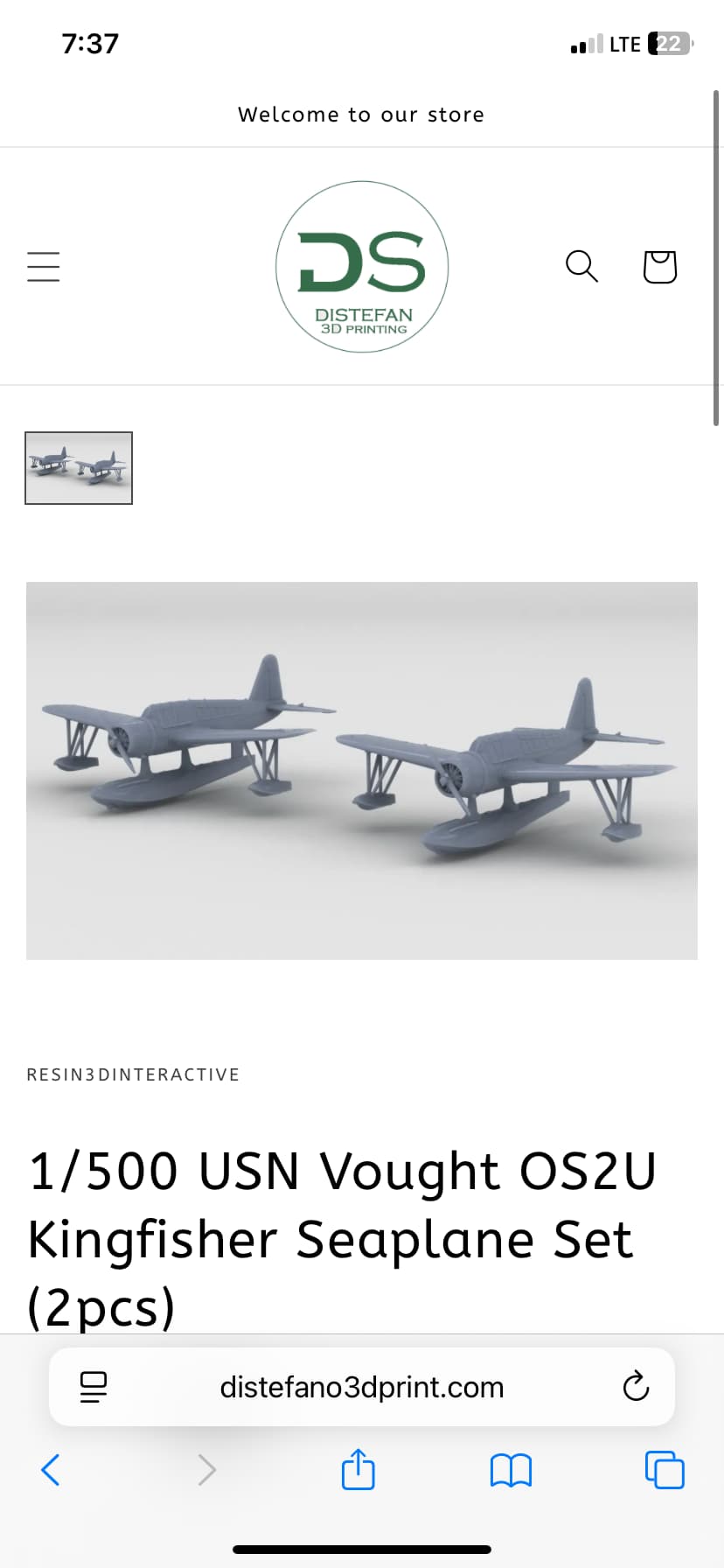

I found 1:500 PE catapults and resin Kingfishers, which I was pretty excited about.

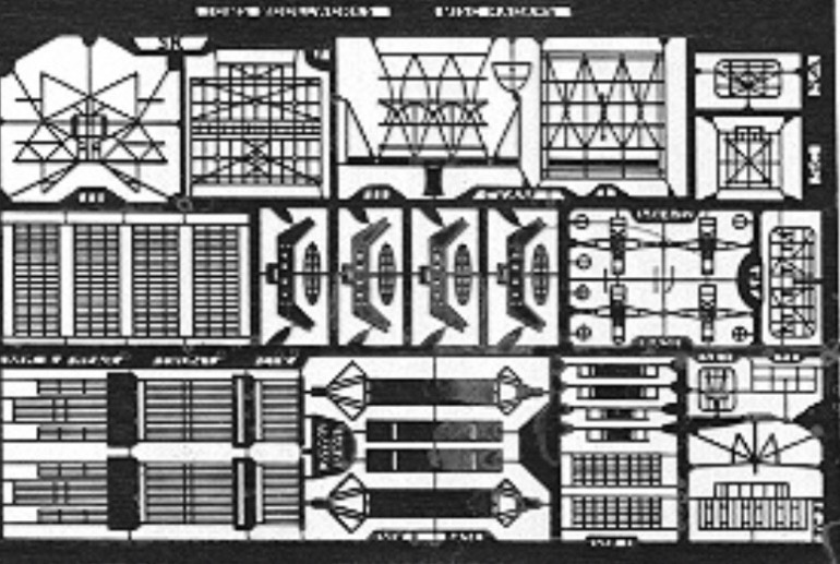

Tom’s Modelworks also has PE radar stuff but I’m not sure if this stuff is compatible or how to research this as the exact PE radars aren’t specified by Tom’s.
They also have PE 3 bar rails. I hear PE rails are tough.

Welcome to the forums PoisonousFrog. Great choice of model. The 1/500 scale is a challenge to dress up, as there are not a lot of parts available. Distafan 3D and model monkey offer some 3D printed turrets, guns, props anchors, etc. The are photo etch railings and radars from tom’s model works. Use fine ez line for your rigging. There are easier to brush acrylic paints and sets from AK Interactive, Mission Models, Squadron, etc that outperform Tamiya when brushed, and have the exact colors you will need for measure 22. Check out shipscamouflage.com for your measure 22 specs. Most of all, have fun and build a great model.

Edit: Yep, Distefan is where I was lucky enough to find the 1:500 planes!
