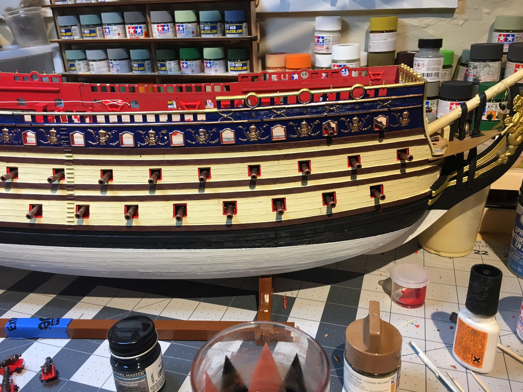

started the kit a year ago, i keep dipping my toes into it. now that i can post pics , here are some of the progress. i used the brass cannon kit sourced on ebay. lots of research from this site on this one. bummer on the scaledecks though. some of the deck sections i glued delaminated and came up in parts. i used spray adhesive and clamped best i could. not sure what to do at this point, but i will keep plugging at it.
Now:

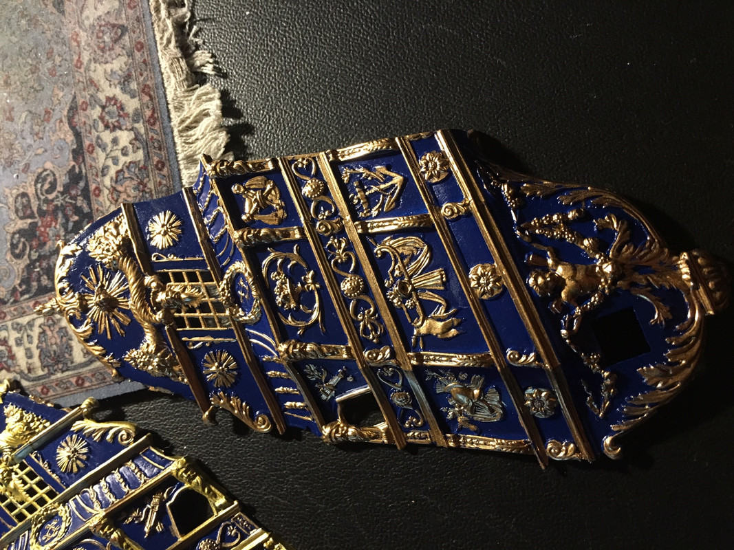

That is the reason I don’t use Those aftermarket deck kits. I make my own from Skived basswood pre stained and cut to fit one plank at a time. Yes, tedious but it works for me flawlessly. I love your Filigree work .
You are on a boat in your Avatar aren’t you. Gee, just like Dodgy ! Very Calm First mate too! If you don’t mine I would like to make a suggestion if that is the Heller Kit! Replace all Mast parts and Spars with Wood dowels. The Main, Mizzen and Foretops are too flimsy to support much in the plastic!
hi there, ive been following your work on this site for a while. i was turned onto using the gold paint pen from the craft store from one of the members here… needless to say made it 10 times easier and more accurate than fine brush for most of it. i also read about the spars , even though it will be a while until i get there i can see from the bowsprit that that will be the case. it is the heller kit and ive also found the IMAI instructions online as well which are a great cross refference.
yes the boat was three years ago , and the first mate has gone back to the union hall in the sky unfortunately. have to update the avatar with the "new " boat and the relief mate one of these days.
