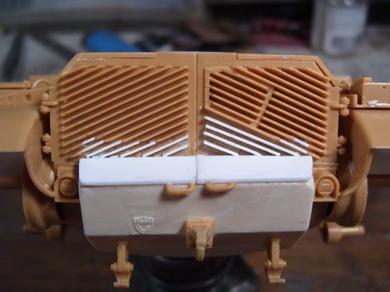

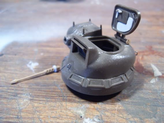

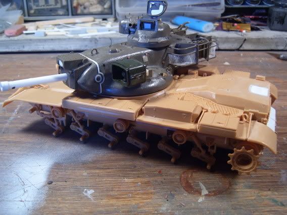

Here is my latest, a late M60A2 w/CBSS. I used the Esci M60A3 hull (since it is the most acurate available) and Tamiya turret. I got the CBSS bulge for the rear from another modeler. Added new spot light and mount from an M48A3, new barrel without bore evac and correct length (kit one is 3mm too short), added cast texture to turret and commander’s cupola, forge mark and casting numbers to turret side, clips for tow cable, cut mud relief holes in sprockets, etc., etc. The Tamiya turret is not that bad to start with. The Tamiya hull is a dog.
Here it is.
Overall
CBSS bulge on rear of hull
Turret
Commander’s Cupola
Other parts
Looking great Gino, I like that turret for some reason…
Thanks, glad you like it. It is an interesting design, in an ugly kind of way.

CBSS is Closed Breech Scavenger System. It was used to clear the breech of smoldering embers after firing. The tank used combustible case ammo (like the M1A1) and some pieces of the case would remain in the breech. The CBSS was a compressor and a couple air tanks housed in the rear of the hull. The pressurized air would shoot a couple 1500 psi puffs into the breech to blow out and clear any embers after firing.
