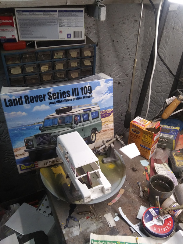

I am using Revell of Germany’s Land Rover Series III LWB Kit #07047. I have been looking at paint colors trying to find a close match to the Land Rover Light Green without having to resort to ordering paint from overseas.

I’ve got that one on the bench waiting on paint as well. The instructions call it blue and I got ahold of 3 square bottles of blue. Zeropaints makes the right green but i can’t find it
https://www.zero-paints.com/Land_Rover_Series_III_Paints_30ml--product--7974.html
Tamiya IJN interior green is close
Thanks John! I wanted to find a close matching color local instead of trying to buy it from overseas. After searching at a hobby shop, I found a color that may be a close match. Now to try it out on a plastic spoon with grey primer.
