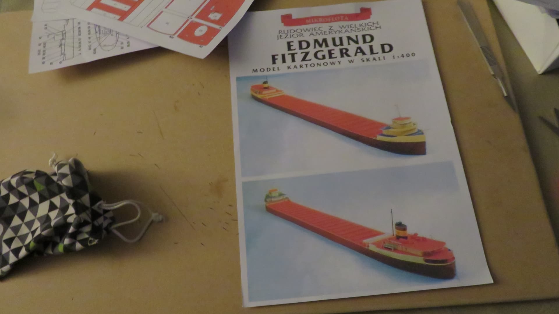

What kit are you working with? Maybe you could post some drawings from it?
I’ve built a lot of paper models, maybe I can help you if you run into any problems.
Most paper ships have a keel and bulkheads that have to be reinforced, usually with 1mm stock - finding good material for that is well worth the extra effort. Many times the keel is printed in two or three parts, because it is too long to fit on one sheet. It’s good to take those sections and glue them on a large piece of reinforcement material to form one part - this way the model is stronger and straighter. With a long hull like that you have to watch for straightness all the time - warps and bends can be corrected before the glue sets for good.

This is the kit.
It is not a download. But the postage was very reasonable. I believe the whole thing was less than ten bucks.BTW, the buff areas are printed at two high saturation. I intend to try copying the pages and editing those areas to a lower saturation and lightness.

Thanks a lot! JSC is a good company. If you edit the parts it would be important to find good quality material for printing.
For thos who would like to take a closer look on what’s in the kit, here’s a link:
