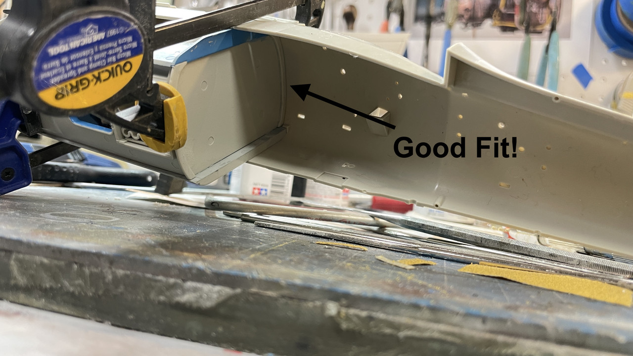

Today began with gluing the interior onto the right hand fuselage side. I used some Quickie clamps to hold it tightly in place. The fit was pretty good so far.
This view shows how nicely the rear of the cabin fit the fuze side. I forgot to put in a piece that lay inside the nose one each side. I had to stick it to a sticky picker and slide it into the narrow space, and glue it. No harm no foul. I did glue it to the other side that wasn’t attached.
I then attempted to fit the left side in place and was greeted with terrible gaps. If I got the top to fit tightly, the bottom was wide open and vice versa. Two factors were at work. With the cabin being a completely enclosed structure, you can’t look and see if it’s aligned properly as you could when it was just on one side, and I suspected that the cabin bulkheads were just too wide in spots preventing closer.
Here was the bottom: Notice the bulb in the front. That was an option that I decided after it was all glued in that I didn’t want to use it since I wanted the FLIR option on the front end.
And this was the top! Ugh!
This was totally unacceptable and made for bad fits of the engine housing and the front fairing.
I selectively reduced the outer edges of the bulkheads and kept trying the fit. I finally got it as far as it would go, so it was time to glue. But first, the rear landing gear has to go in because it’s trapped by the two fuze halves.

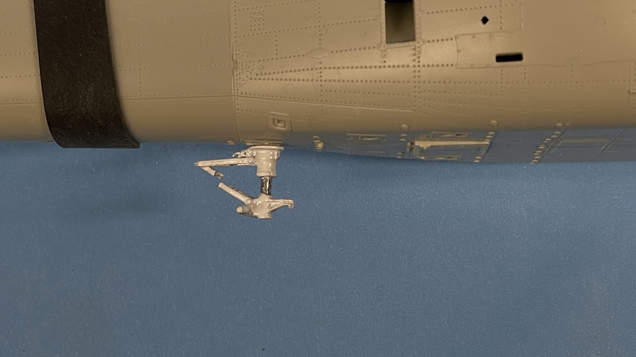

I painted the gear silver only to identiy that it was probably white. I first tried bare metal foil for the oleo strut, but scrapped that and used Molotow chrome brushed on. Meanwhile, the scissors link broke. I glued it together once, and it broke again when I was fussing with the foil. This time I drilled and pinned the scissors joint and glued it again. This time reinforced with thin CA.

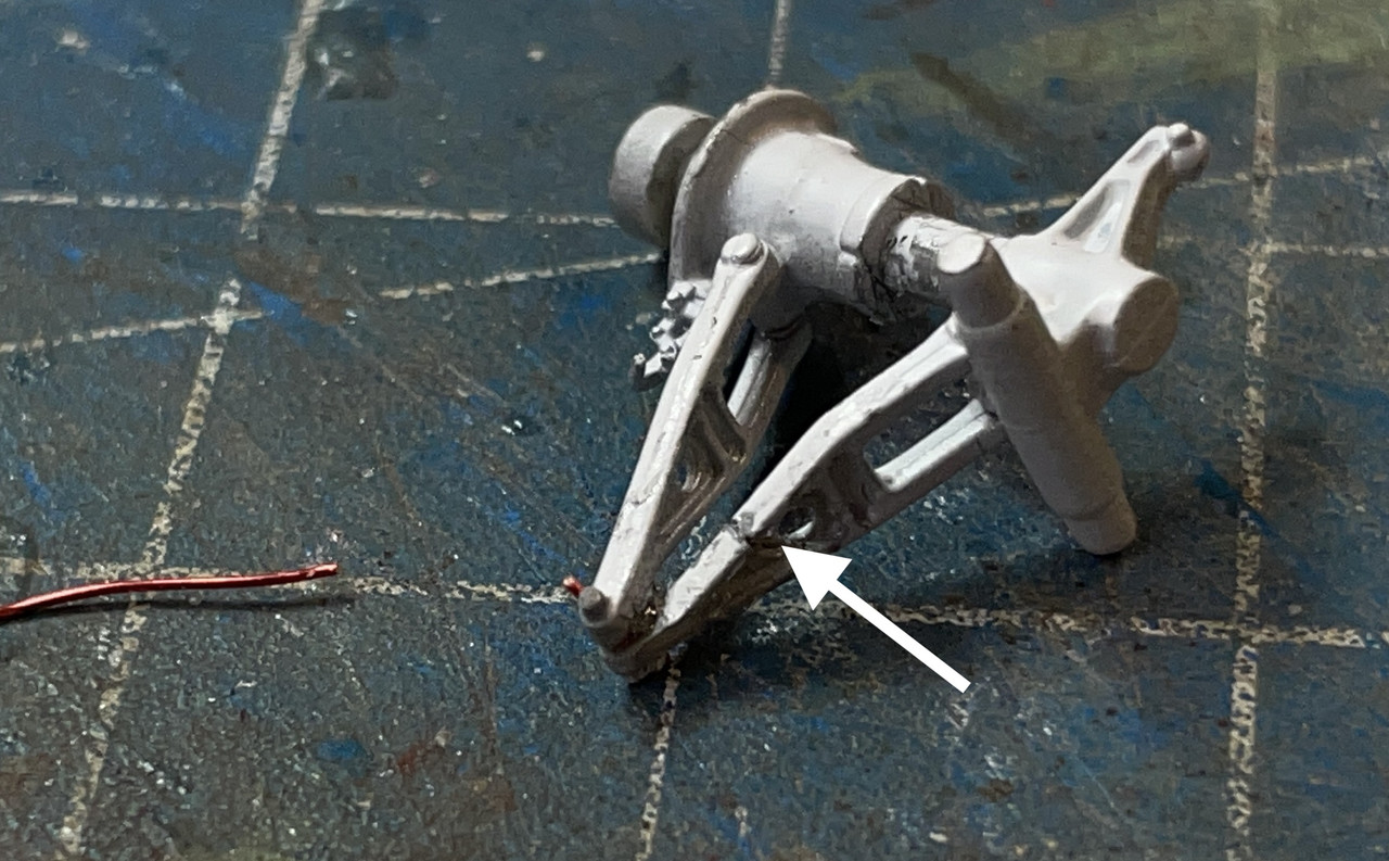

But then, disaster struck again during all my manhandling when trying to close those pesky joints. Another piece of the scissors broke in another place and got lost.
I’ll have to scratch-build or 3D print another scissors. Annoying! My UV 3D printing resin is tougher than styrene… or at least the Kitty Hawk styrene.

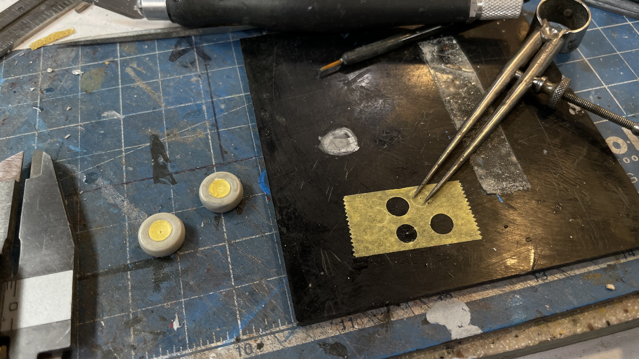

While the paint on the gear was drying I assembled the wheels and made some masks for the hubs. I use a small machinist dividers with one point ground to a sideways chisel edge. I measured the diameter with the digital calipers, divided it in half and used this setting to set the dividers. I added a dab of Molotow Liquid Mask to cover the tiny hole from the dividers’ point.

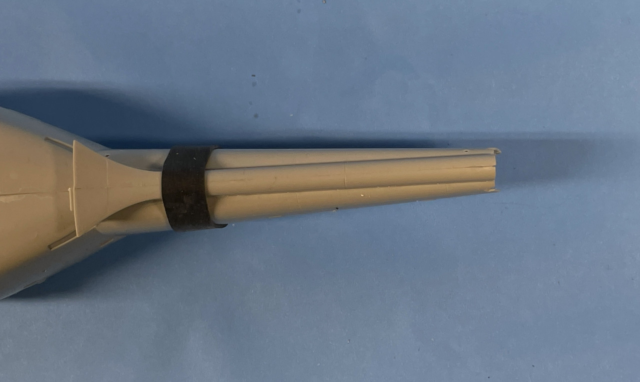

The movable part of the tail boom gets glued together now, but before you do you have to captivate a actuating cylinder in two slots on either side. I didn’t like the depth of the plastic lugs so I added some 1/32" phos-bronze.
I got started on the ResKit tail boom hinge replacment. It’s a pretty complex little project including faux pulleys with wire simulating the cables that control the tail pitch. You have to remove material on both the fixed and movable parts to create proper space for the more detailed resin parts. And here are the results. I used a combination of #11 blade, micro-razor saw and an Xacto #11-sized saw to remove the plastic.
The hinge area had to be surgically removed to give space for the more detailed hinges on the resin parts.
Here’s the fixed boom with it surgery completed.
Lastly, here’s the first resin part that I’m preparing. You have to open up some slots in the part as well as cut it out of the sprue block. The resin is tough, but not that tough and you can screw it up pretty good if you’re not careful. You can see the highly detailed hinge parts that will fit into the newly cut holes.
Spent most of a long work session fixing a mess! You see I misread the instructions on “what to remove” on the tail booms. The plans showed the colored area and I read that as it needed to be removed… which I did yesterday. When I trimmed out the resin hinge bulkheads and fit them, this is what I saw.
That humongus gap was the material I erroneously cut away. You weren’t supposed to “remove” that colored area, you were supposed to “thin” it by .3mm from the inside. I neglected to see the decimel point and my ADD brain jumped to the wrong conclusion. The resin pieces were still supposed to sit between the fuselage styrene. They were just a little thicker, so the styrene needed to be re-shaped.
This meant I had to add back the missing material and dress it so it wouldn’t be noticeable to the novice viewer. Show judges would probably pick it up. I used some styrene strip held with both solvent cement and CA. I replaced rivet holes in the new parts.
I then shaved the new material on the movable boom so the piece would sit between the packing. On the fixed portion I have the hinge butting up against the fuselage.
With the both sides fit to their remade ends I was able to actually start building the hinge assembly. As usual ResKit is asking you to assemble and fabricate stuff that just about at the edge of my skill set. Lots of butt joints held by CA. The pulleys are almost microscopic and they expect you to thread some .2mm wire around them to simulate control cabling. I’m thinking about it, but may not do it. I actually hinged the parts with 0.022" wire and they work, but…and it’s a big but… the next parts you add prevent the hinge from working.
I glued the part to the movable boom and that’s where I had to stop. The folded boom would block painting of the fuselage and the closed side of the boom. I will have to glue it all in after the painting.
There were more gaps that need filling. I used a combination of a thin styrene and Bondic. I traced the shape of the open onto a piece of paper and cut the piece. It need more adjusting and then further filling.
Here is the gap filled.
Last thing up today was the tail strike bumper. This little assembly was one of those royal pains in the butt. If you’ve had the fun of watching “Rocco Sciavoni” on PBS streaming, you’d know that this was probably a “9th level pain in the ass.” He ranks them with the 10th level being a murder. This little job took 15 minutes or more.
You have to captivate the movable strut in the two holes and then glue it together. The triangualar shape made gripping difficult and the part kept rotating and coming out of the holes. I tried all sorts of things including taping one half to the bench so it wouldn’t be moving around. I finally got to a big sigh.
Once I got it together, putting it on the plane was not a problem. It could have been engineered differently since the part is not actually movable in the final install. It could have been slipped into a slot and glued.
