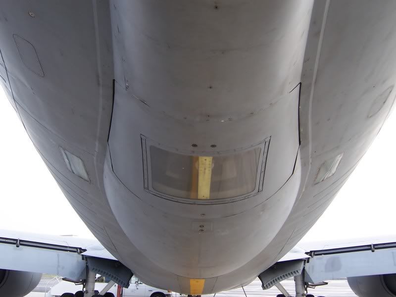

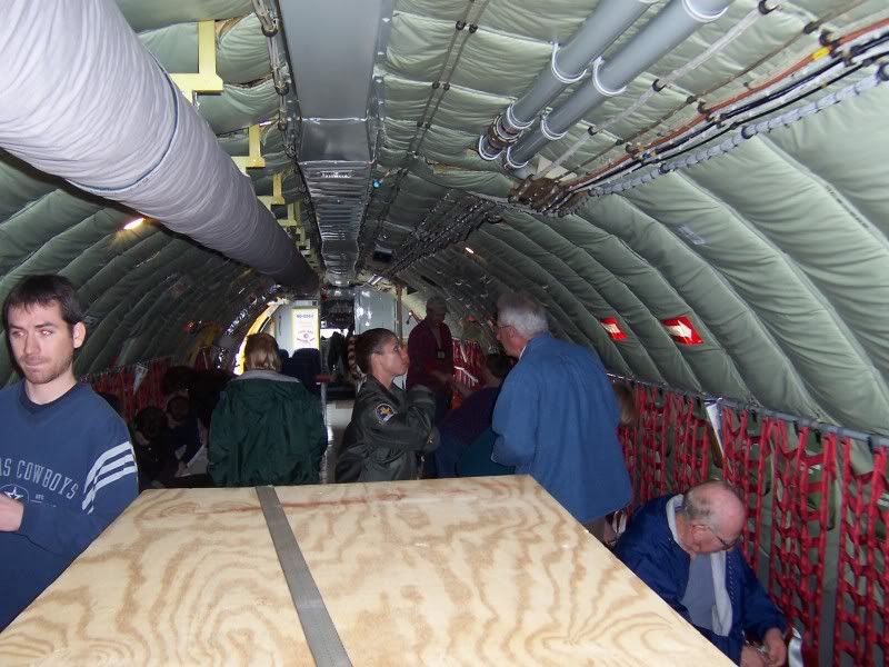

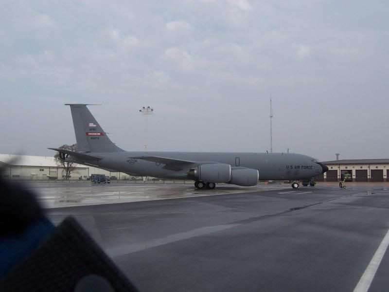

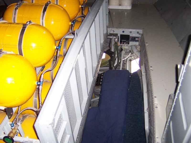

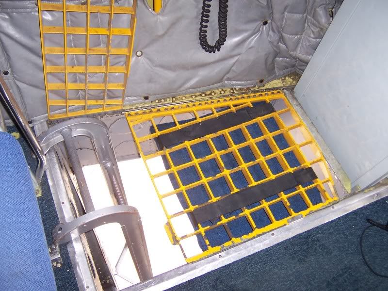

Here are some pics my friend took for me. Some of the staff from a local college were invited for a fly along. Needless to say, I was jealous.
Hope they help.
