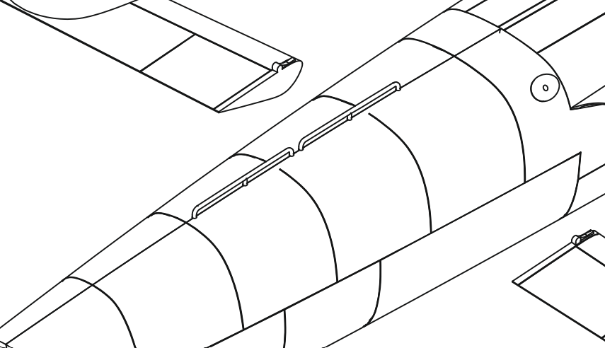

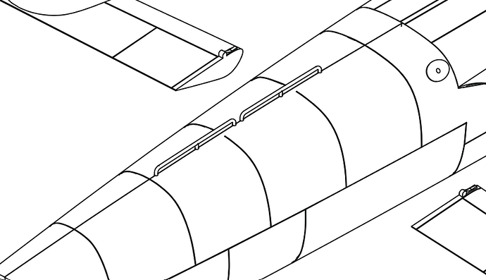

Underneath the fuselage there are two rails that go along the length of the fuselage,were these rails tubular or flat?
Unfortunately Revell don’t supply these parts so I’ll have to make my own.
Here’s a snip from the eduard kit instructions
So there tubular.

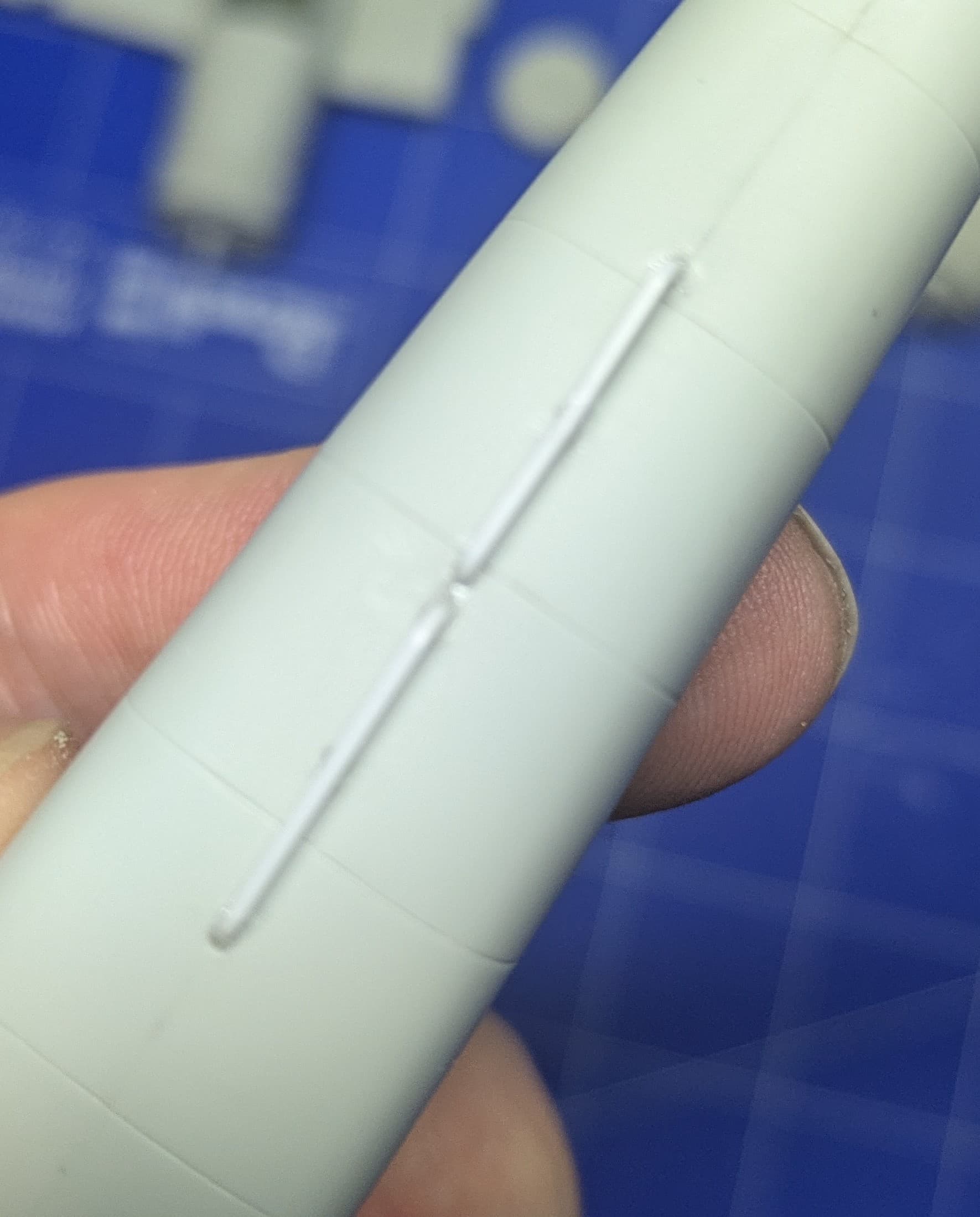

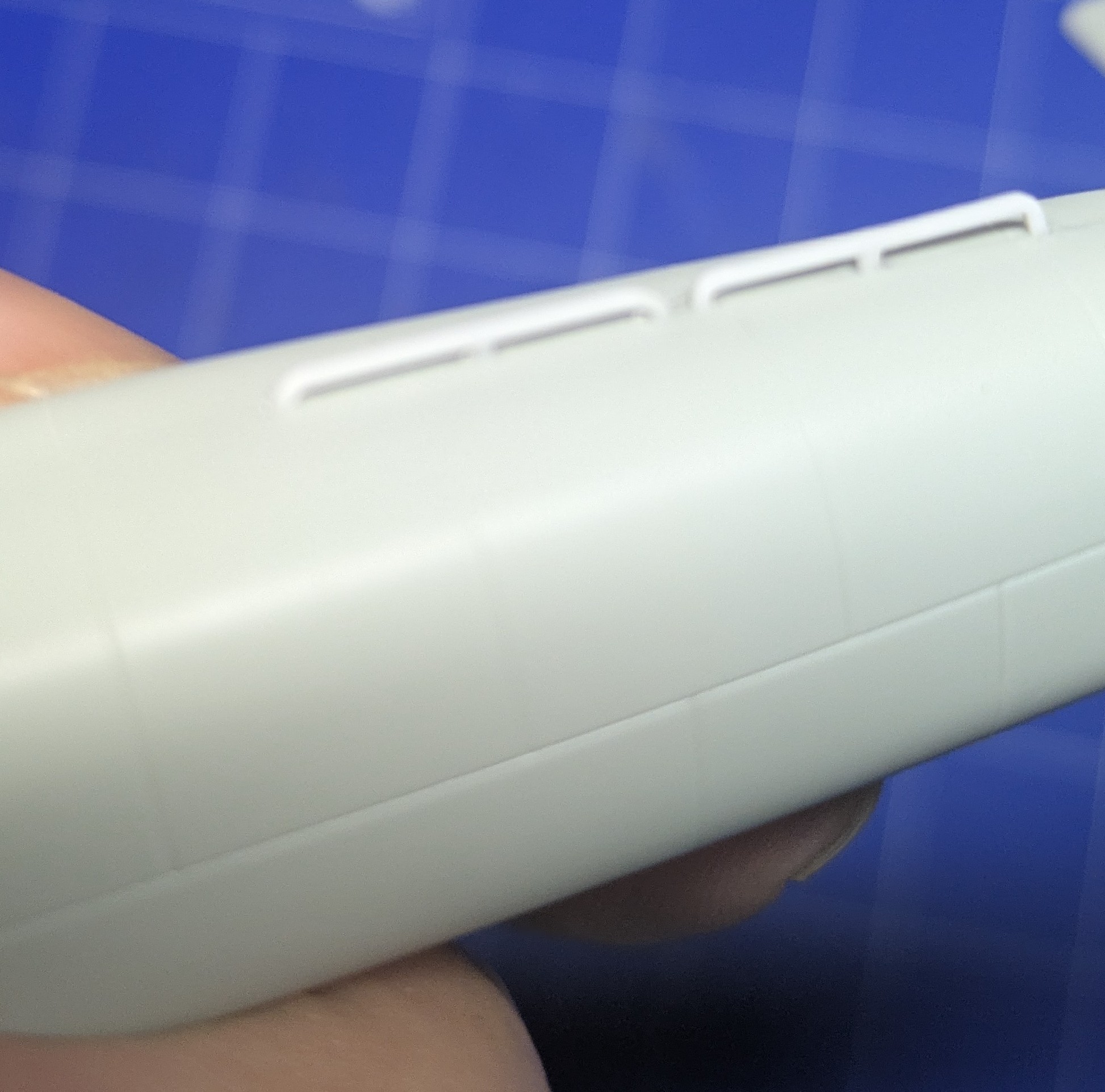

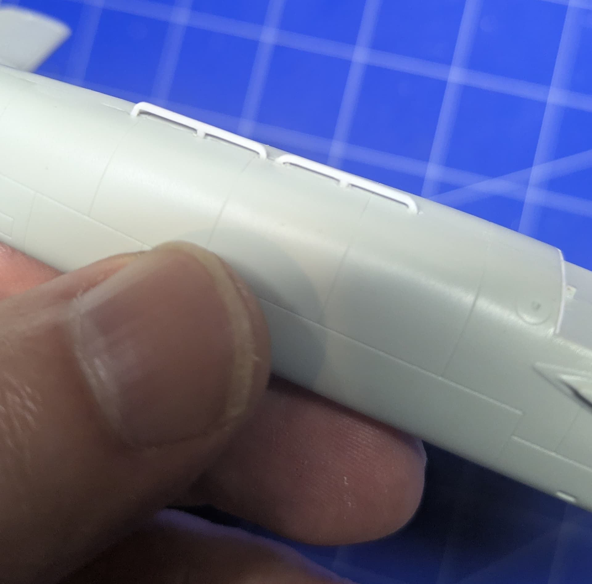

Scratched rails
Nicely done! They look spot on.
Fabricated and installed just 2hrs after getting @keavdog’s reply… Most impressive!
I could kick myself sometimes, I was looking at the sprues and what do I find the damn rails on sprue G, I must of over looked them when I was searching.

I’m sorry no one has told you but those are antenna aerials. They would be very discreet in 1/72 and not as thick as you have them. Indeed, in many PE sets, the entire array is provided in photo etch.
