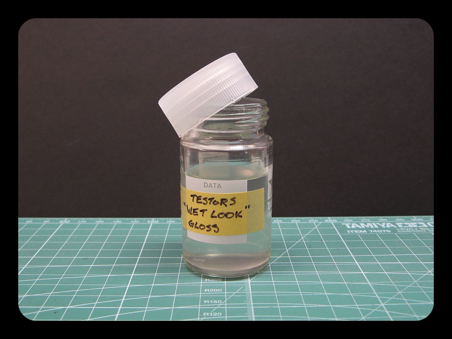

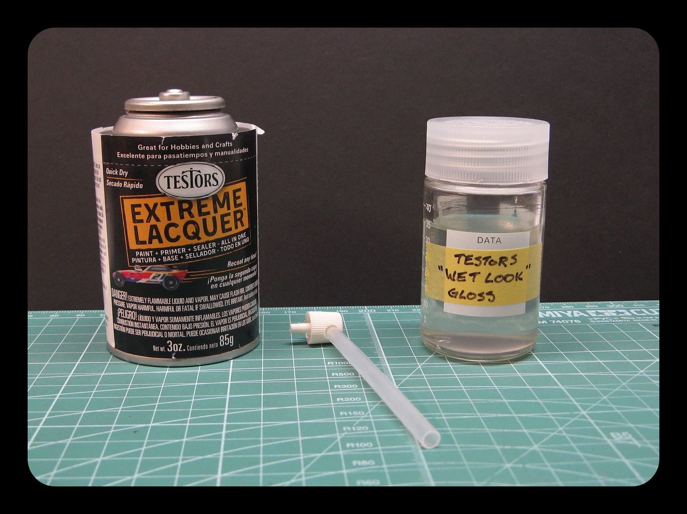

Here’s what I have for decanting my gloss coat and flat coat. Like Dayhut said, save the spray nozzles from old cans. I have some old Testor’s pipettes, they seem to fit the best at the nozzle opening, that I cut to get a tight fit.
I’ll shake up the can, point the tube into the jar and hold a paper towel over the top of the jar while spraying. Once I get the jar full to where I want it, I’ll sit the lid on top with a slight opening on one side and let this sit for a few hours to off gas. I do all this in my spray booth to vent the fumes btw. I’ll separate the tube from the nozzle and clean both with lacquer thinner, dry them off put the tube back into the nozzle and I’m ready to go for the next time.

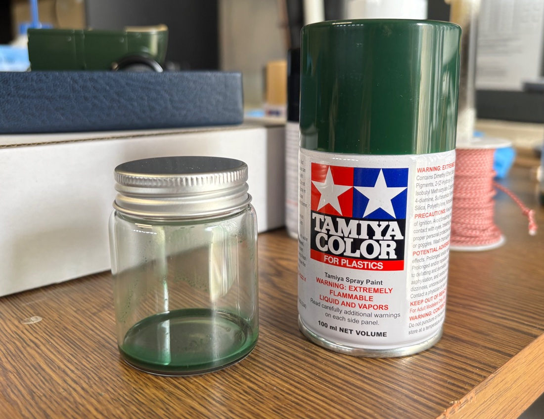

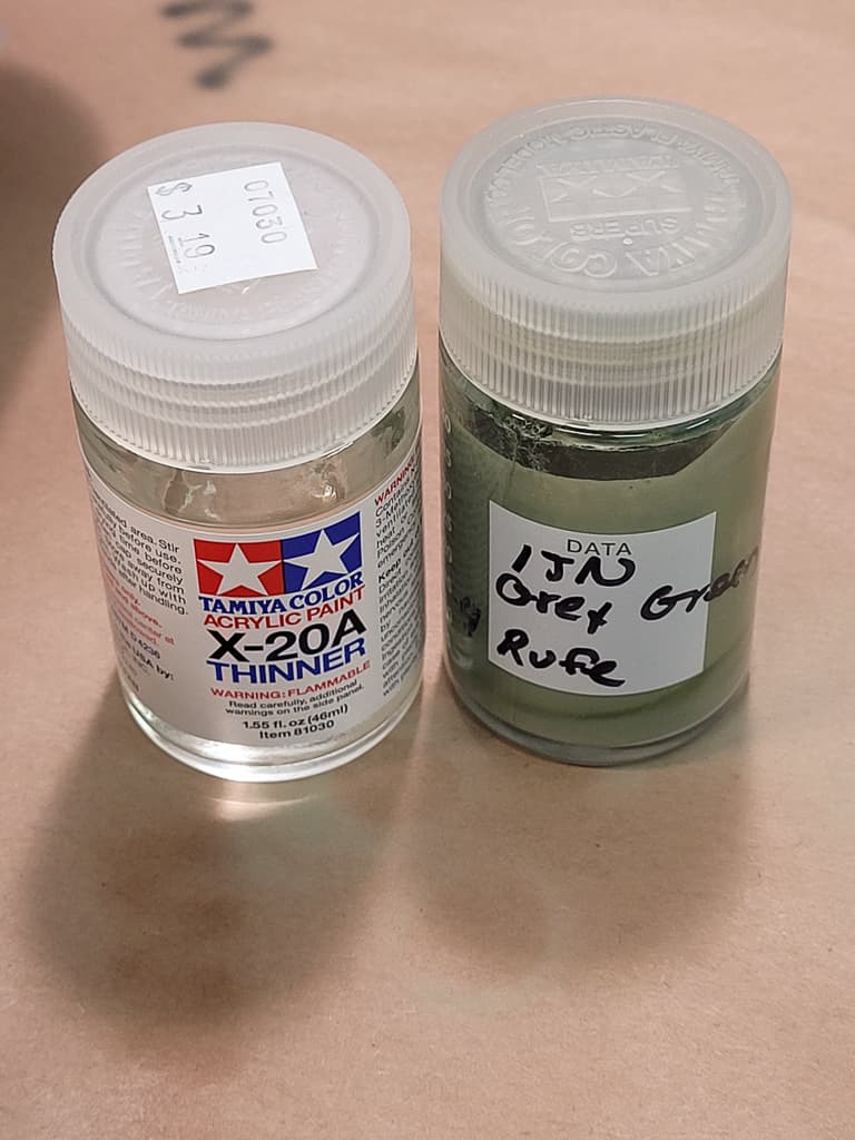

Nice Idea. Personally, I like the large (tall) Tamiya Jars. They sell them at my LHS for a reasonable price. They also seal well. The one in this picture with the paint in it had the paint decanted probably 15 years ago and it is still fresh and usable. Does not even look like it needs any thinner added, so how long you plan on storing your paint should be a consideration as well. The tall jar allows for the propellant to fizz out without overflowing (usually :wink:). I should clarify, It’s the same size bottle and the larger X20A thinner bottle. You don’t have to buy the thinner – they also sell just the empty bottle…
Those are the same ones that I use.
