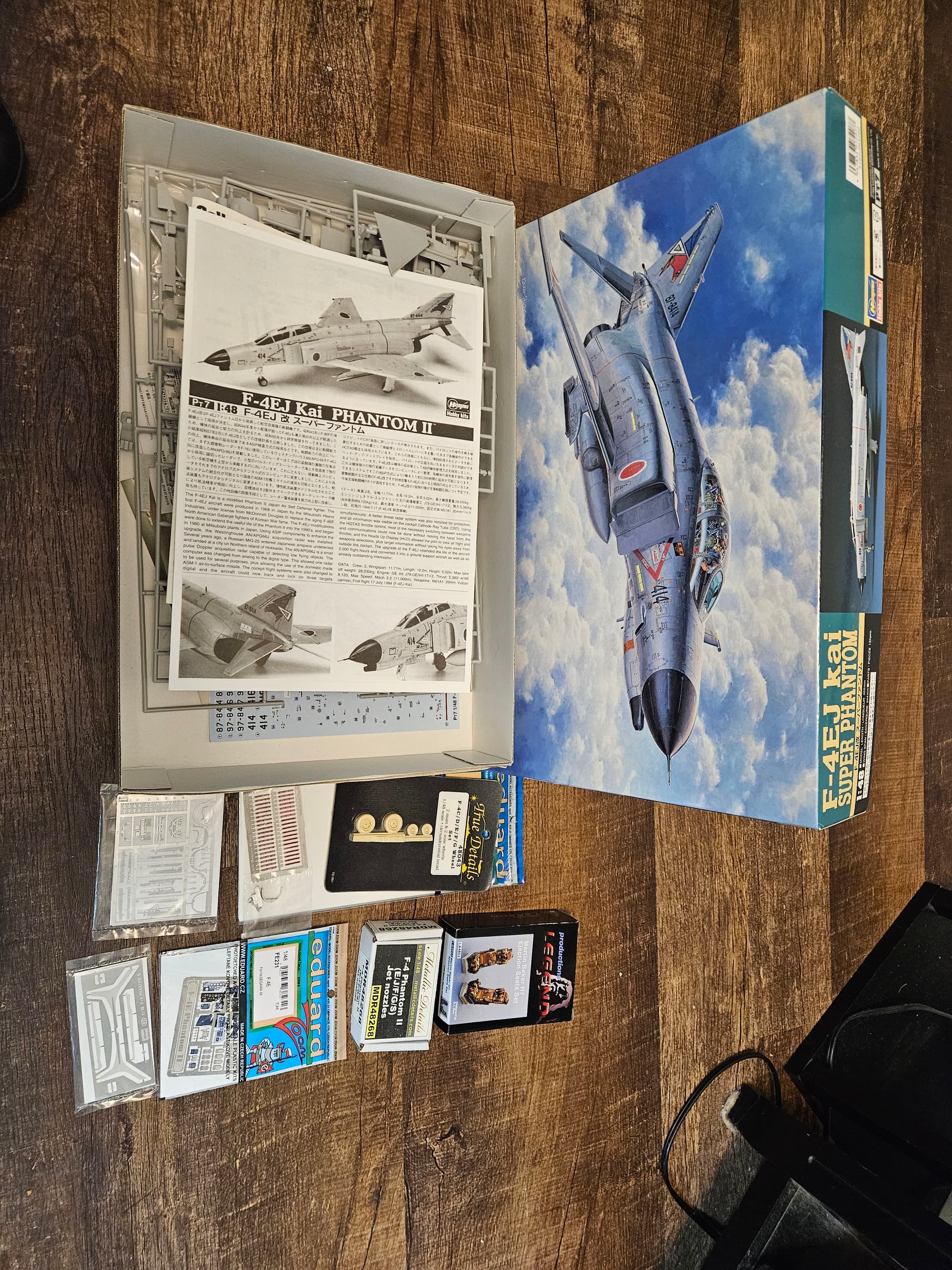

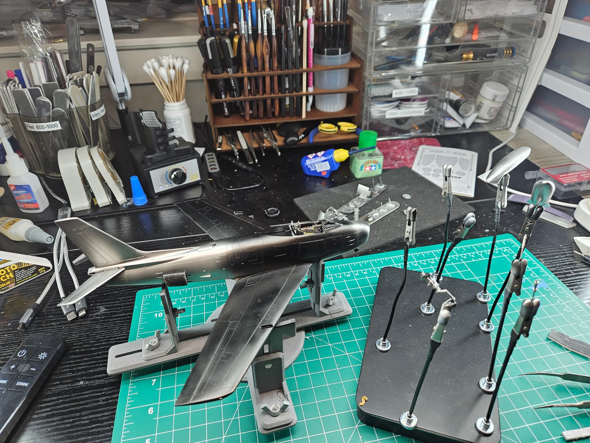

I’m waiting for paint to dry on my F-86 so I can do the other side and I thought I’d take a look at the F-4J I’m building for this group. I’ve collected all the bits of PE etc and layed it all out to be sure I have everything. Not sure I’ll make the deadline, but I’m going to try and it’s going to be a beautiful aircraft. If all goes well on the Sabre it will be completed but the end of the month, then right into the F-4.

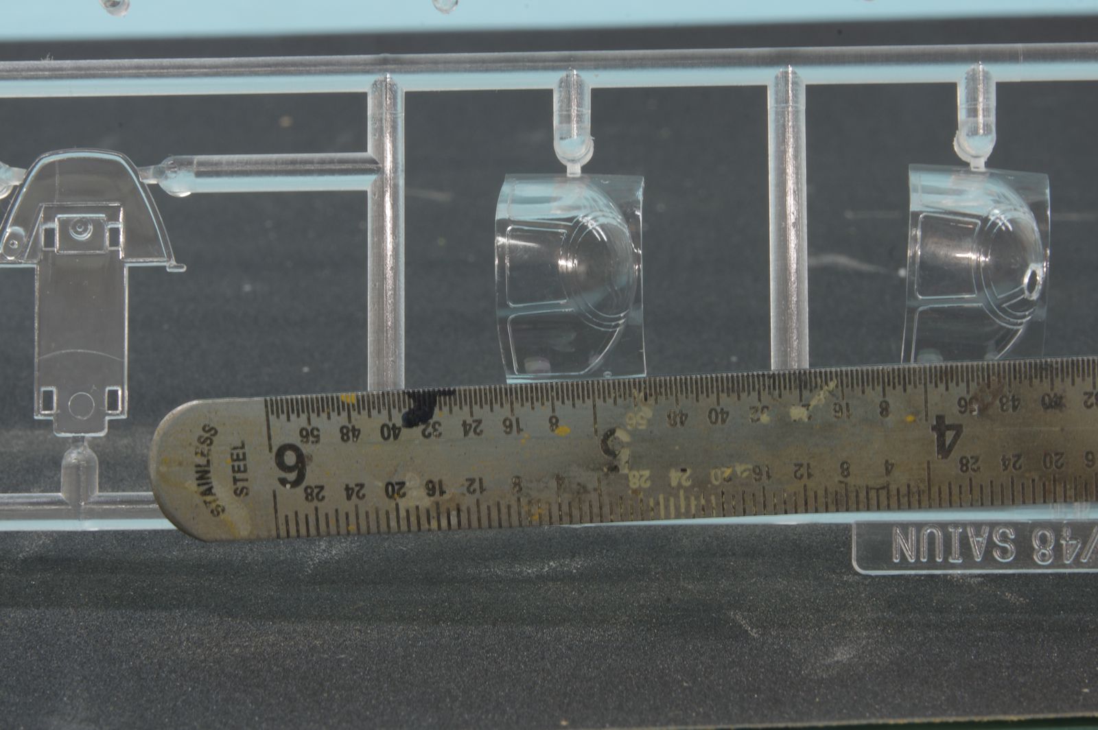

@jeaton01, that is a very interesting technique for creating your masks. It seems like it would be prone to quite a bit of error? I am curious how many tries it took you to get the masks correct? I ask because I usually lay tape over the clear part and burnish it down good, then highlight the raised lines with a pencil, remove the tape, scan it, then use that scan as a template to create a mask in Inkscape. Even then, it takes me up to 10 test cut/fits and modifications to get things right.

About 80% of the time they work without further adjustment, it depends on how much curvature there is in a part, and often it is best to make a mask in more than one part. The hardest one on the C6N was the one in the gunners’s station, 4 separate clear areas and lots of compound curvature. My shaking hands make cutting masks in place difficult. Also, often I will do more than one model of a type so that is a time saver since I may have the masks done, or close to right if it is a different model manufacturer. Drawing the masks in Autocad allows me to get very precise by zooming in on the photos, which are always taken with a ruler next to the part for accurate sizing.
