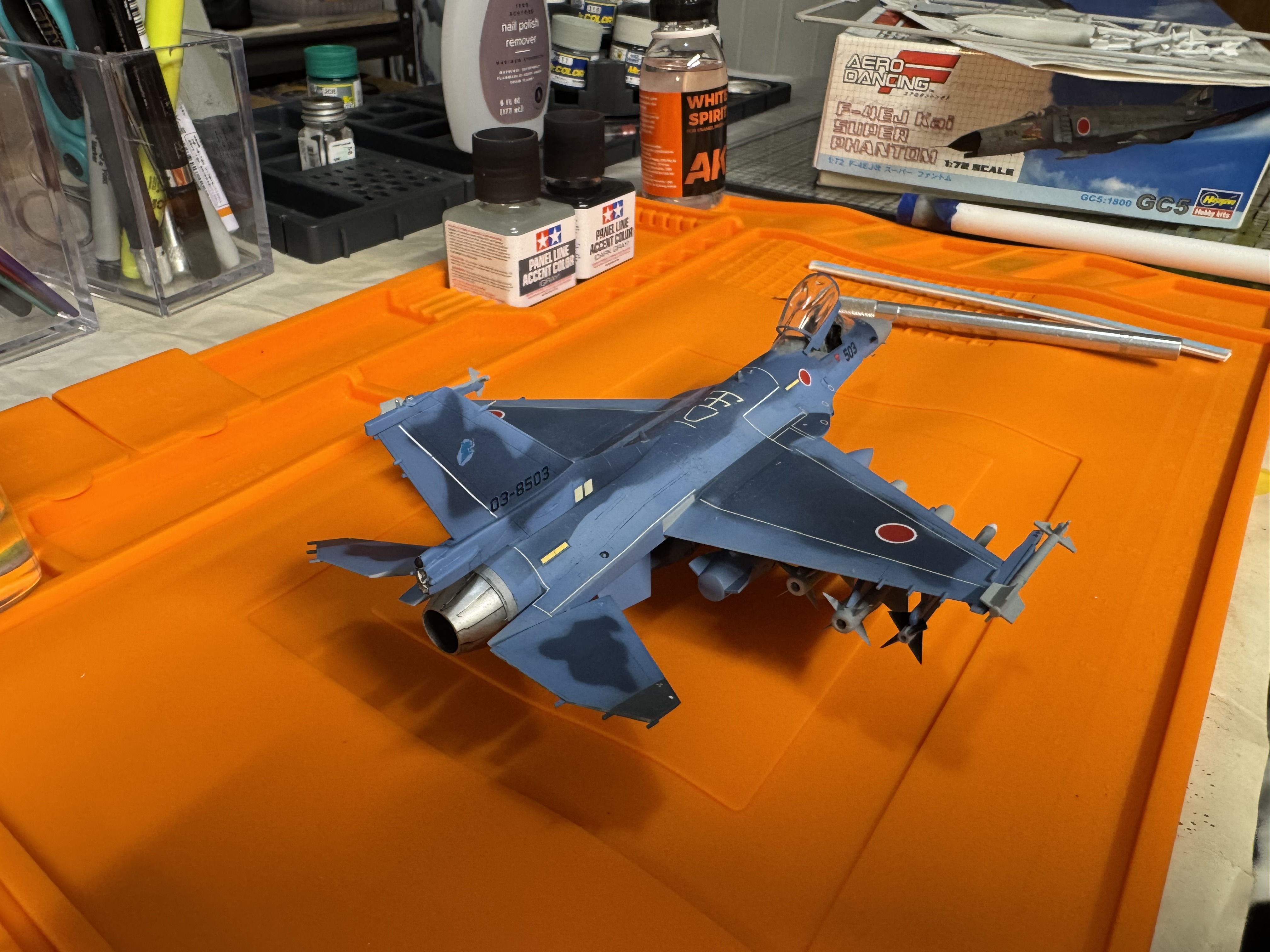

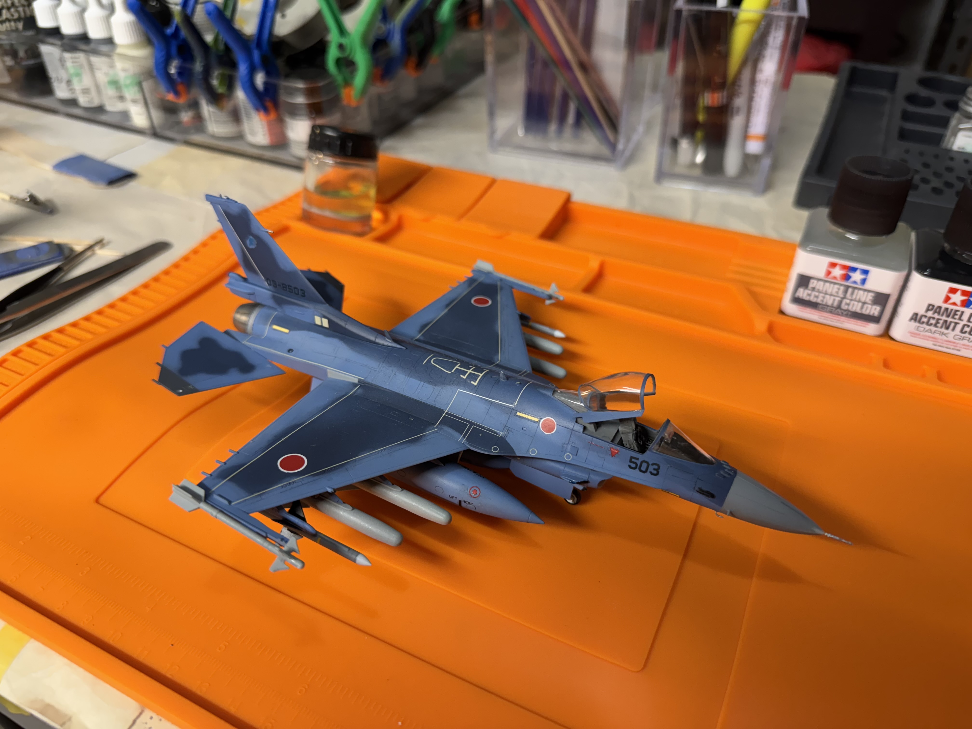

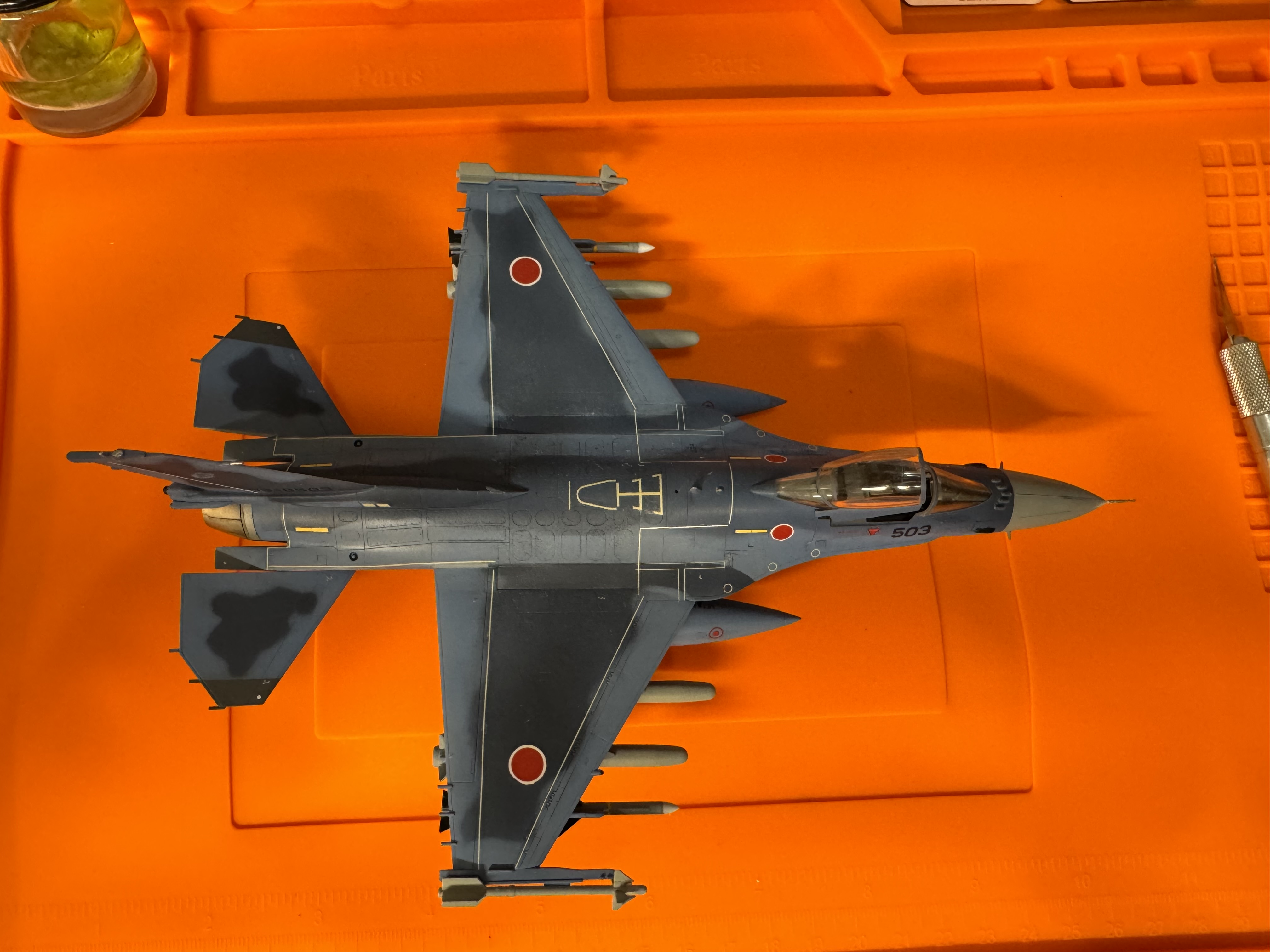

I finished the F-2A over the weekend, so I suppose I should add a couple of pictures. I made a few mistakes along the way, but I think it was good for the skills.
Thanks,
Greg
Well done Greg. I really like the camo - and man, she’s loaded for bear.
I love that Japanese two-tone blue scheme. It’s one of my favorite aircraft camouflage schemes.

Excellent job on your F2A @Gregbbear ! I think it looks just great. Nice paint job. Shall I use the first photo for the wall?
Beautiful build! That blue camo is stunning. Great job Greg!

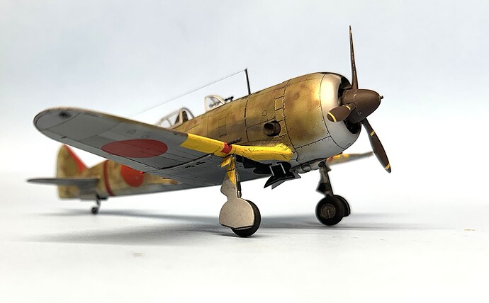

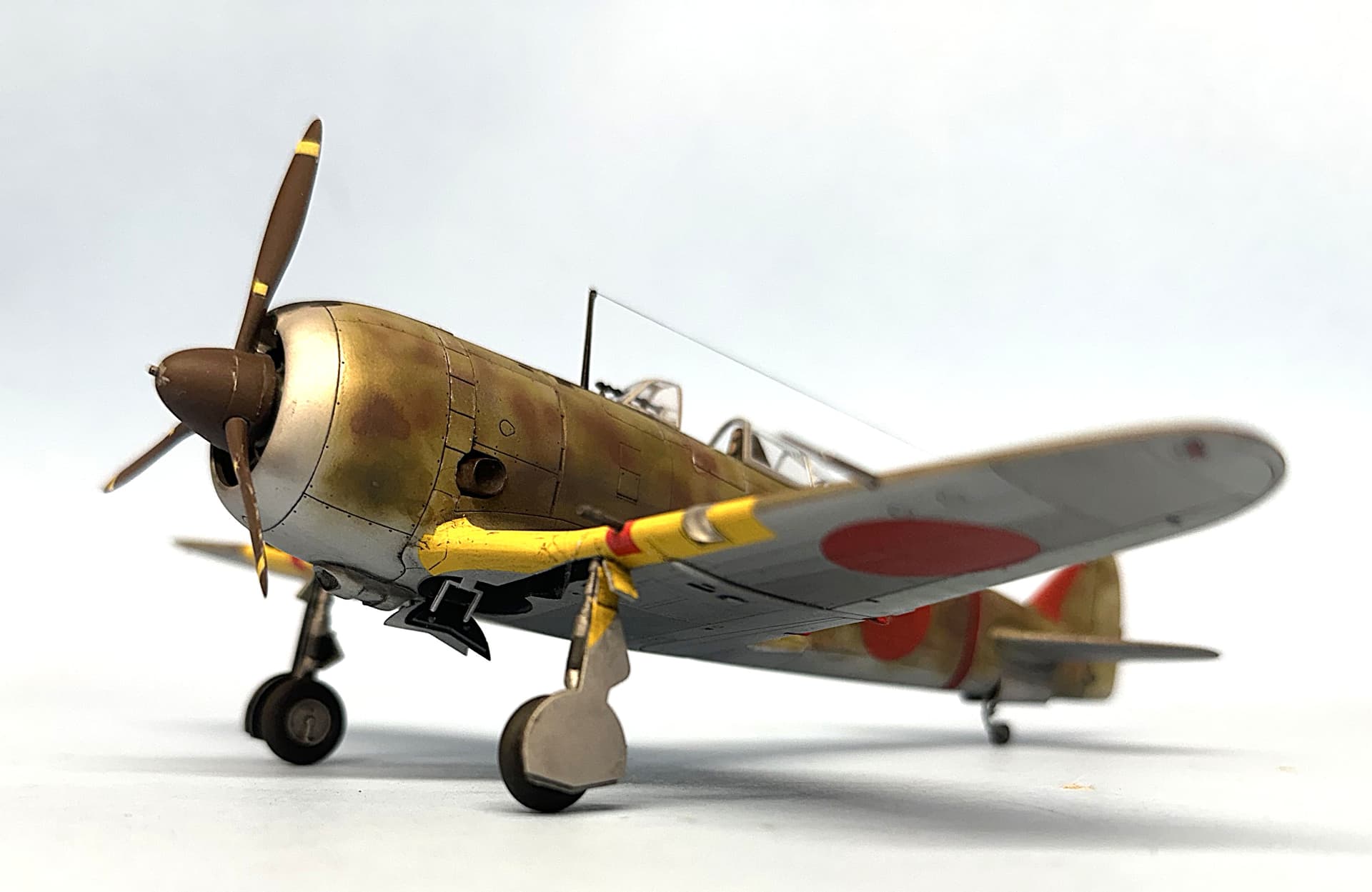

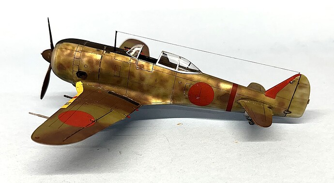

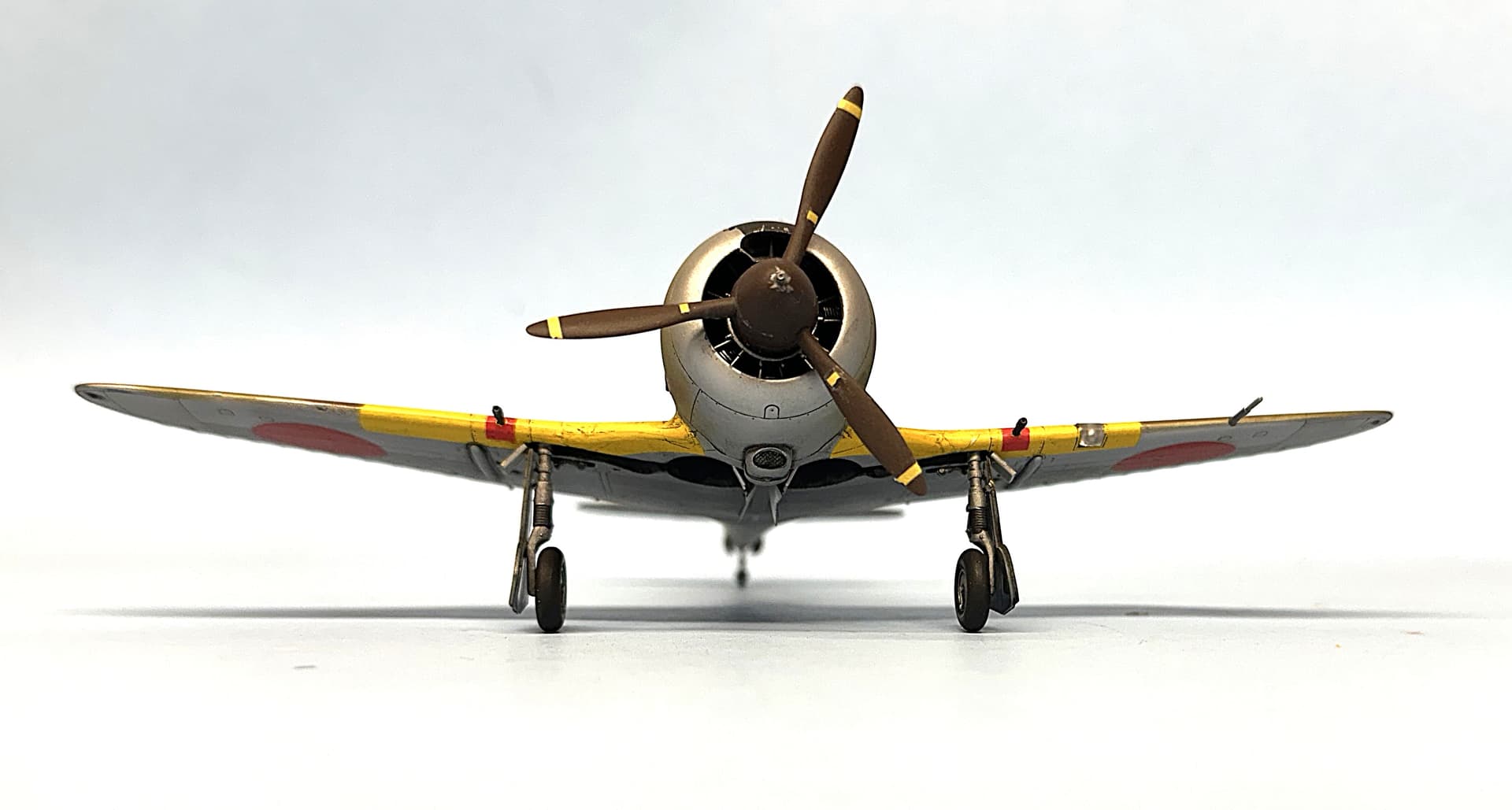

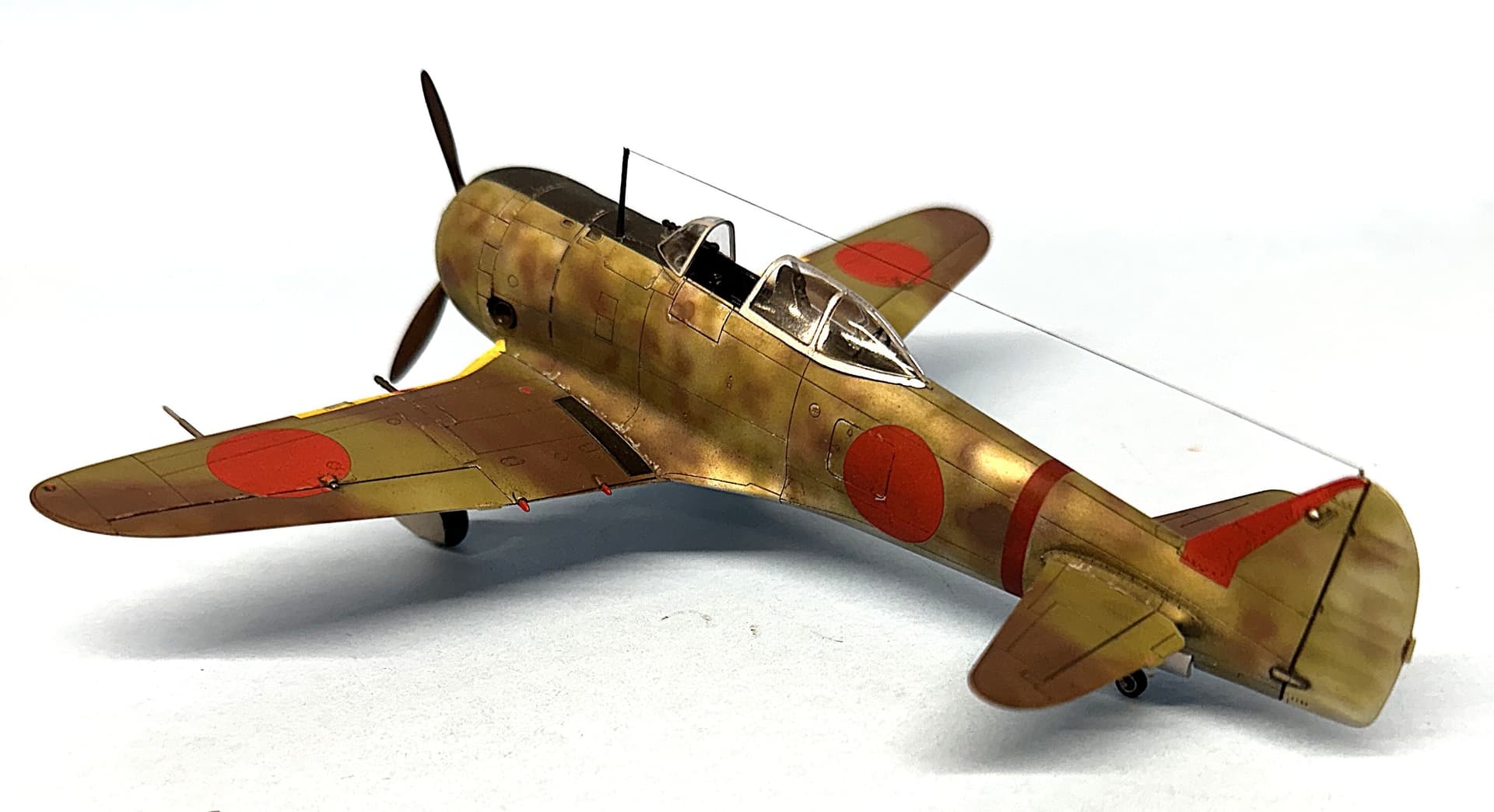

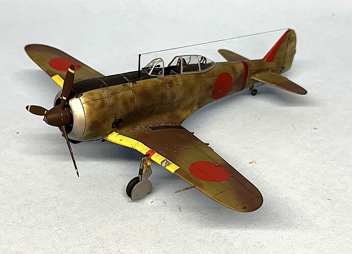

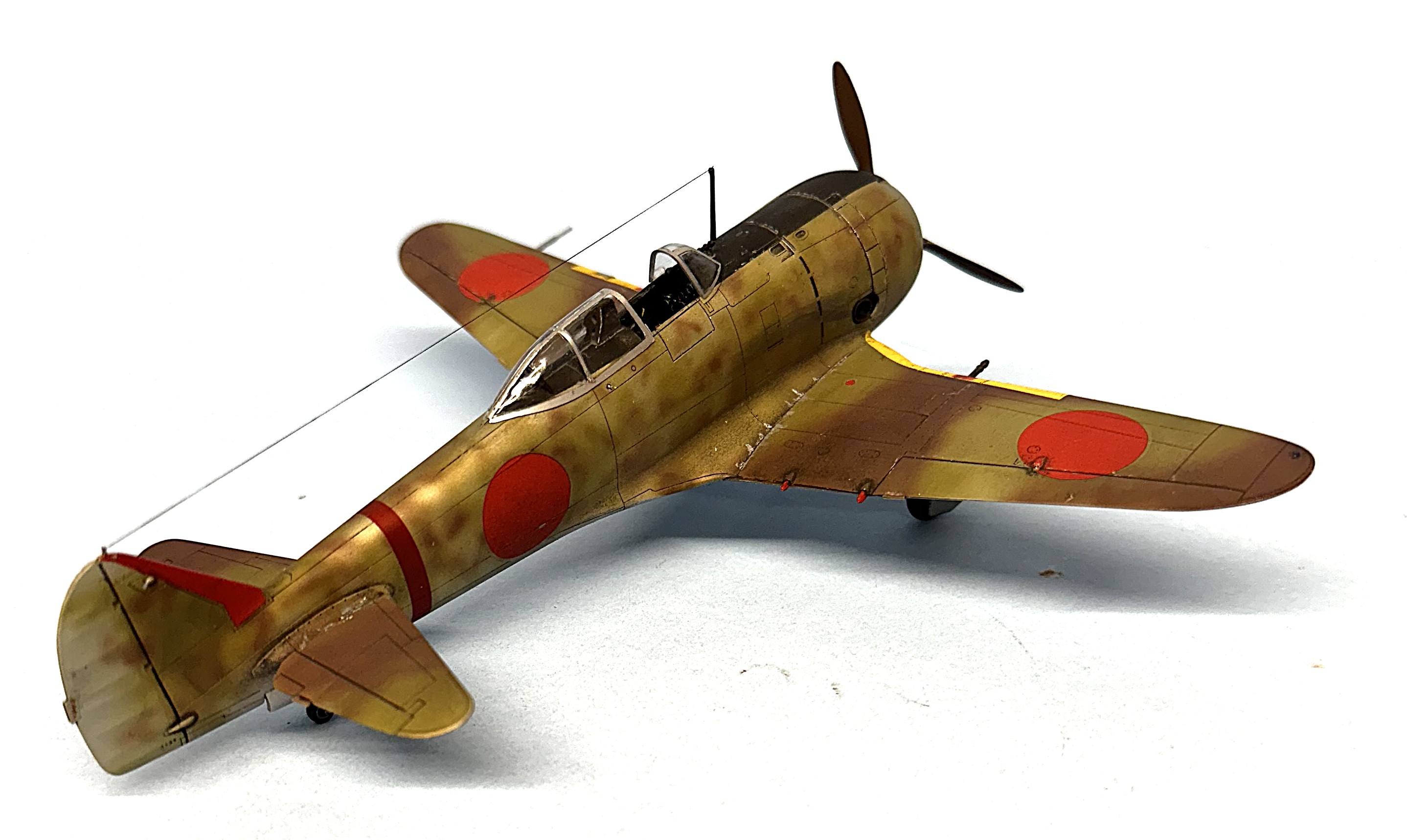

I am calling this one as finished!
Hasegawa, 1:48 scale, Nakajima Ki-44II Ko, Army Type 2 Fighter, “Shoki”, Reporting Name, “Tojo”. 85th Hiko Sentai, 2nd Chutai CO, Capt Wakamatsu Yukiyoshi, Jogai Airfield, Nanking China 1943. Capt. Wakamatsu was KIA on 18 December 1944.
Great little model which is starting to show it’s age when compared to other more recent Hasegawa releases like the F1M2 “Pete”. Fit is good and the detail is enough.
Paint is a combination of Tamiya LP-11, MRP and Alclad II. Decals are from the kit and the spares box. I was NOT a fan of the decals used for the ID bands and the next one I’m going to paint. They are the things I don’t like about this model. However the kit was an original 2005 release and I guess the decals soured over time. Still in all it was a nice little model and I enjoyed the build.
(I am thinking the first pic, 8793 is the best one to use.)
Thanks for looking and I hope y’all are building away!
Cheers,
Freddie
Great finish Greg. I like the fully loaded look.
Looks great Freddie. It might be me, but Hasegawa did everything right with most of their Japanese subjects.
Excellent work everyone. The roster page has been updated with @fjs3 's and @Gregbbear 's recent completions.
Two stunning builds! The f2 scheme is really striking. The ki-44 squiggly work is very nice, I am often intimidated by the airbrush work required for that finish.
Beautiful work on the F2A Greg. Great painting, the loading is impressive (that’s one happy jet:). Also the canopy is pure crystal!
Freddie the Shoki is excellent. If these ID bands are decals, then you did a great job (last time I used such decals, I ended up using PVA to make them conform - and during the process, they disintegrated to bits. That went well… ). Thus, you have my respects. A very nice build and paint job overall.

Greg,
That F2 is freaking awesome!

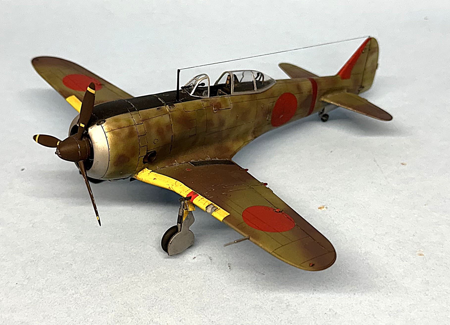

Some more progress on the Zeke.
Canopy was masked with Eduard pre-cuts and camo colors used were Gunze H-325 (under) and Tamiya XF-70 (upper) acrylics. Some color variation was applied after the base coat, by mixing it with lighter green, gray and yellow. This will be toned down after clear coats have been applied (I hope).
