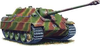

it’s all about taste,what you want to attempt or what you can handle,since you said you didn’t have any paticular vehicle in mind,you can go with the box art or pics in the instructions.I did a two color myself,see what you think :
The Striped version is very popular and rather easy to do.
Eric,He said he had 6458,the early version,did early ones sport the striped camo ?
Good point. The picture does appear to be a “Late” version. I honestly don’t know.
I would stick to my guns on this CBennet.
