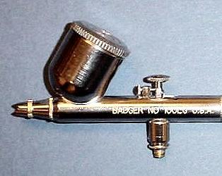

ahhh see I dont have an Iwata yet… I see now and know what you are talking about… the crown is supposed to allow you in closer to the subject I believe… (correct me if I am wrong)
Nope you’re right. It doesn’t have to be an Iwata though. My Badger 100 came with one and somewhere along the line I wound up with one on my old Badger 200.
You can sort of see it in this picture of the front end of my 100lg:
