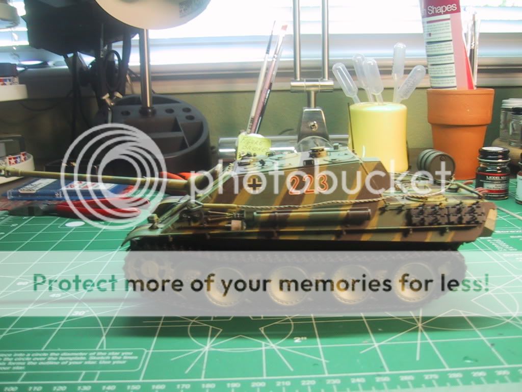

LIKE [Y] the JAG build. I don’t know if you remember but that was my first tank build last year and you shared some valuable insights.
3 JAG
Thanks IB, always glad to be of assistance. [B]
