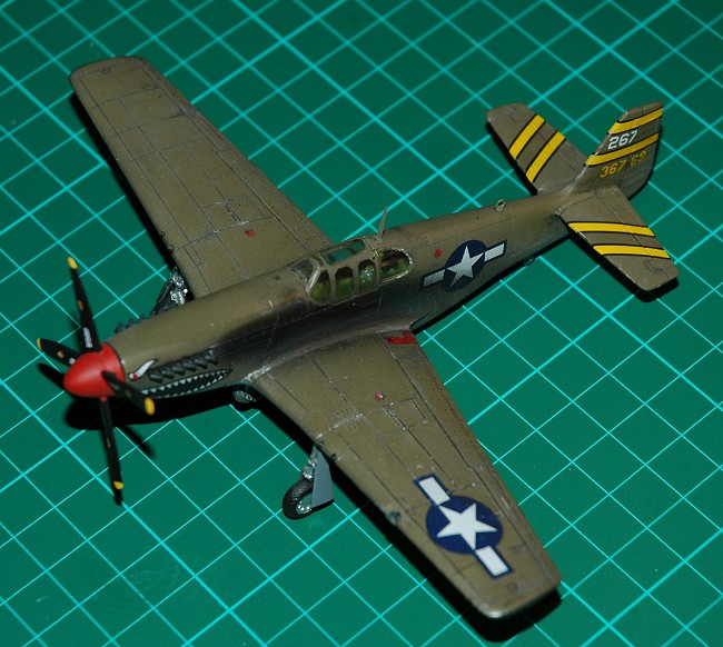

I’m back to work on this model after a long break. Everything is painted. The olive drab turned out darker than I thought it would. Touch-ups are necessary around the yellow stripes - I decided to paint the stripes instead of using the decals.
Note - I painted the landing gear bay chromate green. Probably not accurate, but then again, this is only my second model and my focus is on technique. Looking at the photo, I just noticed that I did not paint the rear bay chromate green too - oh well!
Next is weathering and final assembly.
Photos aren’t great - need a better camera!

I finished this model today. A couple of photos are posted at the bottom. I had hoped for better results but am still pleased with the outcome. I did find the 1/72 scale rather frustrating though because of the small parts - some were difficult to paint or glue in place. My enthusiasm waned early. I was ready to finish the kit and move on to something else.
As stated in an early post, my main goals for this project were:
  1. A better looking canopy than on my last model. I feel the canopy looks better but is far from what I had hoped. I spent a lot of time trying to mask the tiny canopy and used a mixture of tapes (blue painter’s tape, Scotch Magic Tape, narrow modeler’s tape) to see which was easiest to apply and produced the best result. I even tried ParaFilm but gave up on it because of the small canopy size. After the model was finished and I removed the tape, I was disappointed with how the canopy turned out, so I ended up freehanding it. I’m not sure what masking approach I will take on my next kit.
  2. Better highlighting of the panel lines. I didn’t do any highlighting. Waning enthusiasm…
  3. Improved weathering. I didn’t do anything different here - used my standard 2 parts paint, 5 parts water and 3 parts dish soap. Waning enthusiasm…
  4. A smaller diameter antenna wire. I decided to omit the wire. Waning enthusiasm…
  5. Possibly free-handing the line between the olive drab top and gray underside of the aircraft. I was advised not to try this on a 1/72 scale aircraft so I didn’t. I first tried to mask using Elmer’s Tack but was not pleased with the result so I re-masked using masking tape. I’ll try the tack mask again in the future.
A few comments on this kit.
    1. I liked the fit and level of detail of this kit (when compared my previous Revell-Monogram kit), with a couple of exceptions listed below. I especially liked that the propeller cone was separate from the blades and that the engine exhaust ports were separate from the fuselage. This made both items easier to paint.
    1. The instructions called for drilling four holes and four squares into the wing undersides. How do you drill a square?
    1. There is an air intake under the wings and a part that glues onto the front of the intake. I found that the part did not fit properly and I had to omit it.
