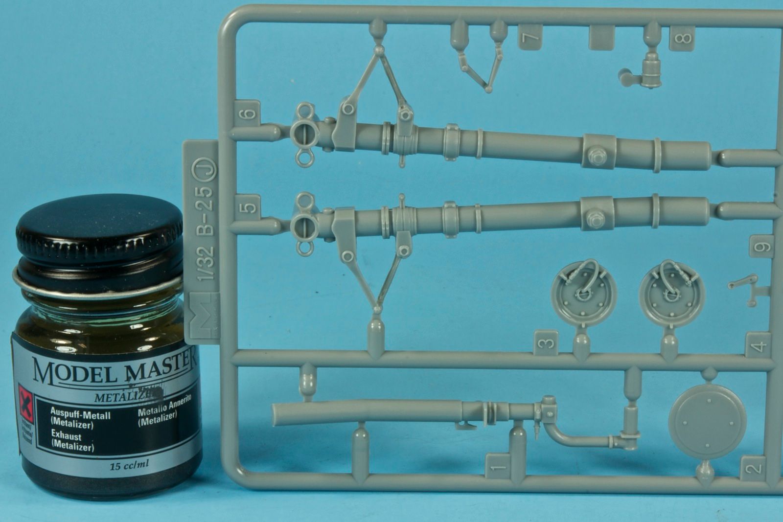

Besides, I’m working on the B-25 right now, and the kit struts are extremely beefy.
That’s the point. The mains look like they can handle the weight. The nose gear not so much. I just don’t want to take the chance.
