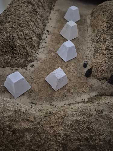

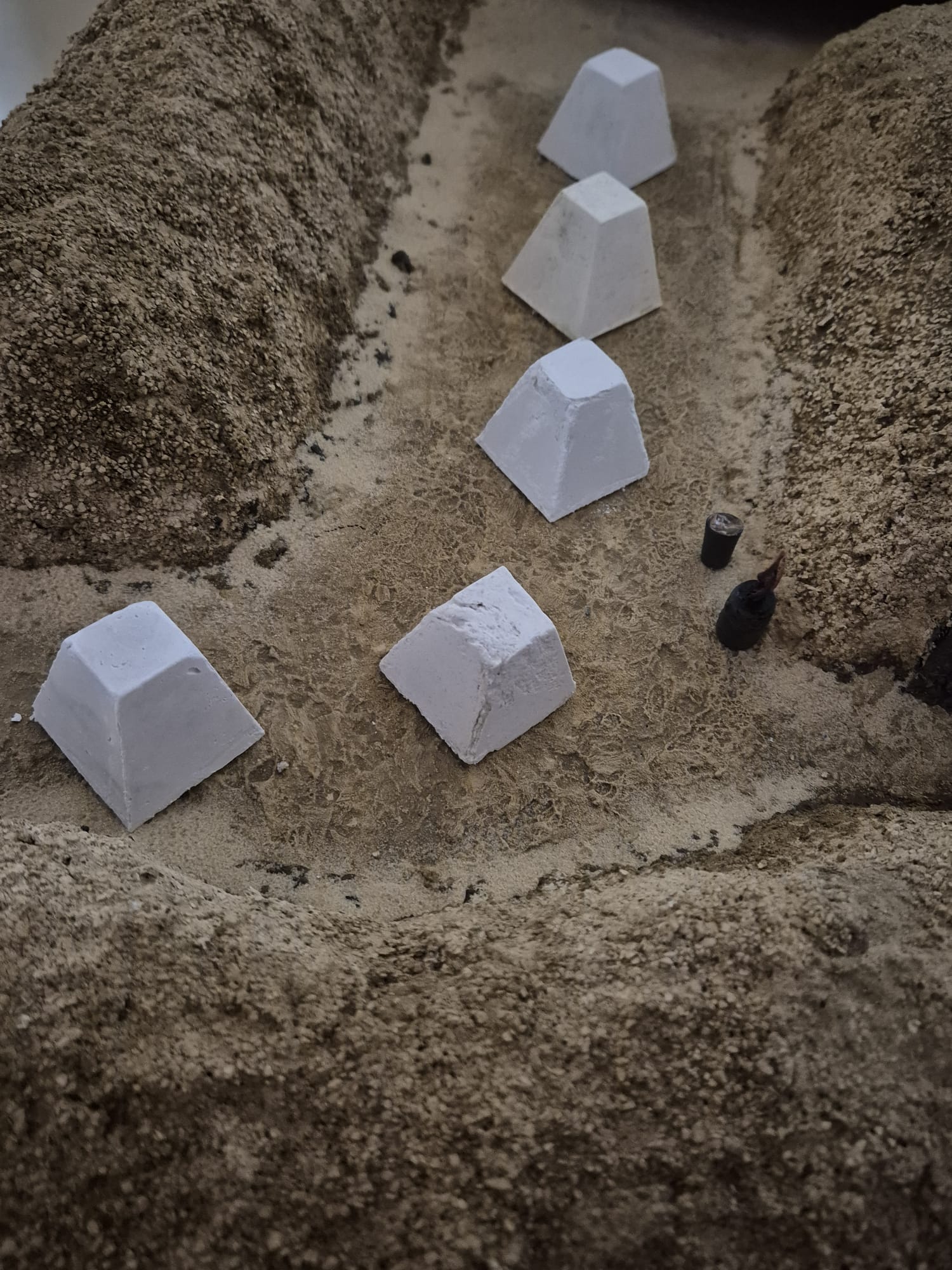

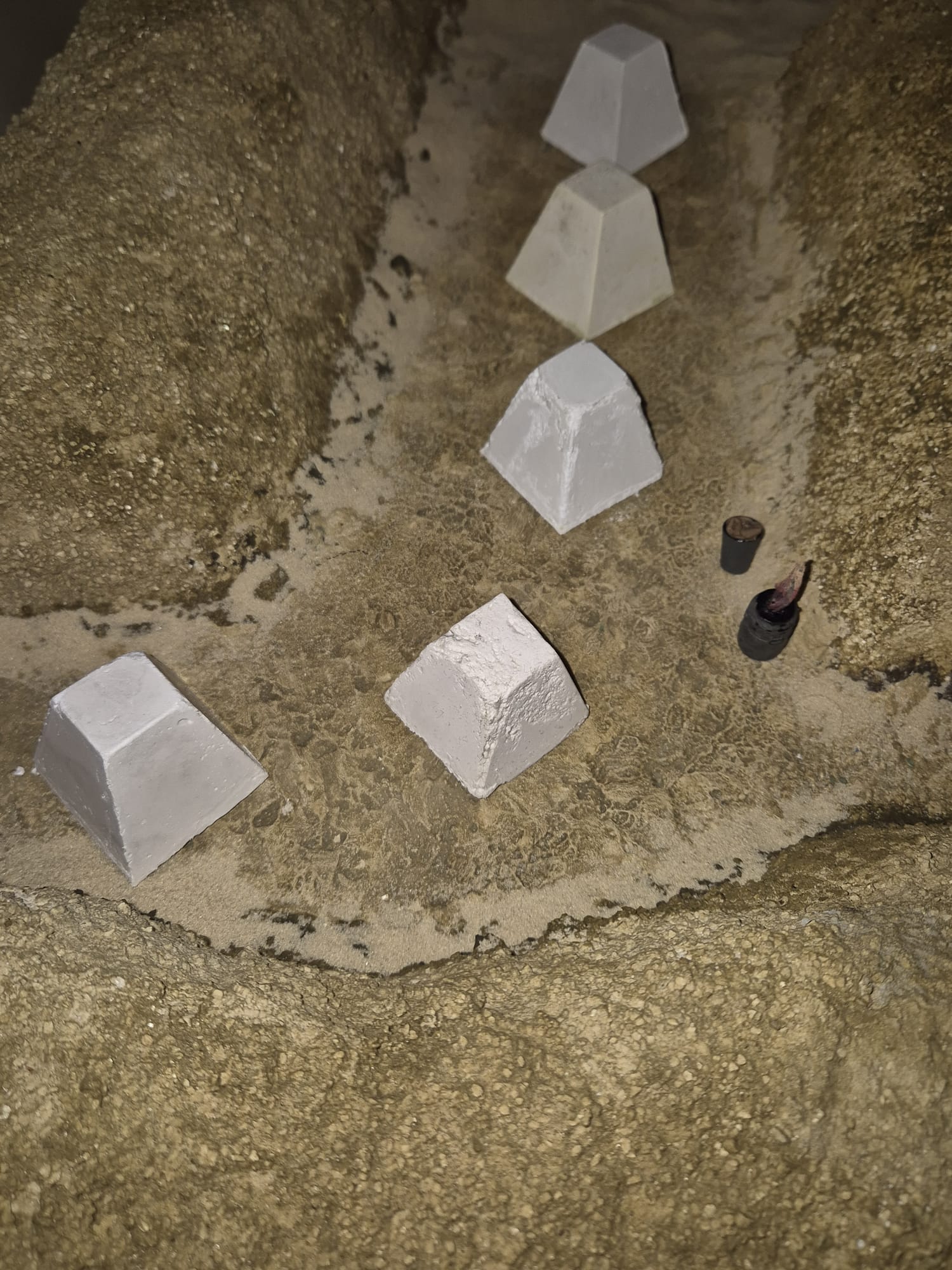

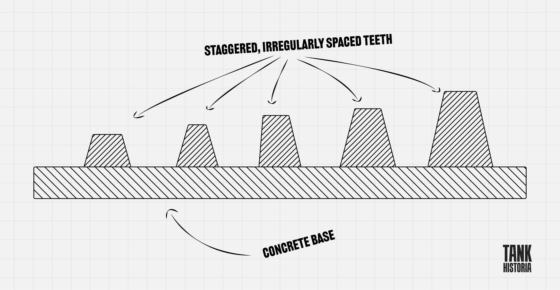

And since we are also speaking of displaying the infamous Siegfried Line I am preparing my own “Dragon Teeth” which when mixed with some other one commercially available, either in plaster, resin or styrene will form a formidable scenario of the real one Allies had to overcome.

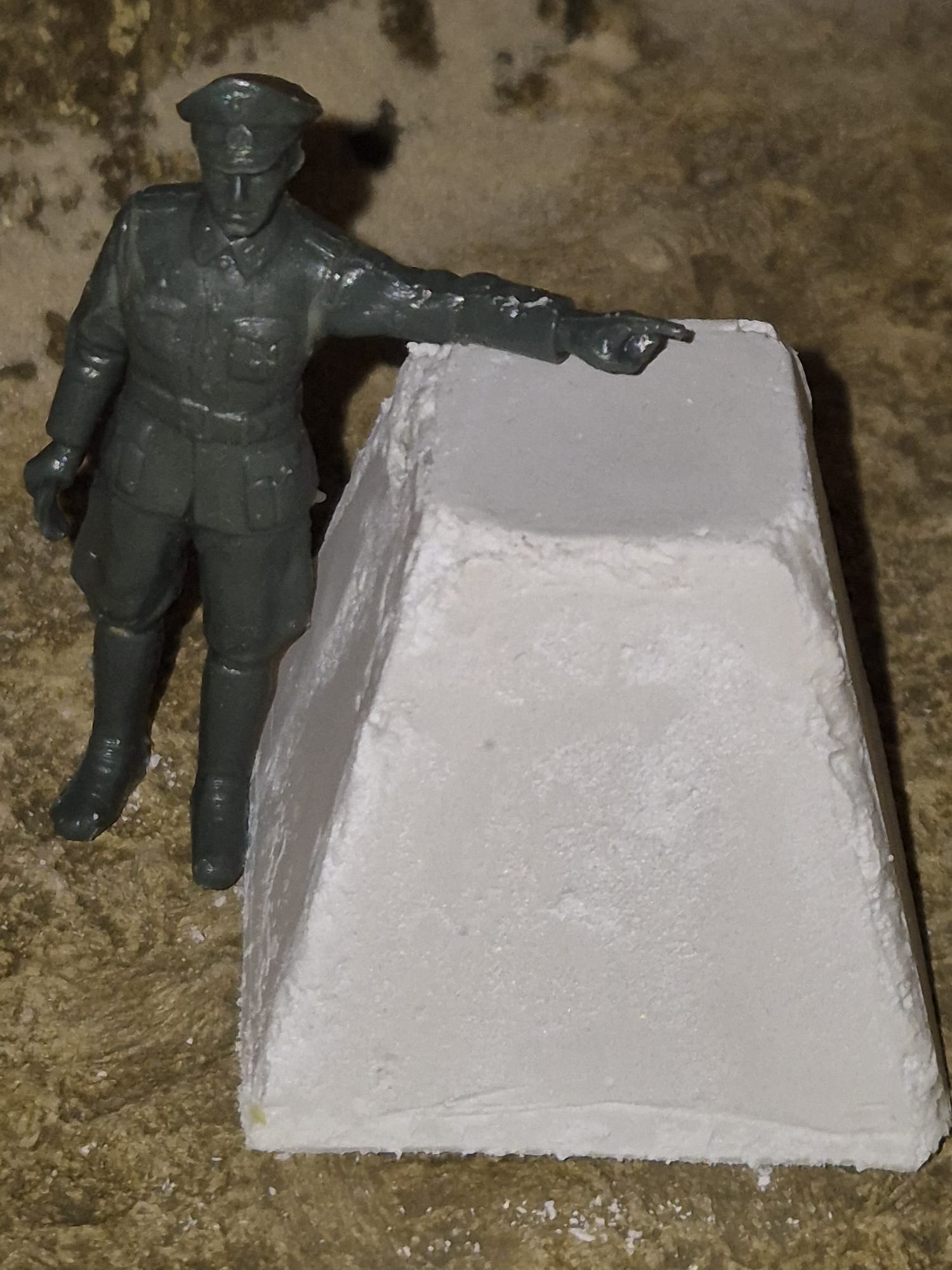

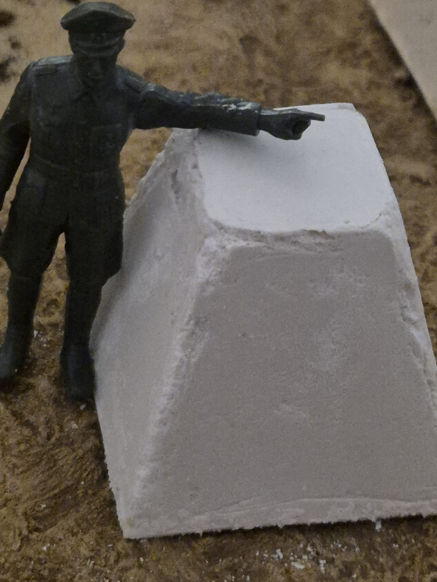

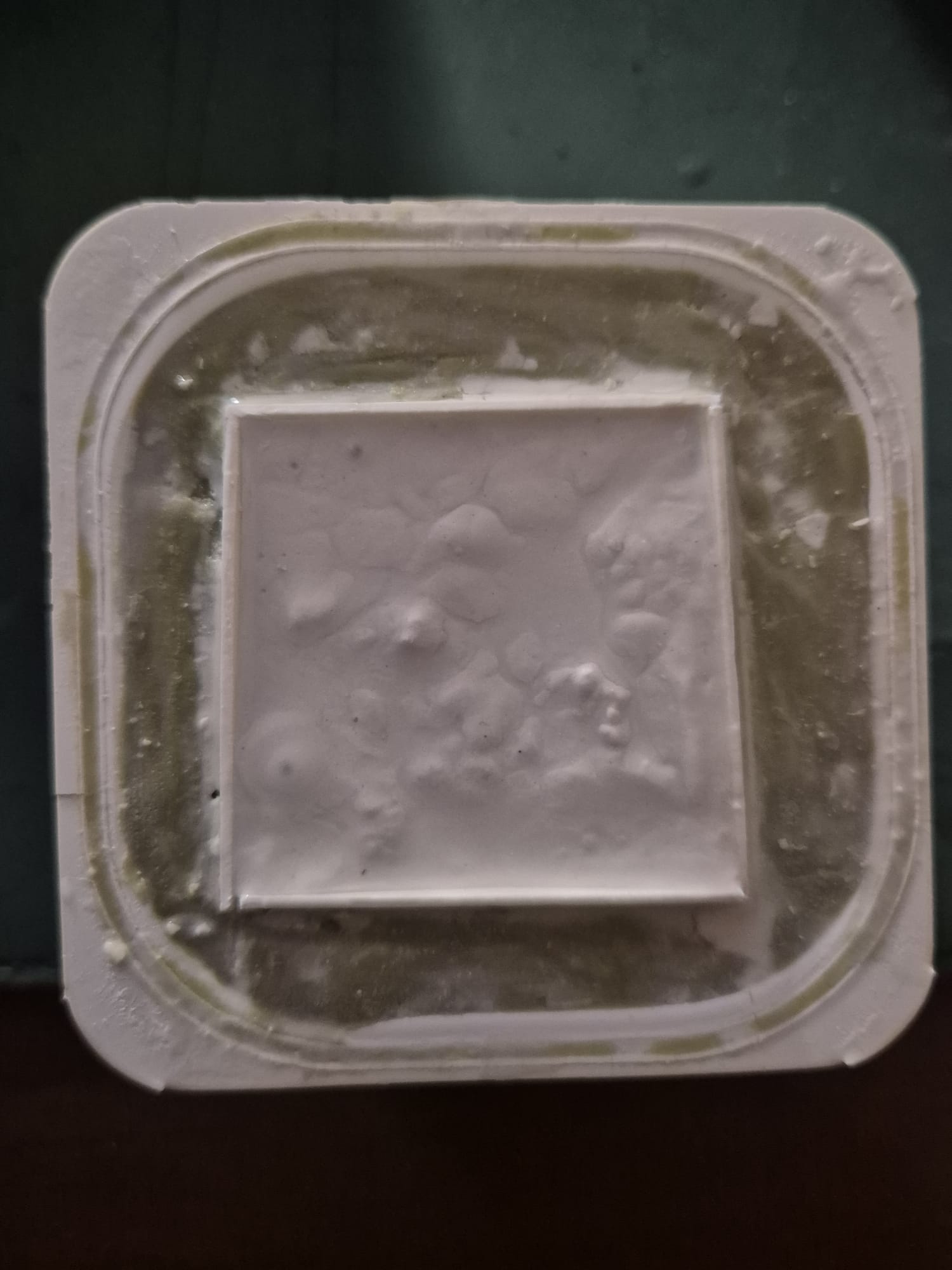

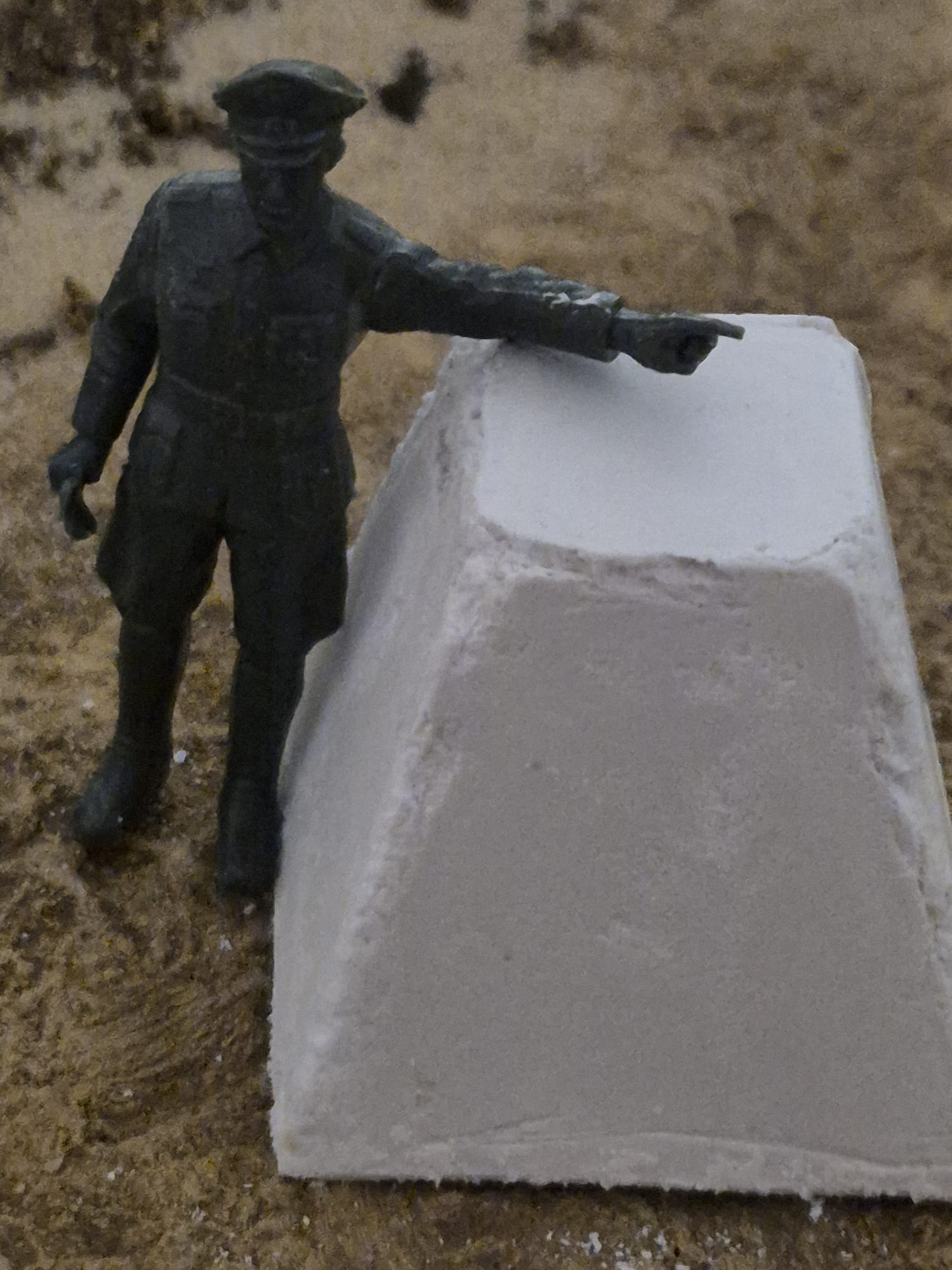

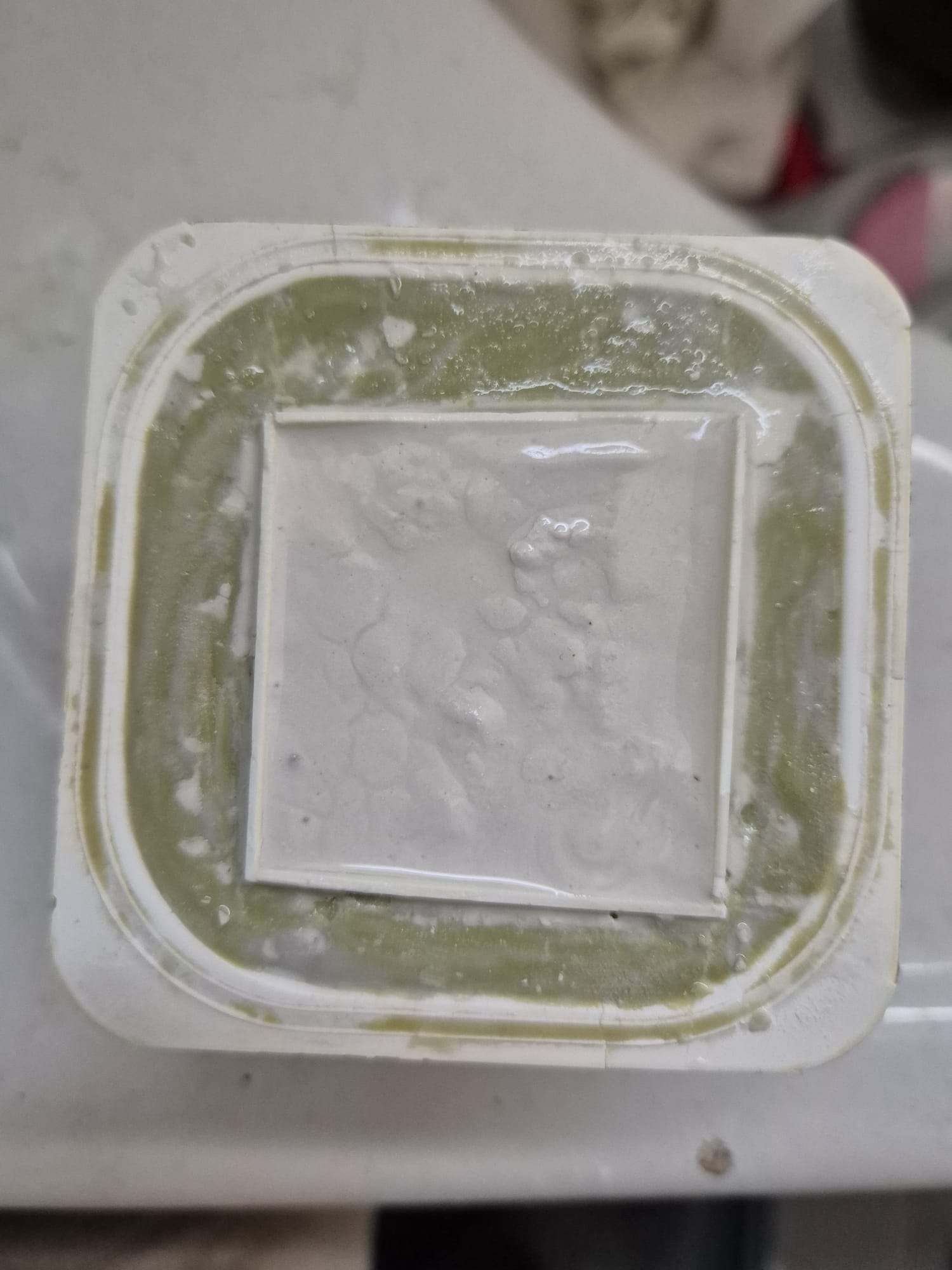

I form them irregularly on purpose, with some edges smoothened by erosion or having been hit by ammunition. The trick is to insert into the mold some talcum prior to the pouring of plaster mixed with water. Once completely dried (approx. 3-4hrs.) I carefully cut along the edges of the mold and tap the bottom of it allowing the hardened item to slide out, and voila!
There were many different sizes and shapes of these obstacles, depending whether built prior to the war or even during the war, and of course also depending on the commissioned contractors. The only common material was armored concrete.
The Allied didn’t spend too much time blowing them up, which would have been quite risky, since these defensive lines had also some well hidden machine gun bunkers watching over them and many were also covered with dense stretches of barbed wire.
What the Allied Forces did was usually to send in a bulldozer and cover them with earth forming a compact ramp on which both their tanks and men could then easily cross.
These again are in 1/35 scale measured using the height of an average standing German figure.

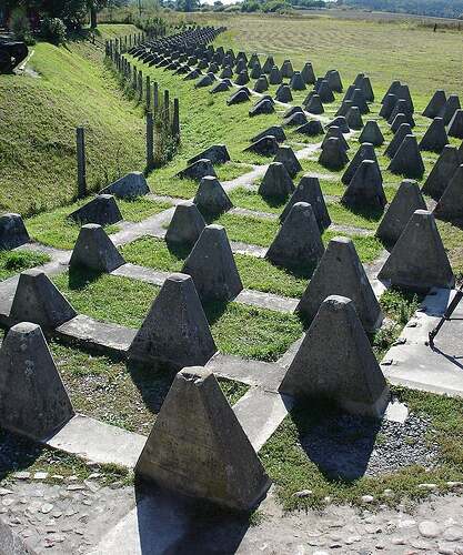

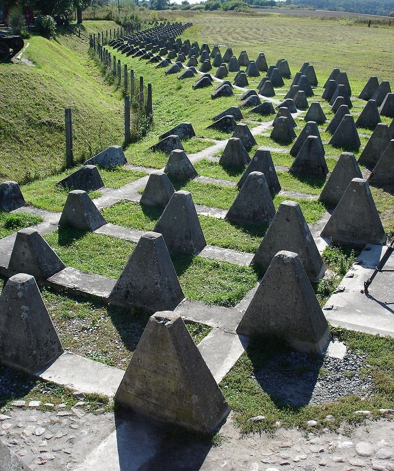

I’ve got some of the old Custom Dioramics dragons teeth. Yours look pretty close to those, for what it’s worth. One thing that I learned not so long ago, is that they are all connected to each other to prevent them from being dislodged or removed.
Amazingly, there was quite a science to what I originally thought were just blocks of concrete.

And yes, I know about the interconnecting concrete lines on which they were fixed, but those were actually smaller in size than those I am building.
The large ones were usually provided with rings on the top which allowed to either raise them from trucks with a crane and place them in a different position or to reinforce the smaller ones.

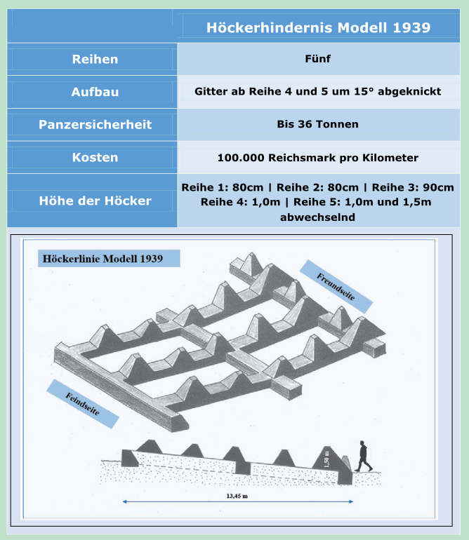

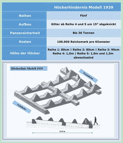

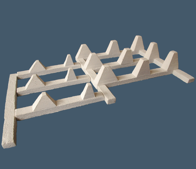

The actual replica in plaster of the ones you are showing - the Model 1939 - here are available in their correct various shape sizes from Helmuth Strongholds which has also recently produced Belgian Gates in both 1/35 and 1/72 scale ones.
Moreover, some of the Bunkers, Tobruks and even anti-tank Walls are produced by this company.
The later builds, larger and more massive were called Model 1942 and those are represented by those I am duplicating. It was an afterthought of Adolf Hitler who, fearing that older versions were not completely capable to withhold an enemy assault on Germany (particularly the Red Army to the East, but also the Allied Forces to the West) decided and ordered much larger and more resisting obstacles to be built.
Due to chronic shortages of prime material, especially starting in 1943, it was then reduced to just a few key positions on the Siegfried Line.
One can see these big ones distributed in forests, along streams and rivers and even across some railways.
