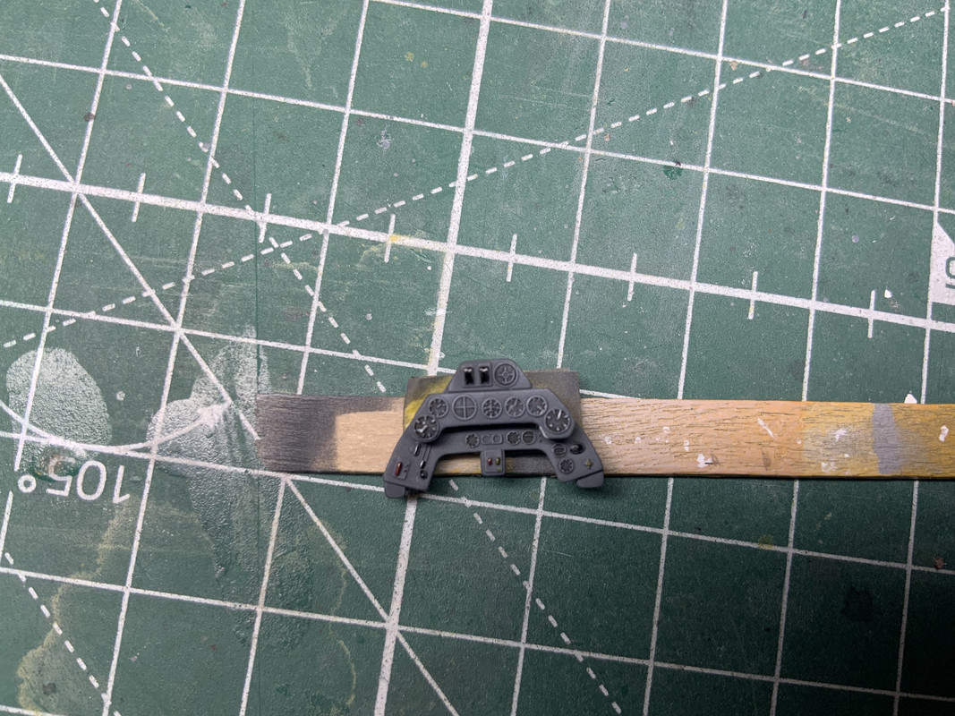

What’s the best way to paint the tiny indicators in the dial white? I’m thinking a sharp toothpick. I have a super small Tamiya brush but maybe a toothpick will give me better control. What are some other ideas?

One idea that I have d9ne on 48th stuff is paint the whit first then apply a heavy wash of black, the black settles but leaves the raised details in whit relief. Since you already have bkack down yes a SHARP toothpick would be the way to go.
Dry brush. Works well on raised detail.
Posca pens are sometimes useful.
I have some micron pens .20mm. I don’t believe I have a white one. Do those pens have a finer point than .20mm?
Agreed. A very effective method for raised markings as in the photo. [Y]

Posca pens are not that fine. .7mm is the finest. You aren’t really using it to draw the whole line, though. Just touching the ball point on the high spot of raised detail.
I cant get enough paint on a toothpick, needle, or small brush to stick to the surface. Those things are super small. I dry brushed as some of you have suggested and it’s good enough. Next time I’ll try TB’s scrape method. Some of the bigger raised detail were painted with pens.

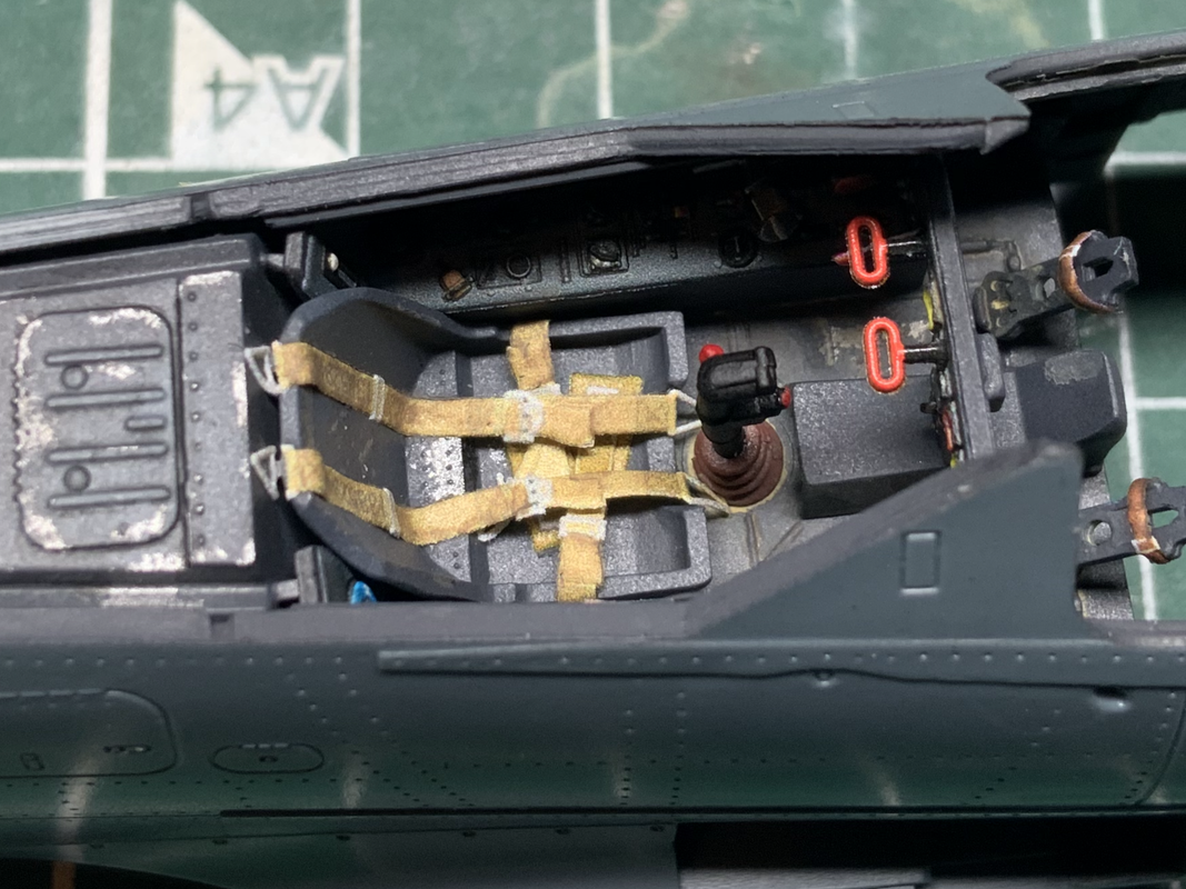

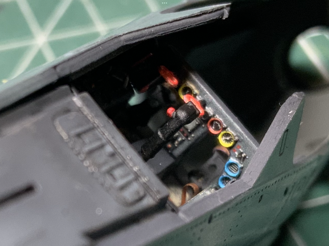

Not perfect but I’ll work on it. I will put down clear for the dial glass. I typically use an aftermarket set for these things but I wanted to develop another skill.
Here’s another 190 cockpit with a Quinta set. I think they look nice. I shelved this build last year for problems I encountered later in the build. I do think those two toggles on the IP are too big.

They came out pretty nice,I like the Quinta sets too,but they ain’t cheap,it’s good to be able to have a nice outcome on your own.
