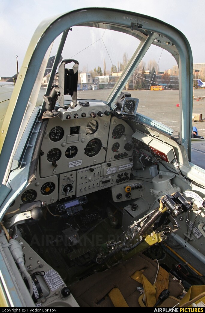

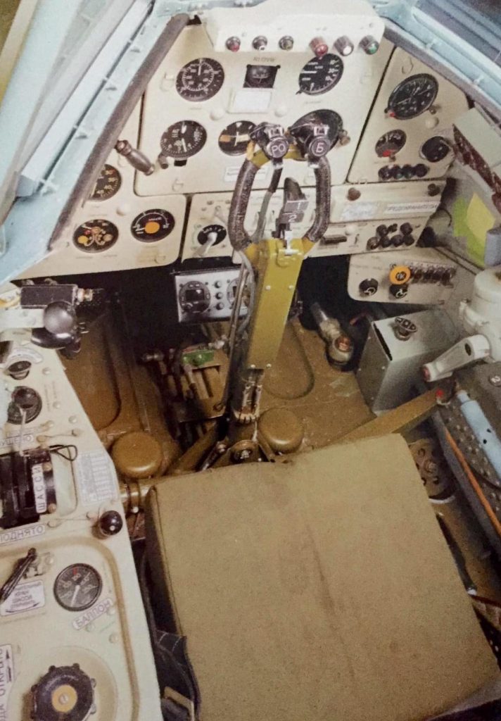

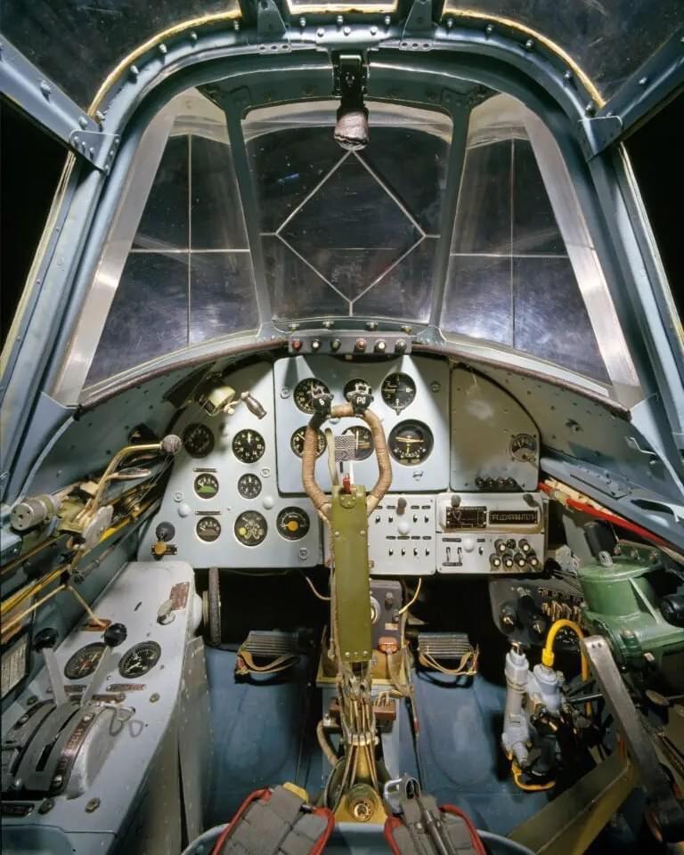

Those are restored planes, which seem to show light panels, green control column, and different floor colors :

Yeah, I was thinking of doing something along those lines, honestly. Mostly dark/neutral gray with panel accents. The cockpit is hardly visible but still it’s nice to know what it should have been, at least for educationnal purposes :wink:
Oh, interesting ! And somehow in line with some of the variations I’ve seen as it seems close to the ALG-5 primer. I could also have a quick lookie at the Zvezda instructions sheets. Hadn’t thought of that, actually. I don’t think there would be too much difference between a one seater and a two seater of even an il-2 and an il-2m3 in terms of interior paints.
