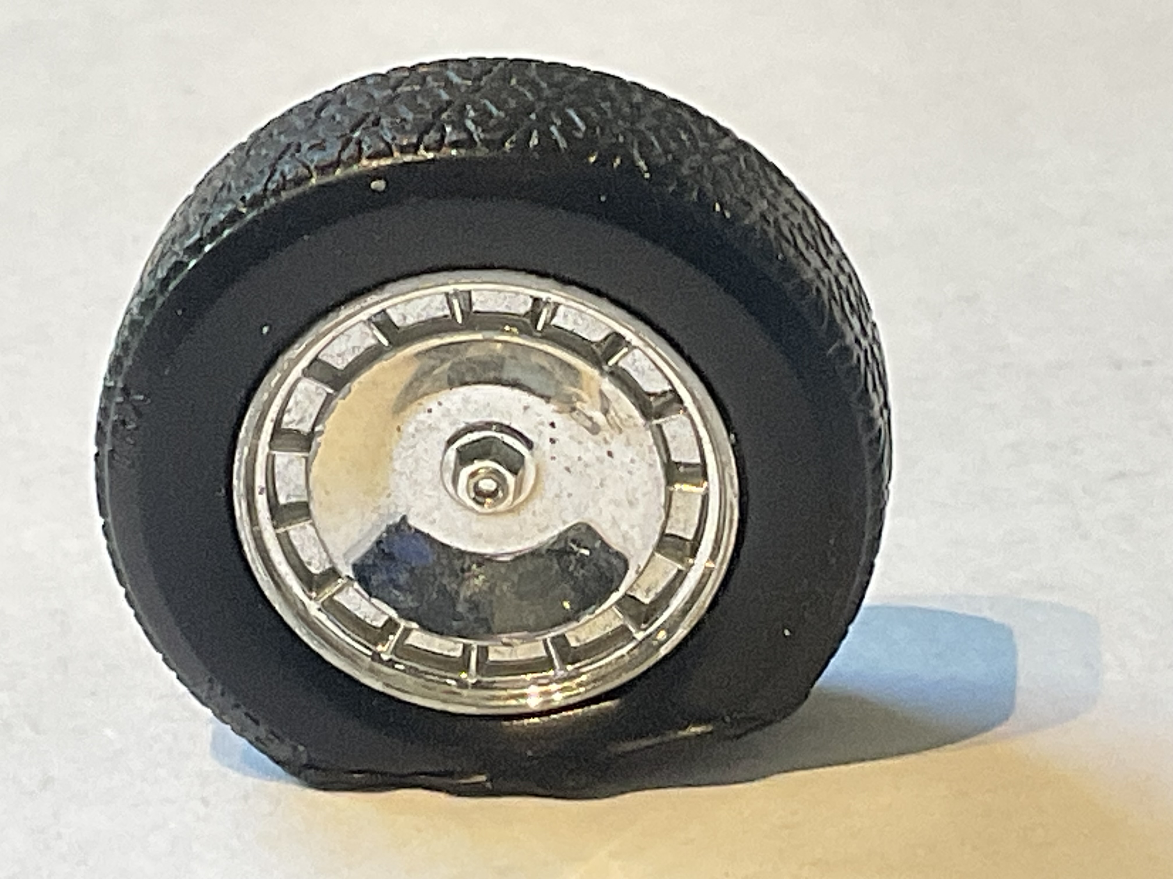

This one just wasn’t kept level when melting, hence the bottom isn’t quite flat.
