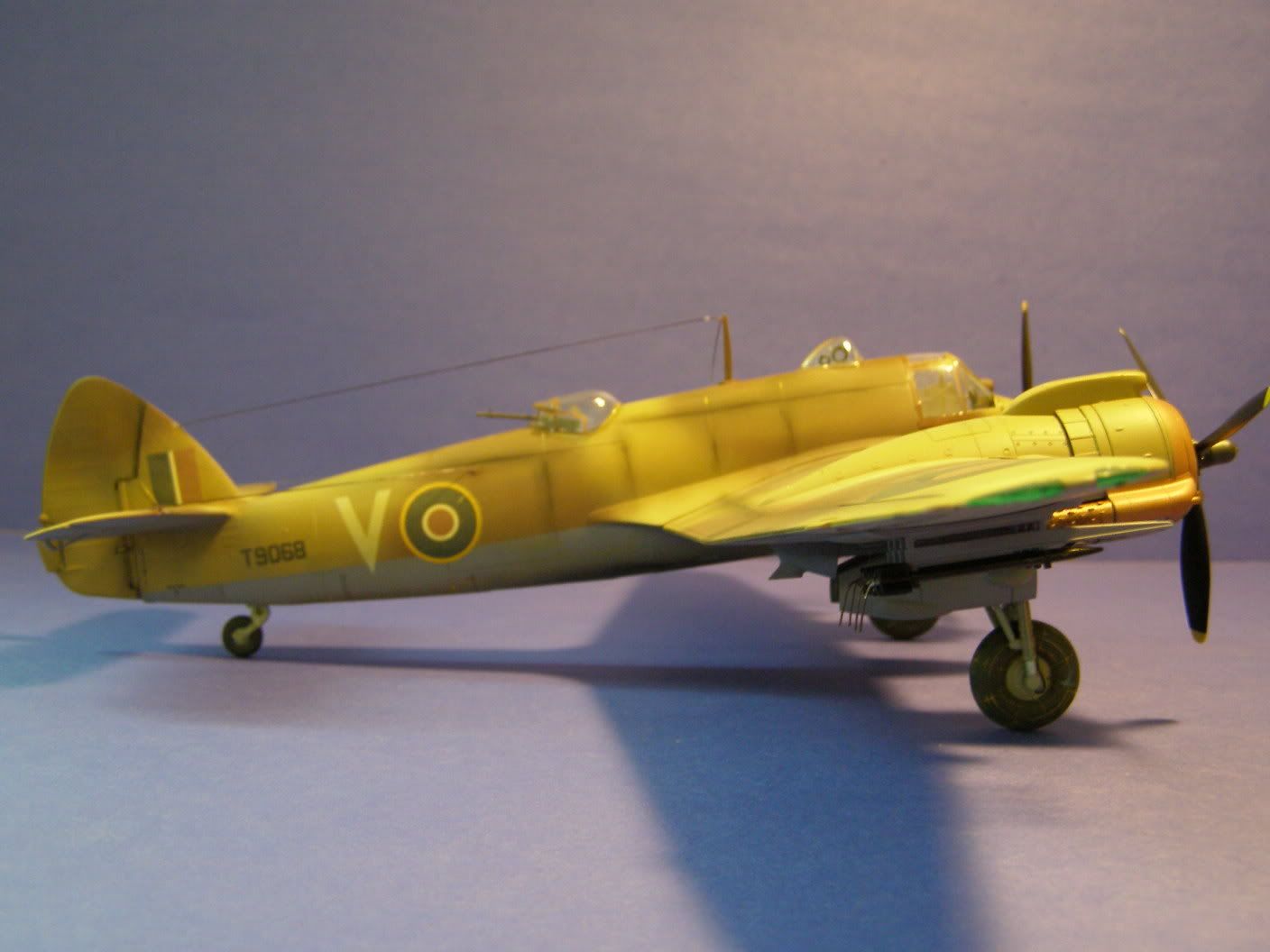

I don’t know if this will work for you, but I had something similar happen to my Beaufighter about a year ago. I used Tamiya acrylics for the paint and had just put the decals on with some micro-sol setting solution when the frosting appeared. Any way, a coat of Future took care of it.
Frosting around the decals:
After doing the Future:
