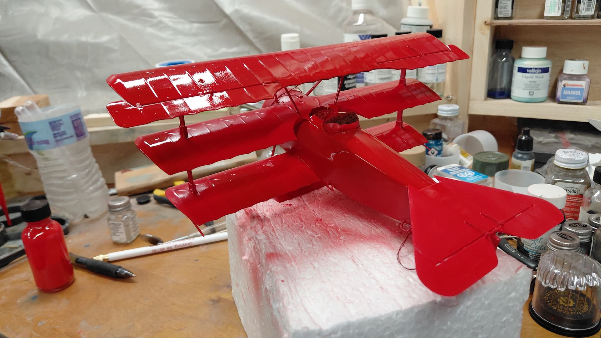

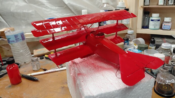

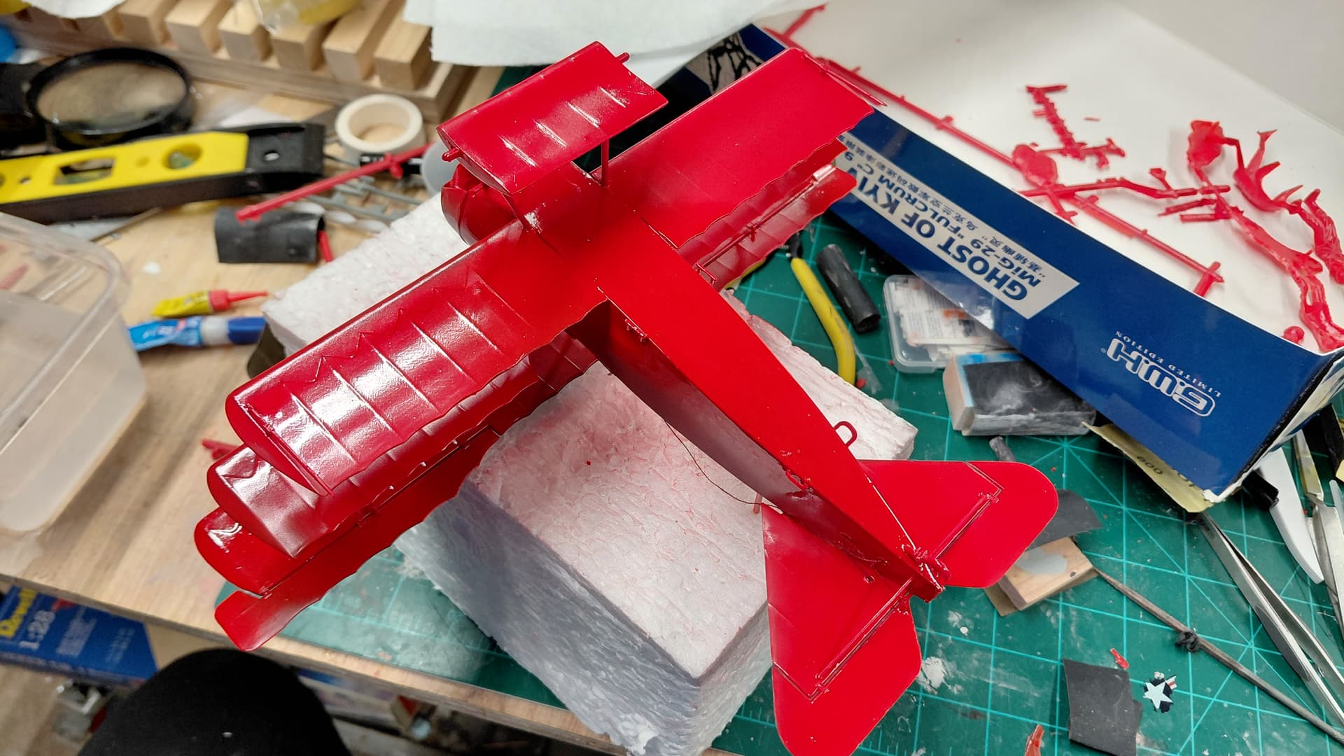

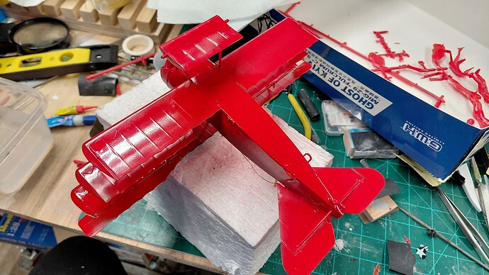

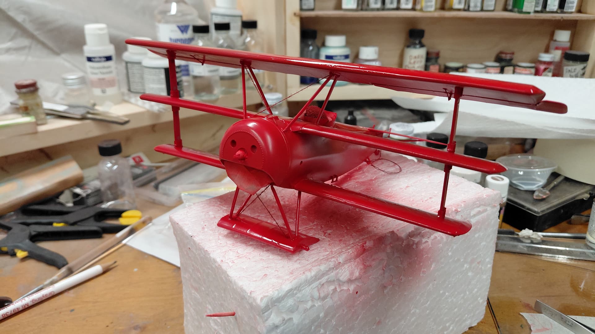

I sprayed this thinned out testers gloss red enamel plus a few drops of gloss black enamel two days ago…still not quite cured.
That’ll probably take a week or two to cure if not close to a month, unless you put it in a dehydrator for a few hours or you have some dry heat coming your way in the weather forecast. I usually wait at least 2 weeks to a month before I do anything with it if I am using Testors enamels. I have found out the hard way a few times that I didn’t wait long enough with enamel paint.

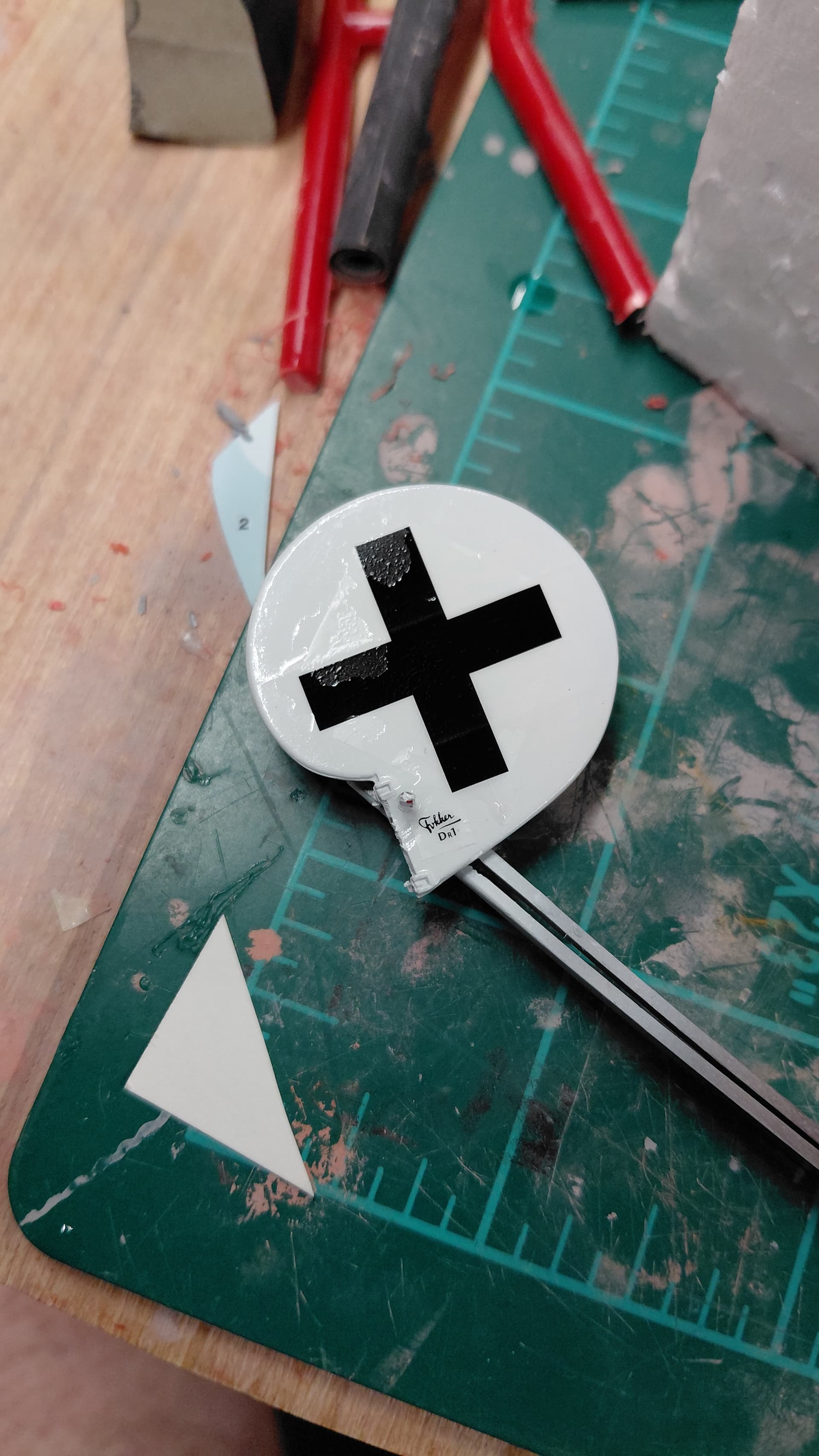

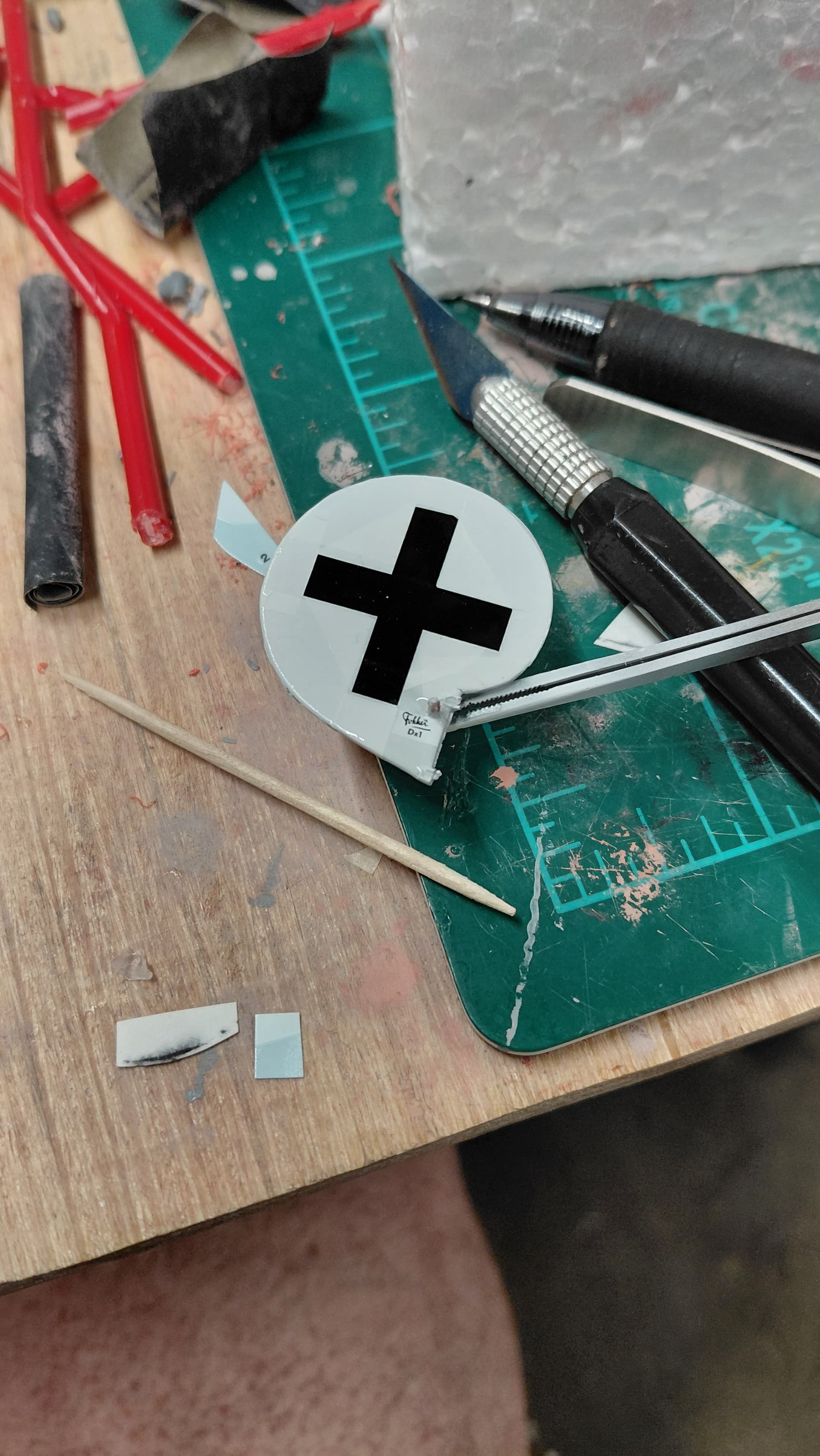

I painted the entire DR-1 with the 50/50 red enamel @ 16 Psi. The enamel went on smooth as glass
I had to paint the rudder silver first then shot the gloss white, the rudder decals were applied piecemeal because the cable stanchions would have to be threaded through the decals if not cut up.
