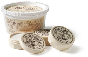

I dip the bristles about halfway into the lacquer and then wipe it a few times as though you were painting with it on a paper towel.
Repeat this process until no traces of the paint are showing.
I then use a product called, “The Master’s Brush Cleaner” which is a fantastic product that cleans and conditions the bristles. It is a block of soap similar to the old fashioned shaving cream soap, at least that’s what it reminds me of. [;)]
You wet the bristles in water, rub it around in the soap block and then rinse it in water. You can even leave the soap on the bristles, shape them back to a point and put the protective cover back on the brush.
It looks like this:
