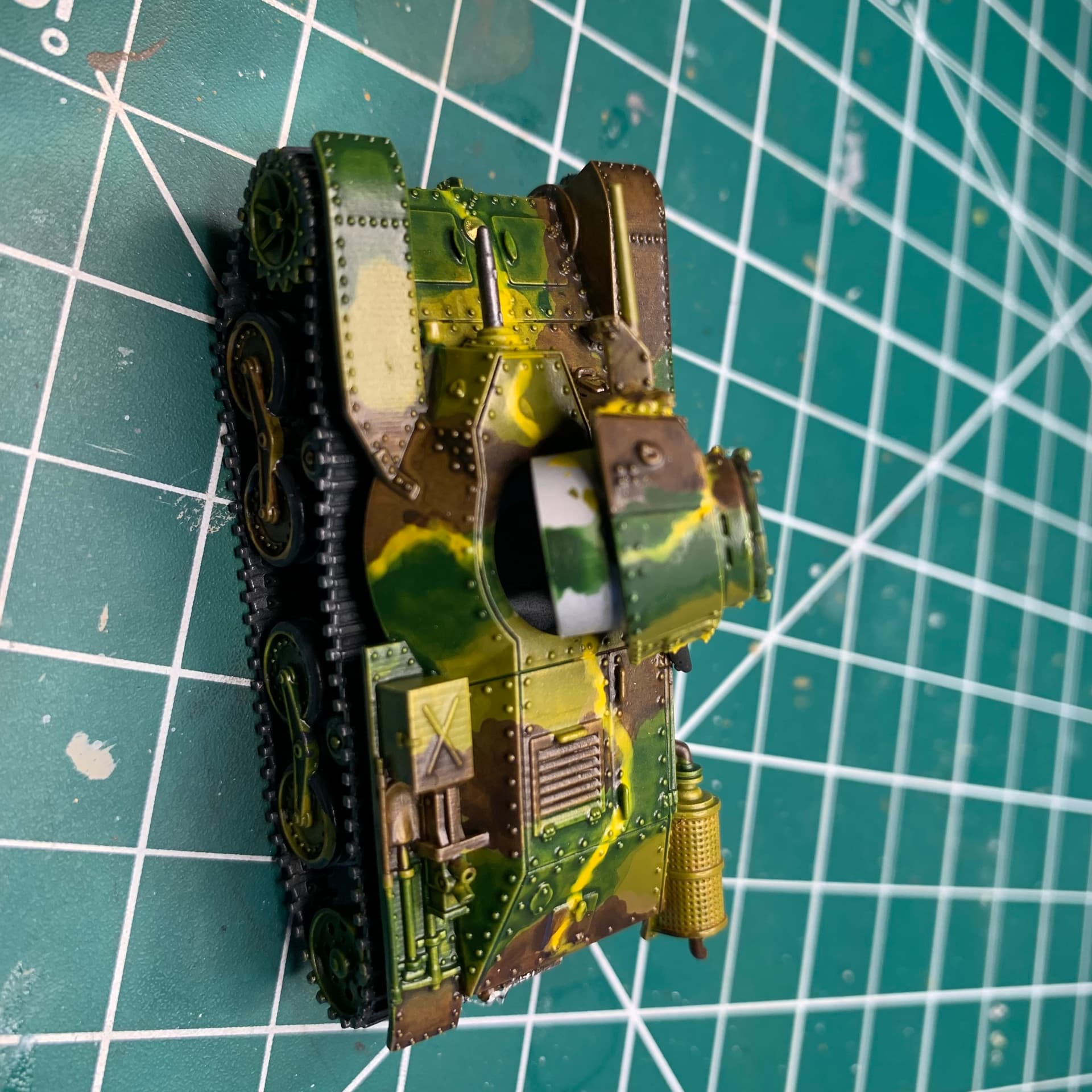

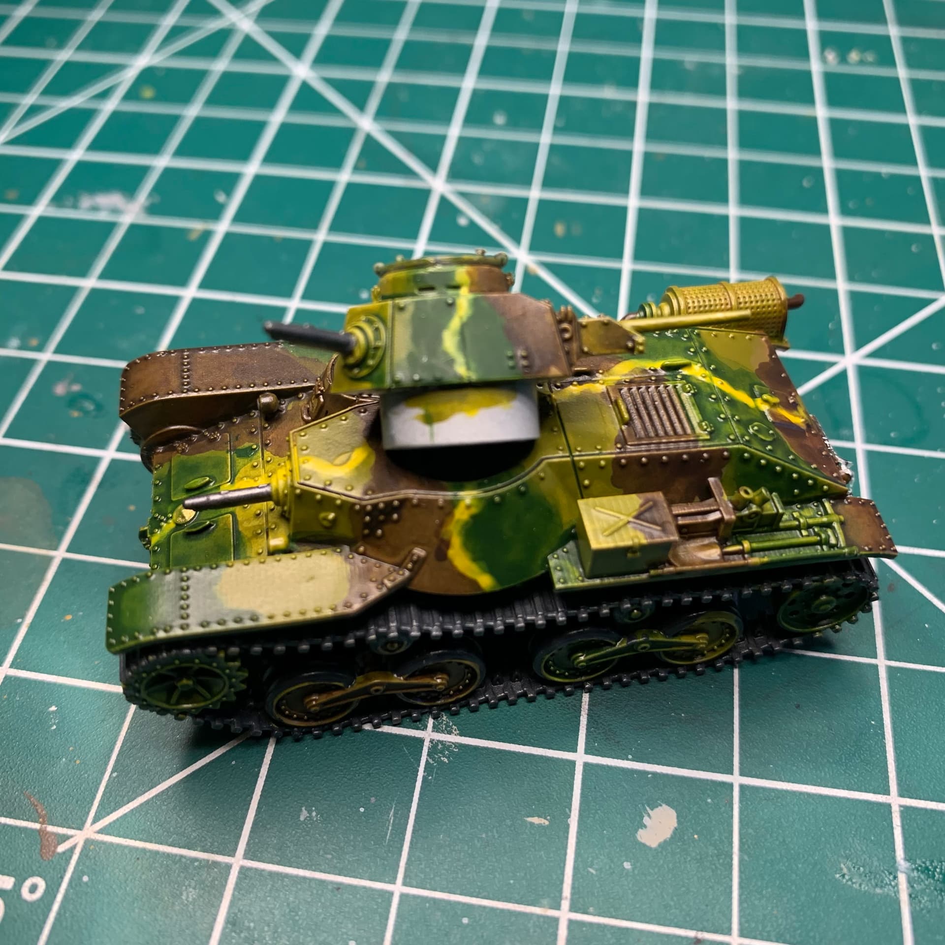

Here are the stripped bits (turret, both sides), now touched up and ready for another coat of gloss and different decals.
