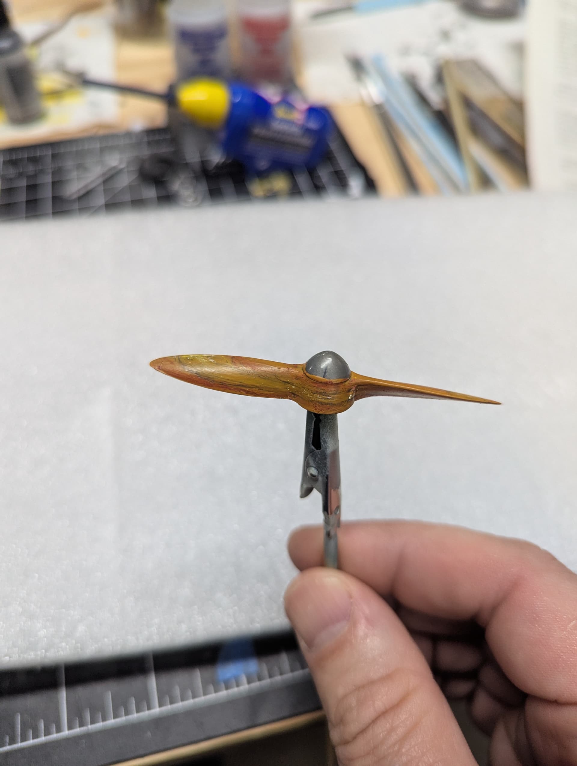

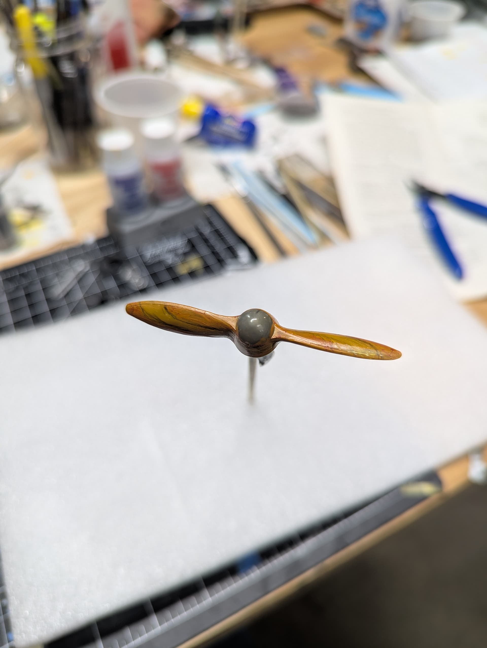

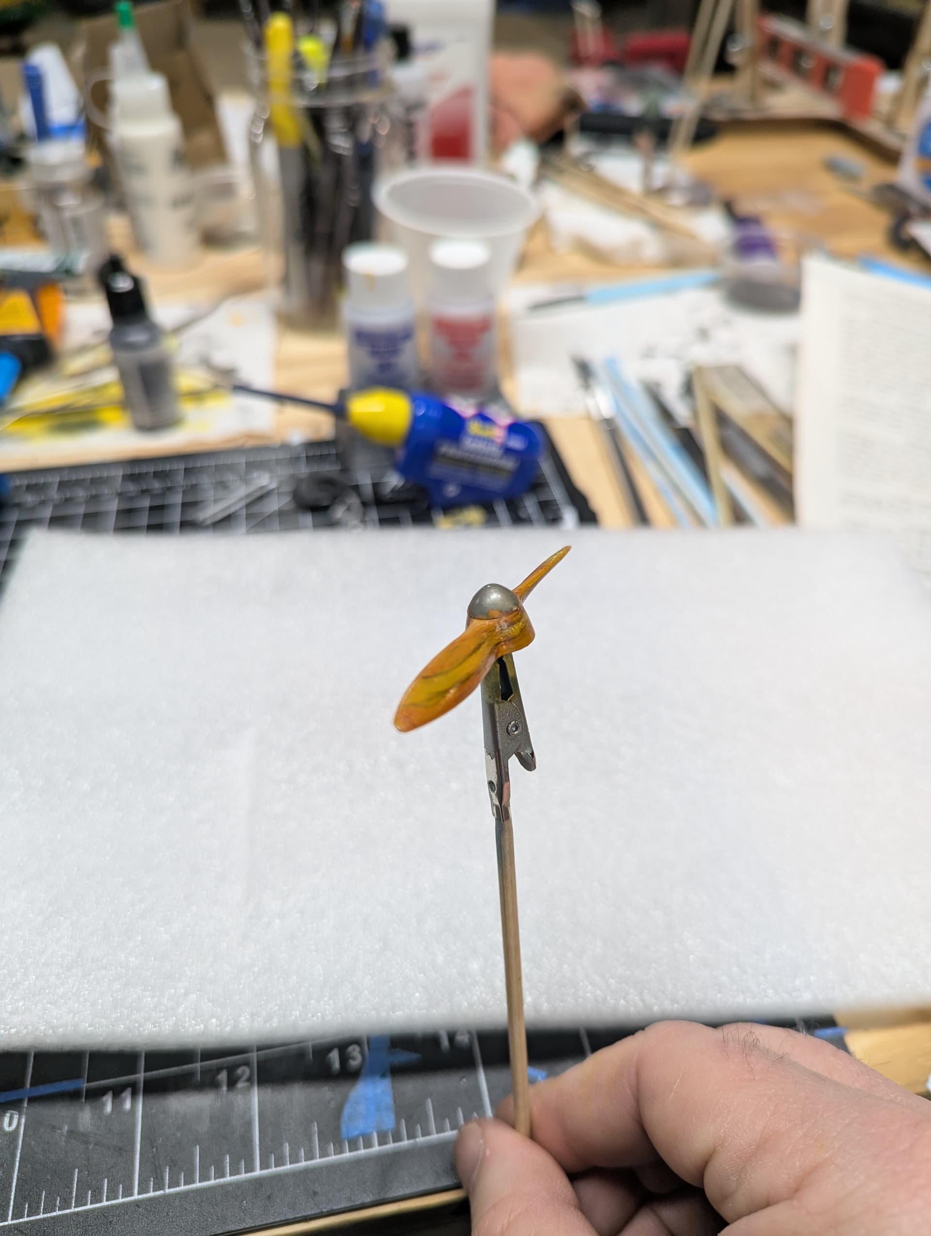

I followed a video on YouTube by scale-a-ton to create my prop. I didn’t show as many layers but I think it looks wood-like. Here’s the link to his video:
And here are a few pics of the prop for my Gloster Gladiator.
