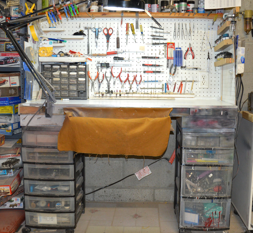

Here’s mine. A couple of hand me down nightstands and a piece of melamine for the top.
I did it much the same way.
The drawer units were on sale at my local office supply store. The top is a 2 x 4 foot sheet of particle board covered with contact paper (renewable/replaceable).

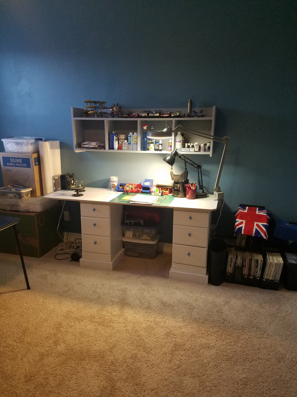

I started off with an old desk that I had gotten from work many years ago. On the left next to it is my home-made paintbooth and on the right is my parts boxes and paint drawers. Get a self healing pad to work on and a rack of some sort to keep your tools organized. Keep your bottle paints in a storage rack of some sort so you can see the colors you have. I keep my laptop on the desk for easy reference to Forums and websites for details I might want to add and for inspiration for what I am building.
I made my own desk also. Just some 1x4 for the legs and the bracket for the table top, plus a section of particle board for the table top was for the first one. Later one when I picked up an old countertop from work when we dismantled an old office, I used that with longer 1x4’s for the legs and brace to make a standing worktable that I use for building and the older table for the painting/airbrushing.

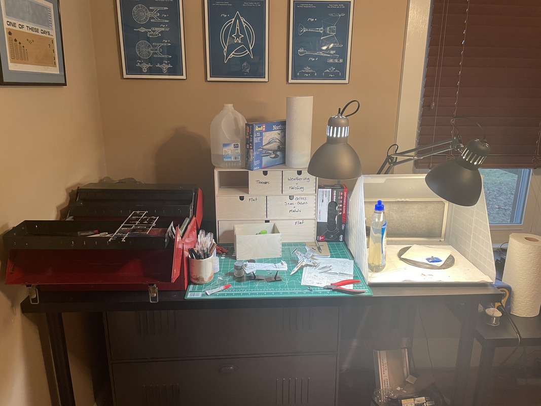

This is my “IKEA” setup:

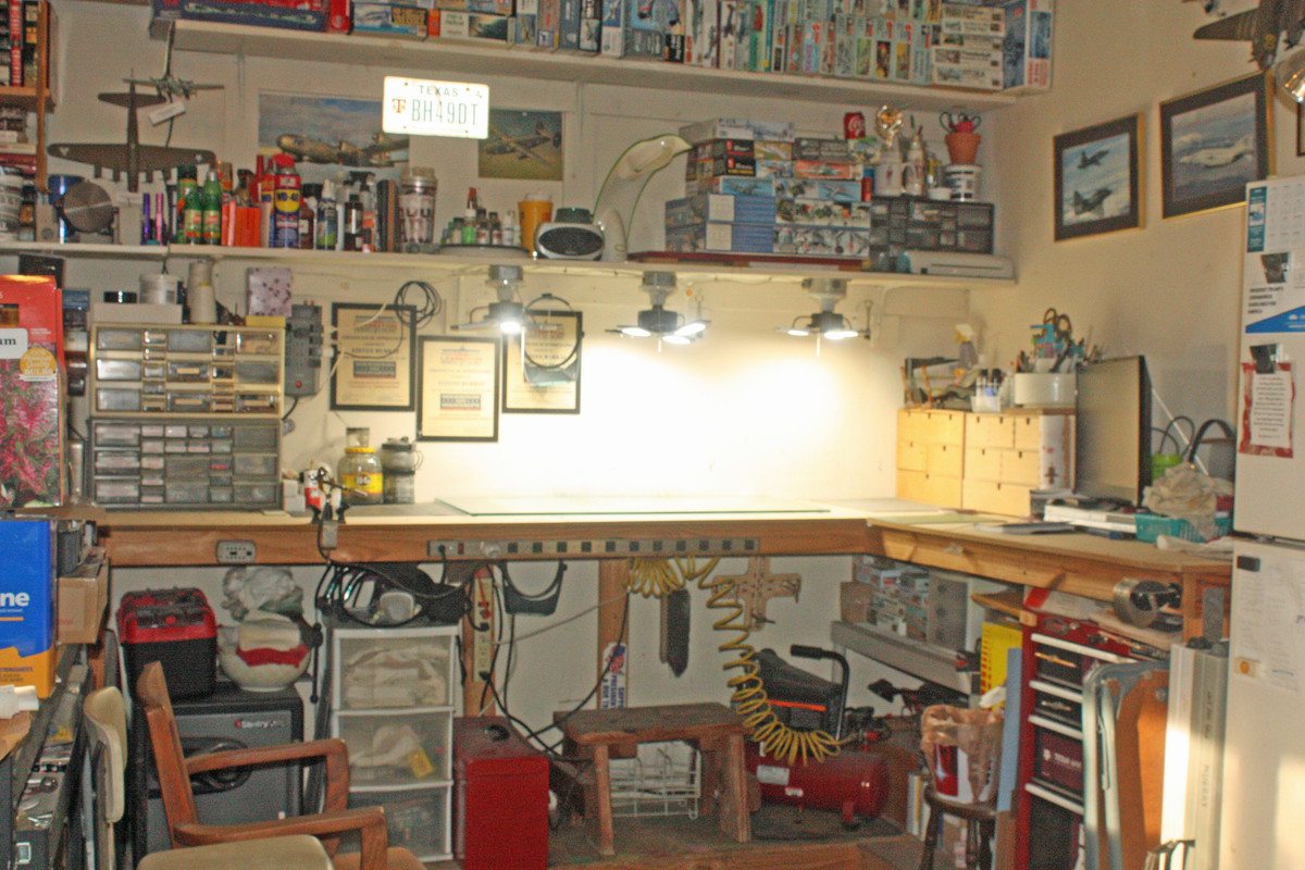

I recently re-did my work surface. I first built this bench about a decade ago in what would be a third bay in a corner of my garage. It is mounted directly to the wall. I built the underlying structure with 2x4s. The lower storage surface is 1/2" plywood; the upper surface is 1/2" MDF. It is sturdy enough that I can walk on it.
I have a couple of wooden tray bins where I keep things like mixing bottles, pipettes, clamps, and a couple of plastic tray bins where I keep the airbrushes I own as well as alligator clips, cotton balls, and other painting-related stuff. I have a 4-drawer Craftsman tool box where I keep all of my paint and glue, various modeling tools like knives, tweezers, or scissors, and other related stuff. I have a BluRay player and a small TV as well as an Amazon Alexa for entertainment while I’m working. There also are a couple of green self-healing mats and a section of glass (used to be a table top in an earlier house) to do various cutting tasks.
And the most important thing aside from the work surface itself are the three light fixtures that I mounted on the underside of a shelf directly over the primary work space.
Honestly, light is the biggest thing really. It’s the most indispensable tool you can have at a workstation.
