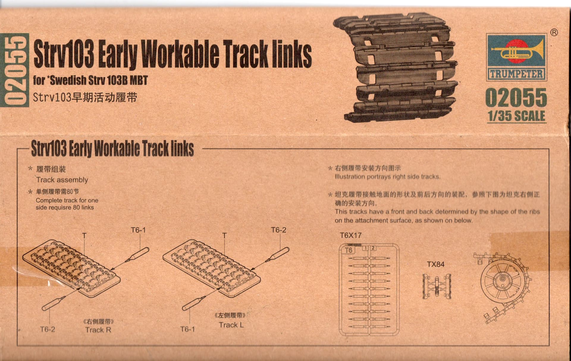

I’m building Trumpeter’s 1/35th Strv 103 model using Trumpeter’s early workable track links. The instructions show Track R & Track L using the T6-1 & T6-2 pins on opposite side of the tracks. The T6-1 & T6-2 pins look the same. Please help me.

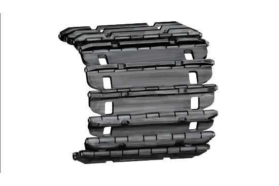

Far be it from me to give a fully definitive answer, especially since I can’t actually look at the parts. I make no expert claim, but when I see a larger / clearer picture of said tracks it looks like they have different head shapes for each side.
I’m guessing one is represents the rounded head and the other one represents the securing nut. How much of this is actually noticeable on the finished tracks is a question I can’t answer. Under paint and weathering etc there may be no difference.
It would also depend on how accurate you are with trimming the pieces, glue application and what not.
Frozin Regular, Sorry that it took a while get back to you. Thank you, it helped me to search further and I found a great picture on the Kubinka Tank Museum site. I was able to enlarge enough to see the treads and see the pins. The round head pin goes on the outboard side of the tread and the nut goes on inboard side of the tread. So the poor mechanic has to crawl under the tank to remove the nut. So, instructions have the Track R and Track L labels reversed. Thank you again for your help. Keeep on Modeling!!!
